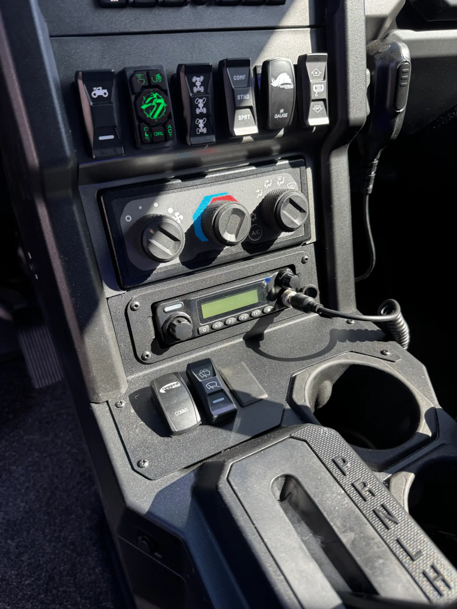

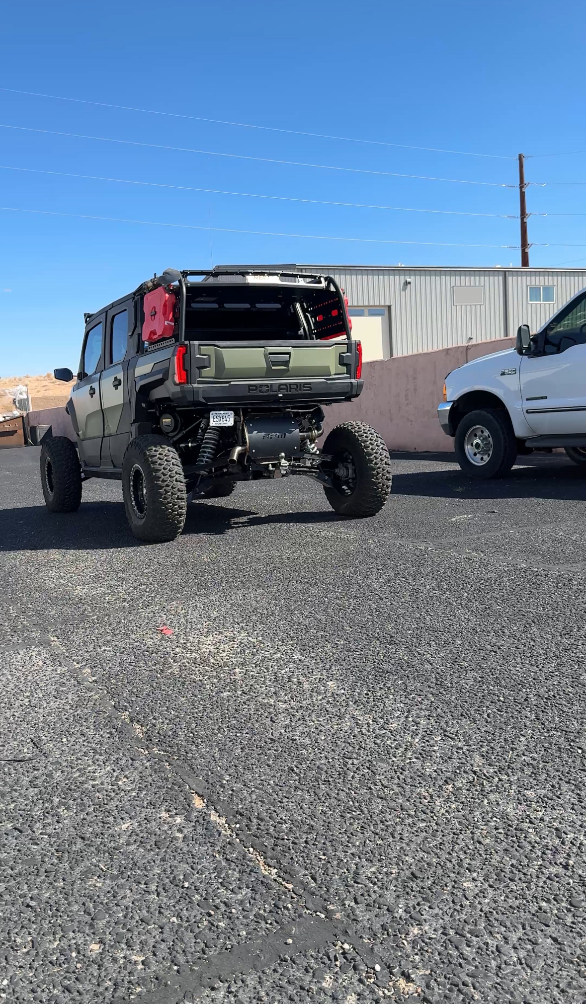

I haven’t done any builds with the Graphite models, but have done it with the Moss Green. And it’s definitely the most extensive build I’ve done so far.
IMG_9291.webpIMG_9290.webpIMG_9289.webpIMG_9288.webpIMG_9287.webpIMG_9283.webpIMG_9282.webp
The build list:
HCR Mid Travel
Eibach Springs
Demon Powersports Axles
Sandcraft full Driveshaft replacement
Packard Performance Wheels
Maxxis 32/10R15 RAZR XT tires
Aftermarket Assassins Clutch Kit
EVO ECU Tune w/Codeshooter Unlock
EVO Turbo Kit
Razorback Technologies Belt Temp Gauge
Sector Seven Prizm Lighted Mirrors
Dirty Teeth Racing Remote Start and Security System
Ryco Moto Turn Signal Kit
Rugged Radios Xpedition M1 Radio kit
Razorback Off-road XP Bed Rack
RPM Exhaust
RPM Belt Cooling Fan
RPM Intake Boot Replacement Kit
SSS Off-road UHMW Rock Sliders
Polaris HD Front Bumper
Polaris 6000# Winch Upgrade
Rigid SR-M Driving Lights w/Amber Lens Caps
Rigid 50” Curved Light Bar
Custom Cut Stainless Steel Grill Replacement
Rotopax Gas Cans and Mounts.
Milwaukee Packout Plates mounted in the bed and on the RBO Rack Tray
AJK Front Fender Liners
I think that’s everything 😂
