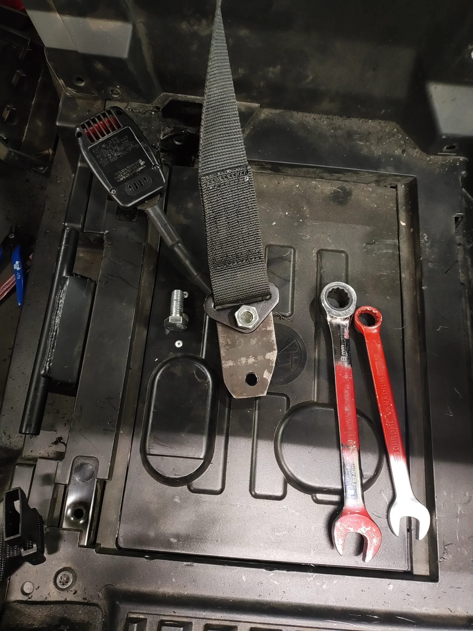

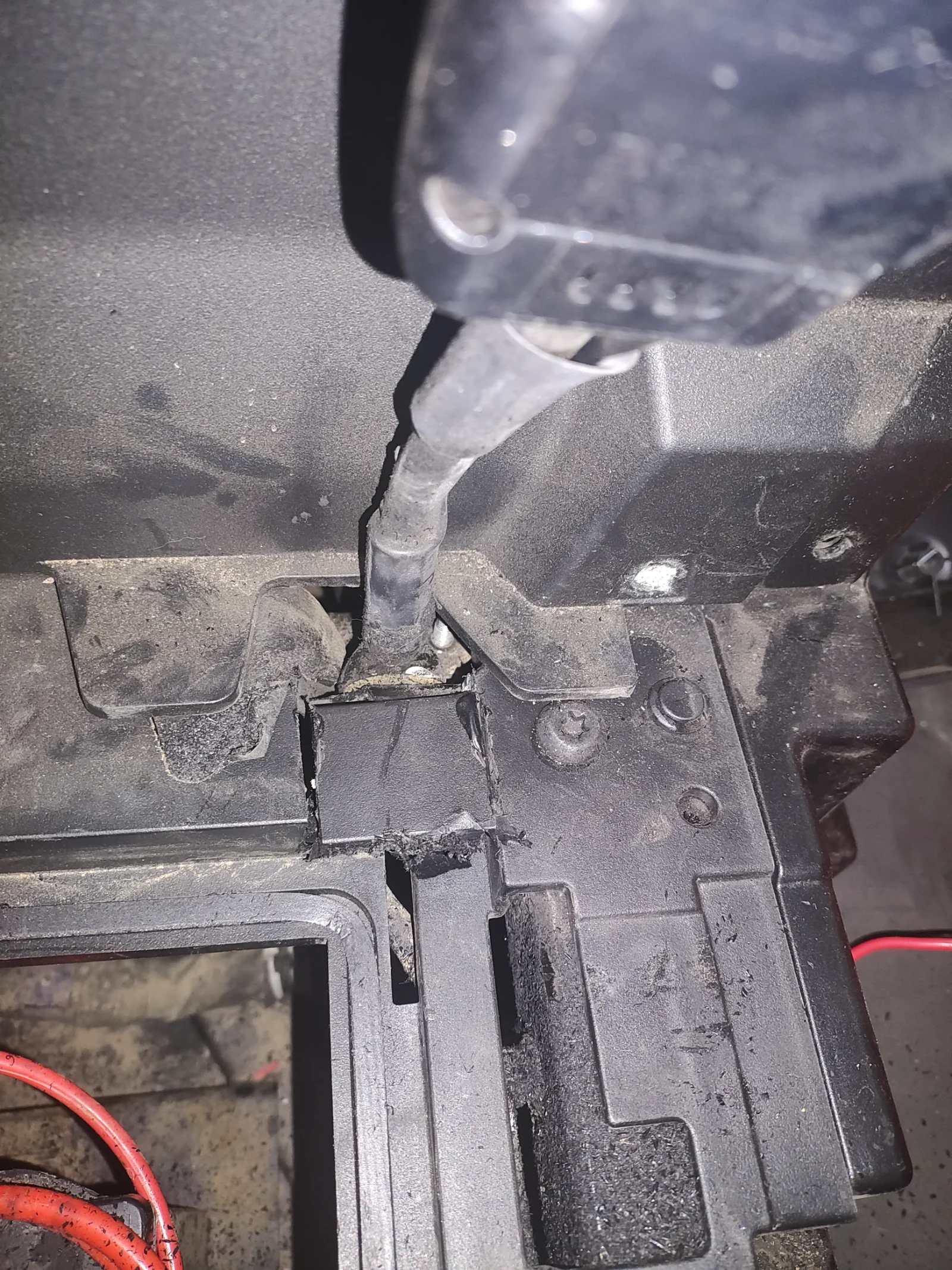

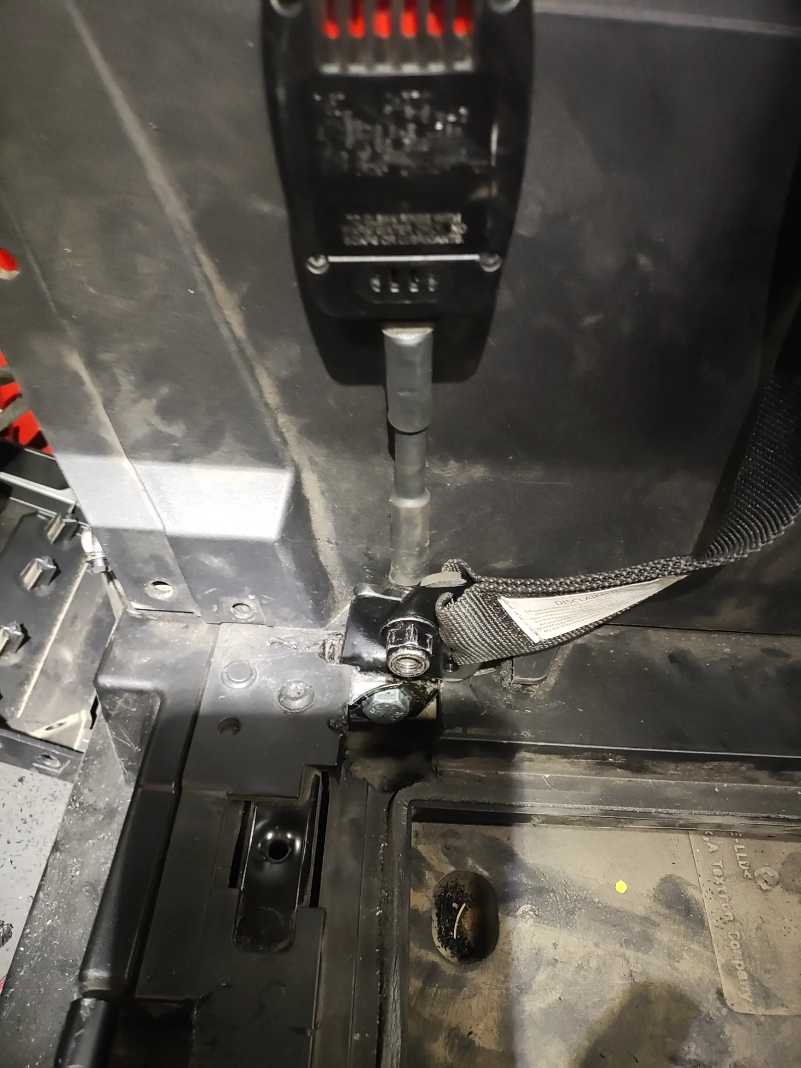

Added DragonFire 4 point harnesses to my XP5. I saw a post where somebody left the stock harnesses as well so that's what I did. I couldn't get to the bolts to remove the stock buckle so I cut access holes in the floor board. I then found that the harness wouldn't bolt to the stock location because of its size. So I built brackets to extend upwards 2". This also took care of the issue of not being able to buckle the stock belt due to my 2" seat risers.

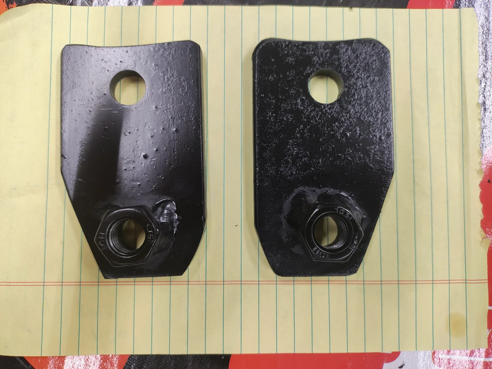

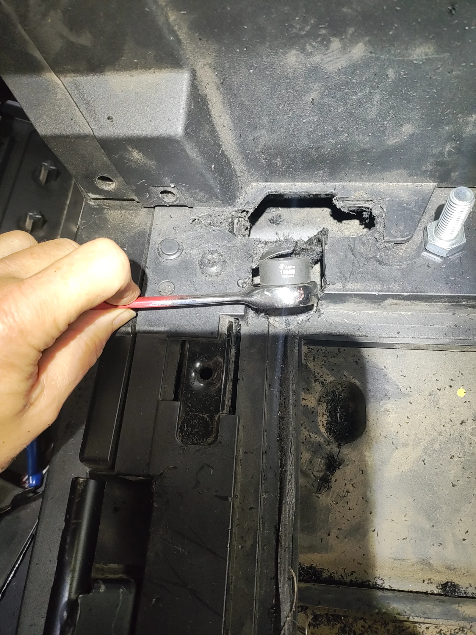

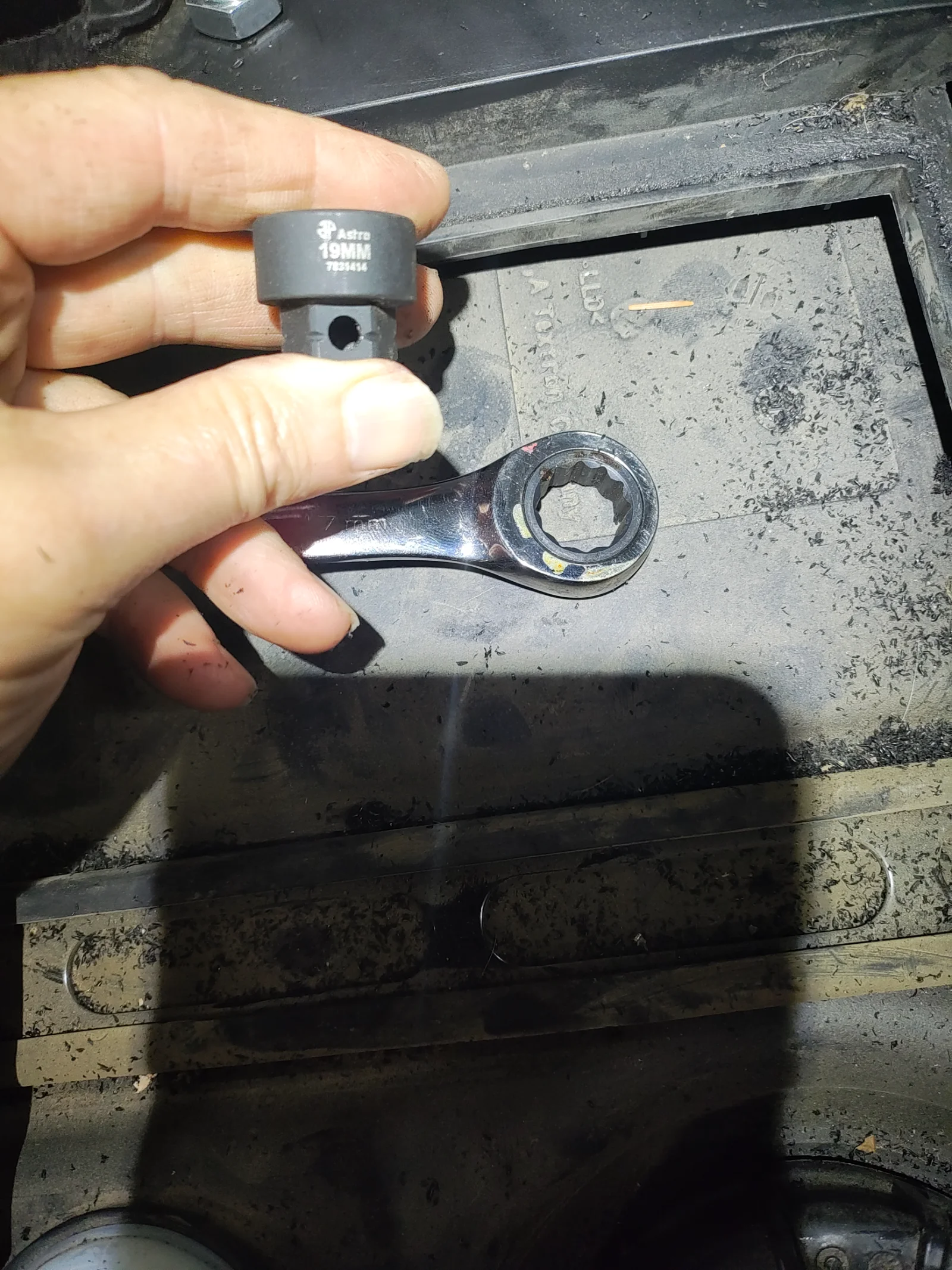

I ended up welding the nuts to the back of the brackets and I had to use the combination of a ratcheting box end wrench and an Astro low profile nano socket to tighten the bolts up.

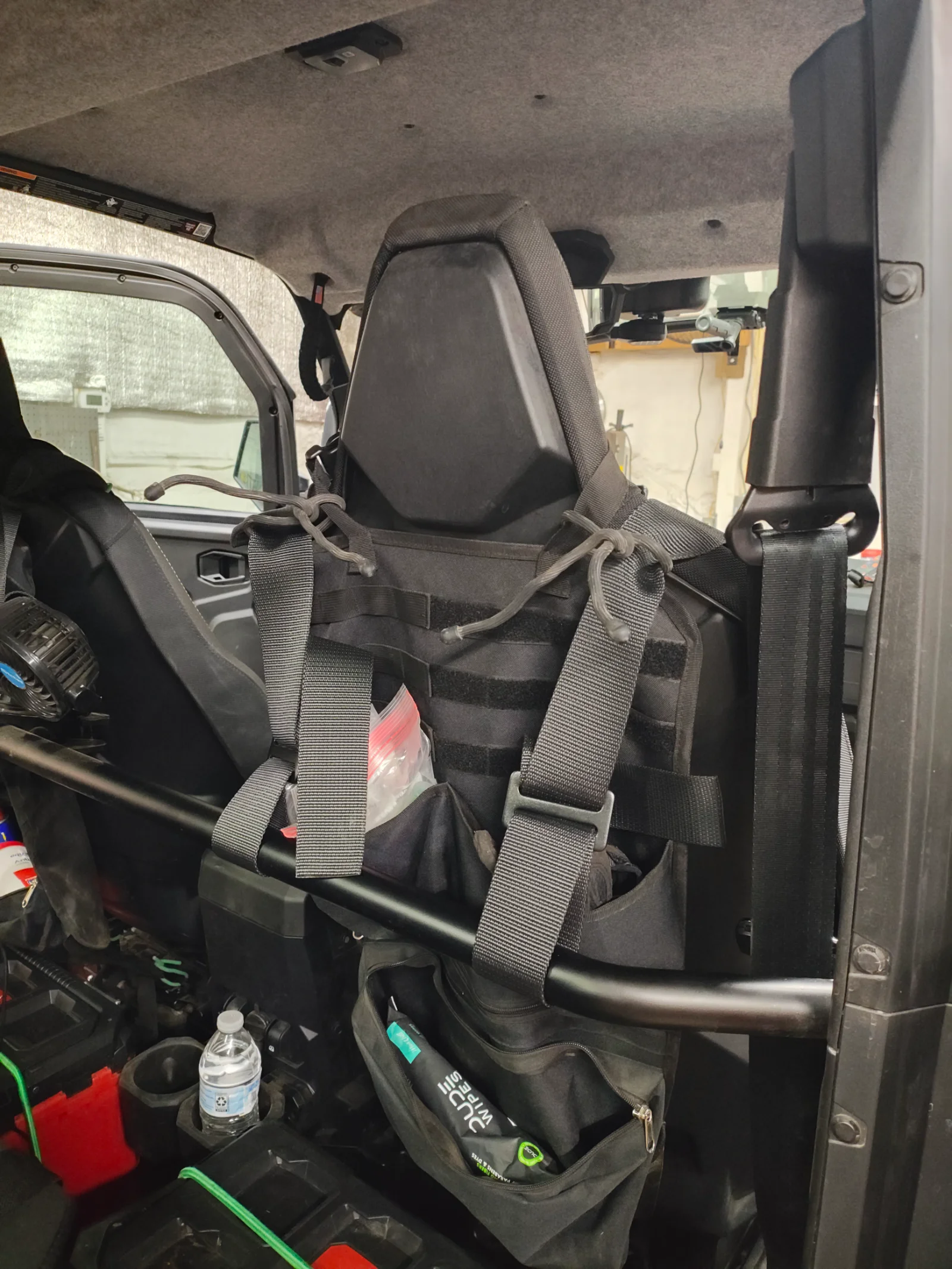

The shoulder harness want to fall off the corners of the seat so for now I tied them up with Gear Ties. I might look into seats with holes for the harnesses but I am afraid the belts will poke us in the back when using the stock harnesses.
After gettting it all put together I cut some pieces of Siless foam and covered up the holes where air and dirt could come into the cab.
