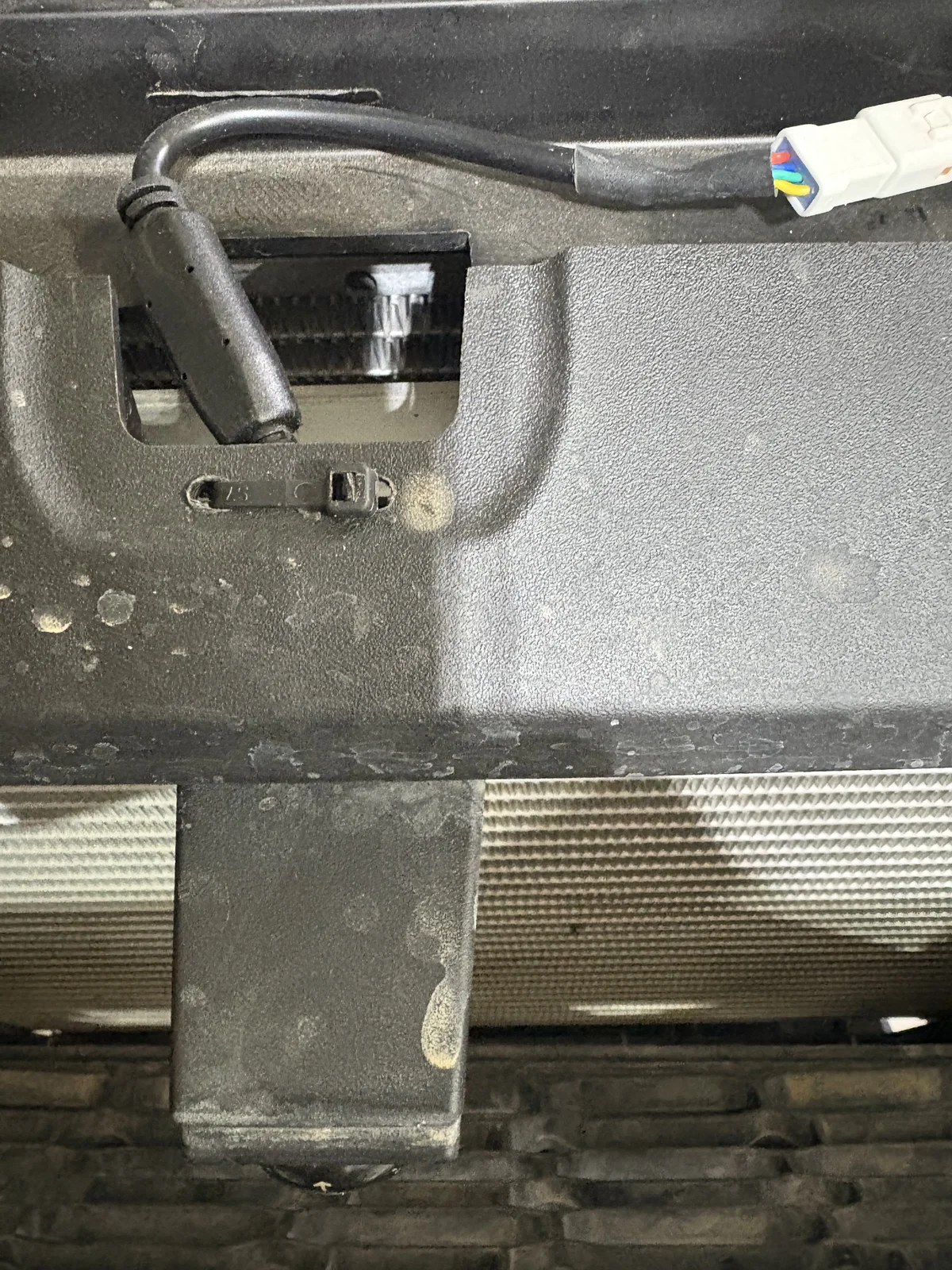

When I went to look for the corresponding wiring harness where it would plug in it’s literally zip tied down with a rubber plug cap right above when the camera plugs in.

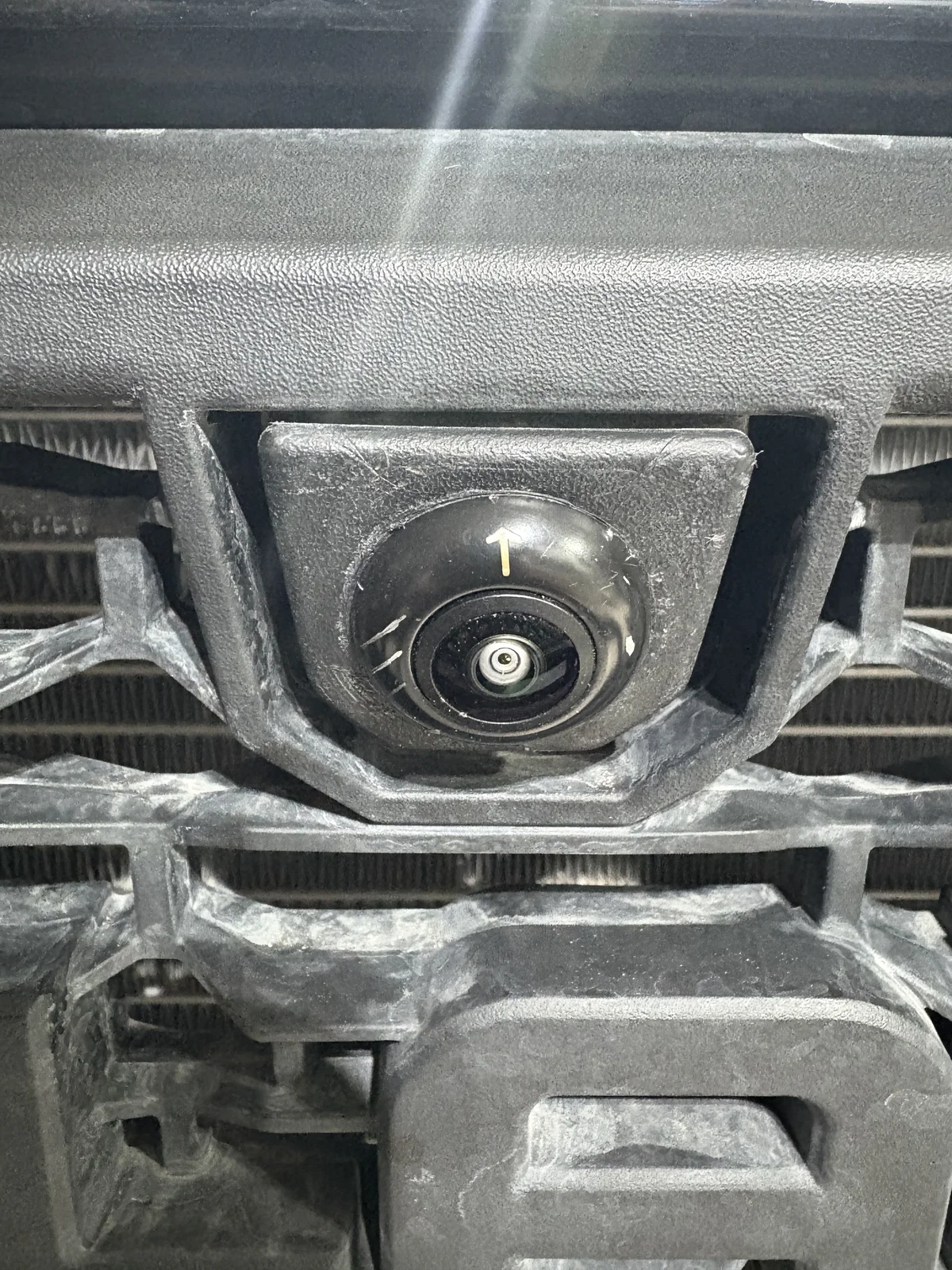

Sooooo…I got the camera installed.
Short story long, the spinning lock ring on the Kenimoto camera significantly complicates the install as compared to the Polaris/OEM camera which uses 2 locking tabs to keep it in place.
Specifically the backside of the camera where the locking ring is supposed to secure the camera to the backside/inside of the camera mounting area is extremely tight…like ridiculously tight (space wise)…like un-possibly tight!
Unless you have action figure size hands, good luck getting the locking ring tightened to the point where the camera doesn’t spin/move. After wrestling with it for an obscene amount of time (compared to what it would have taken to install the OEM front camera), and chewing up the camera bezel in the process trying to prevent it from moving when tightening the ring down, I came up with a method to keep tension of the camera to prevent it from shifting. This was after I had gotten it as tight as I possibly could, but that still left enough room for the camera body to move.
I drilled 2 holes on either side of the camera cable, pulled the cable tight enough to provide constant tension on the camera mounting face against the bracket and zip tied it down.
The 3+ hour, almost 50-mile ride yesterday was enough to demonstrate two things; (1) the front camera for our riding environment/style is absolutely required and (2) it performed exactly as expected…
It didn’t move, at all, and the picture quality is comparable to the rear OEM camera but I would say it’s slightly lower quality, but not by much without knowing the exact specifications.
Bad news is if I ever need to remove the camera because it stopped working, etc., it’s gonna be a show and I’d likely have to cut a portion of the sides off the mounting arm/bracket to get more wiggle room. For a minute while doing the install and before coming up with the zip tie idea I thought I was going to have removal the entire fascia that houses the camera mounting bracket to get a better angle on the locking ring.
Did I COMPLETELY overlook an easier method of instruction or installed it incorrectly? Possible but not likely; instructions are not included and it’s pretty straightforward not to mention there’s really only one way to install it…it just ain’t that simple.
Biggest win was spending less than $60 on something that Polaris wants $200 for…I’ll wrestle with a not so straightforward install to save $140 any day! I’m retired and have nothing but time…
