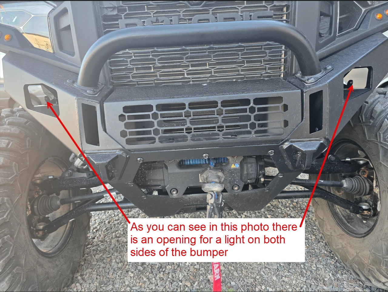

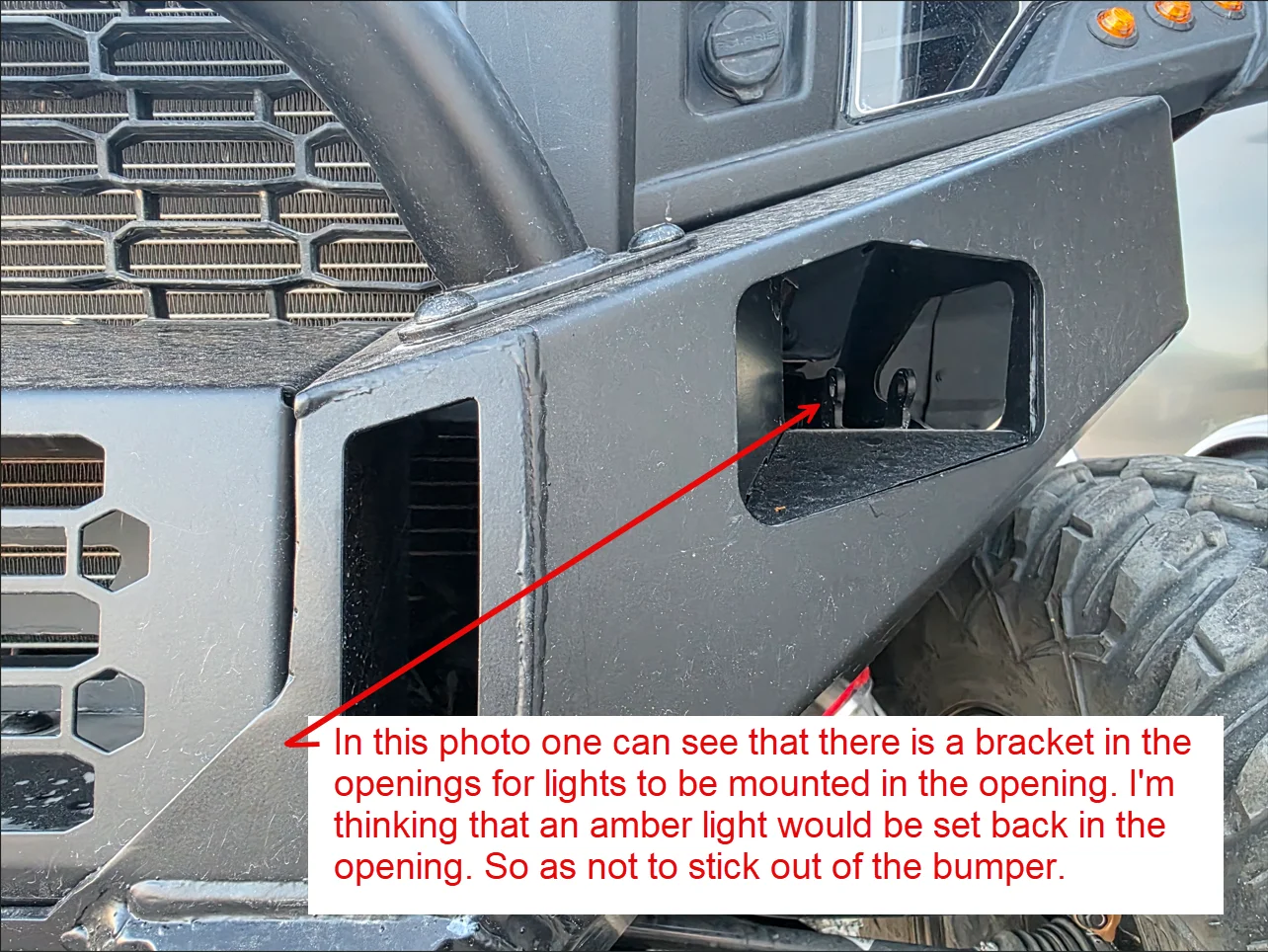

So I purchased the Polaris HD front bumper for my 2026 Xpedition ADV Northstar.
In this photo one can see the two openings for lights.
Anyone found a light that fits here? All the Polaris light kits are designed for use on the stock bumper, not the HD bumper.
Any help finding an amber light that fits inside the bumper would be very much appreciated.

Rigid light kit p/n 2889731 is the kit that works with this bumper. There are two harnesses in the kit,one for mounting the lights in the knockouts in front of the grill and the other for the HD bumper.
Was just looking at this the other day as I came across the plug behind the bumper. I have the HD bumper so I'm guessing the mounting bracket is only needed for the stock bumper? Just wondering cause I'm cheap and prob won't buy it anyway 😁

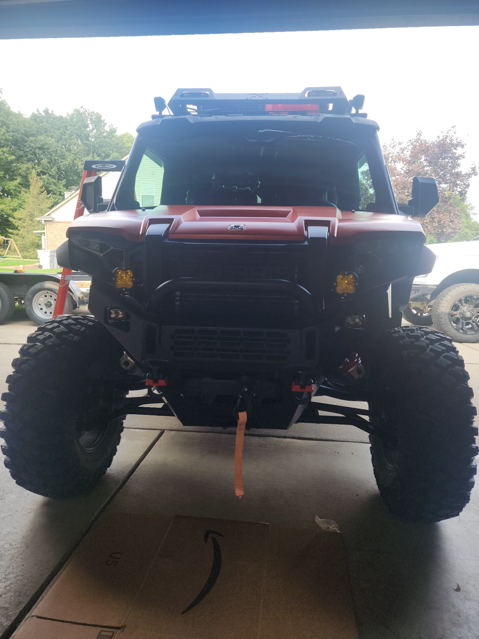

The Rigid's fit perfect, I purchased the lights separate i did not by the kit from Polaris. Searched the web for the best deal.

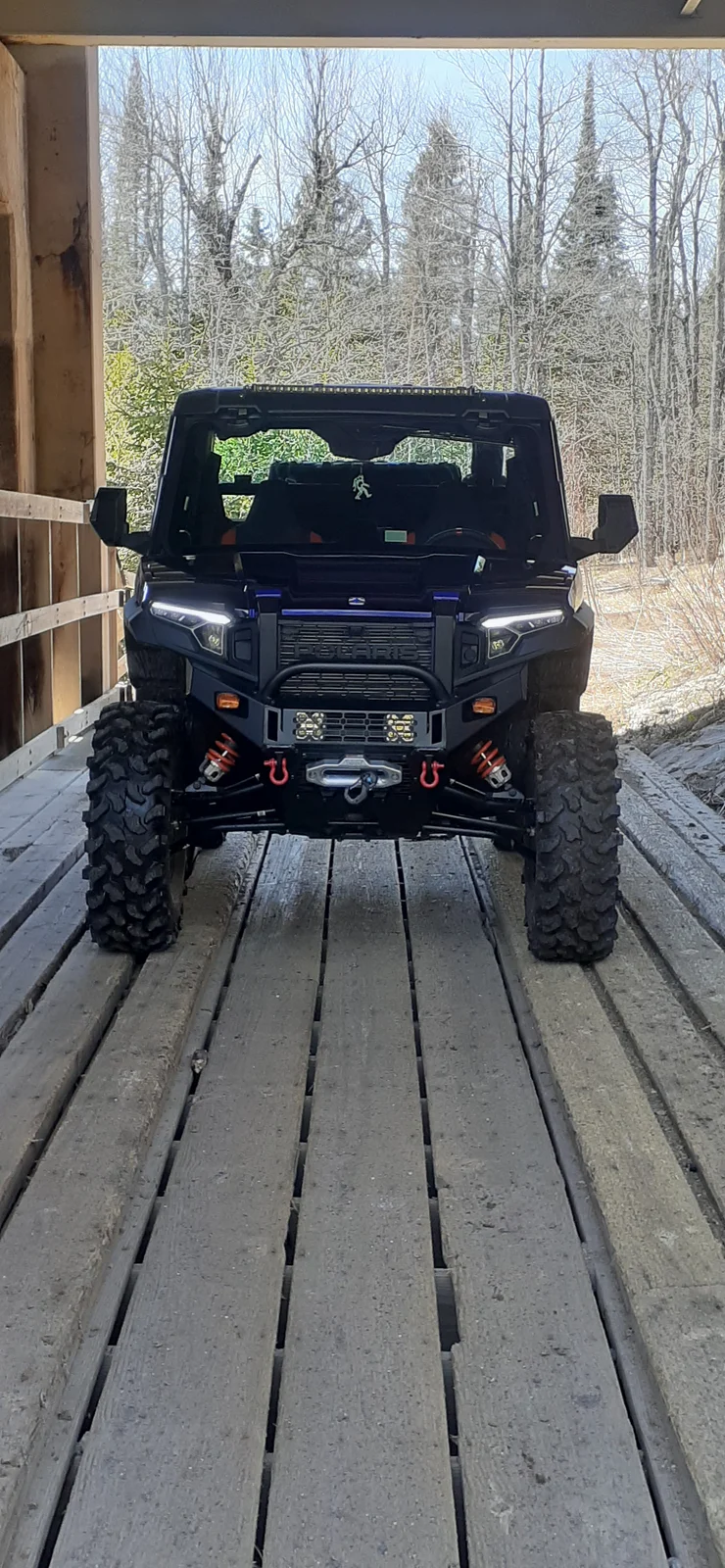

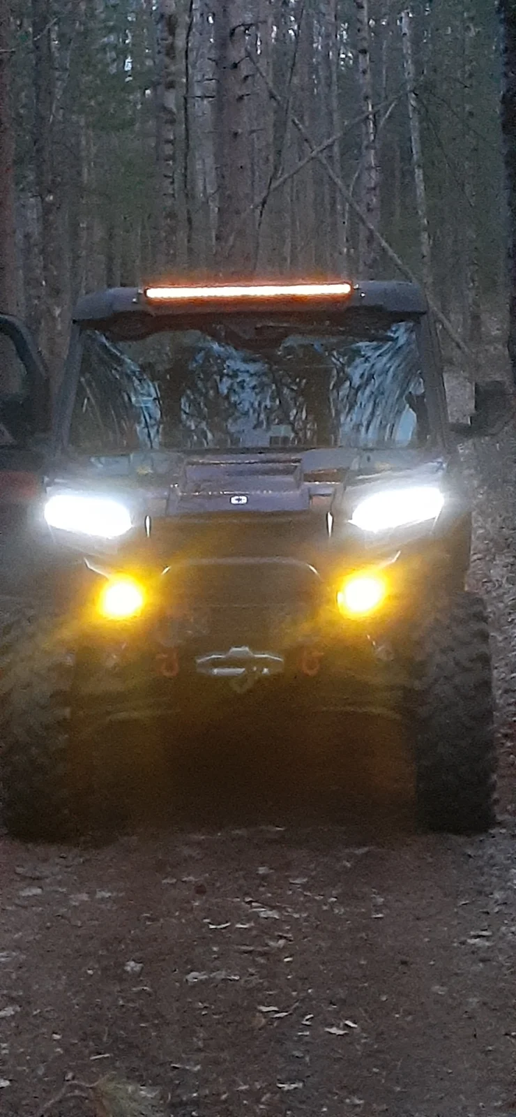

You can also buy the bracket to mount lights in-between the bull bar and the bumper. I put Aux Beam amber lights.. see picture.
That could be a cheaper way to go.
