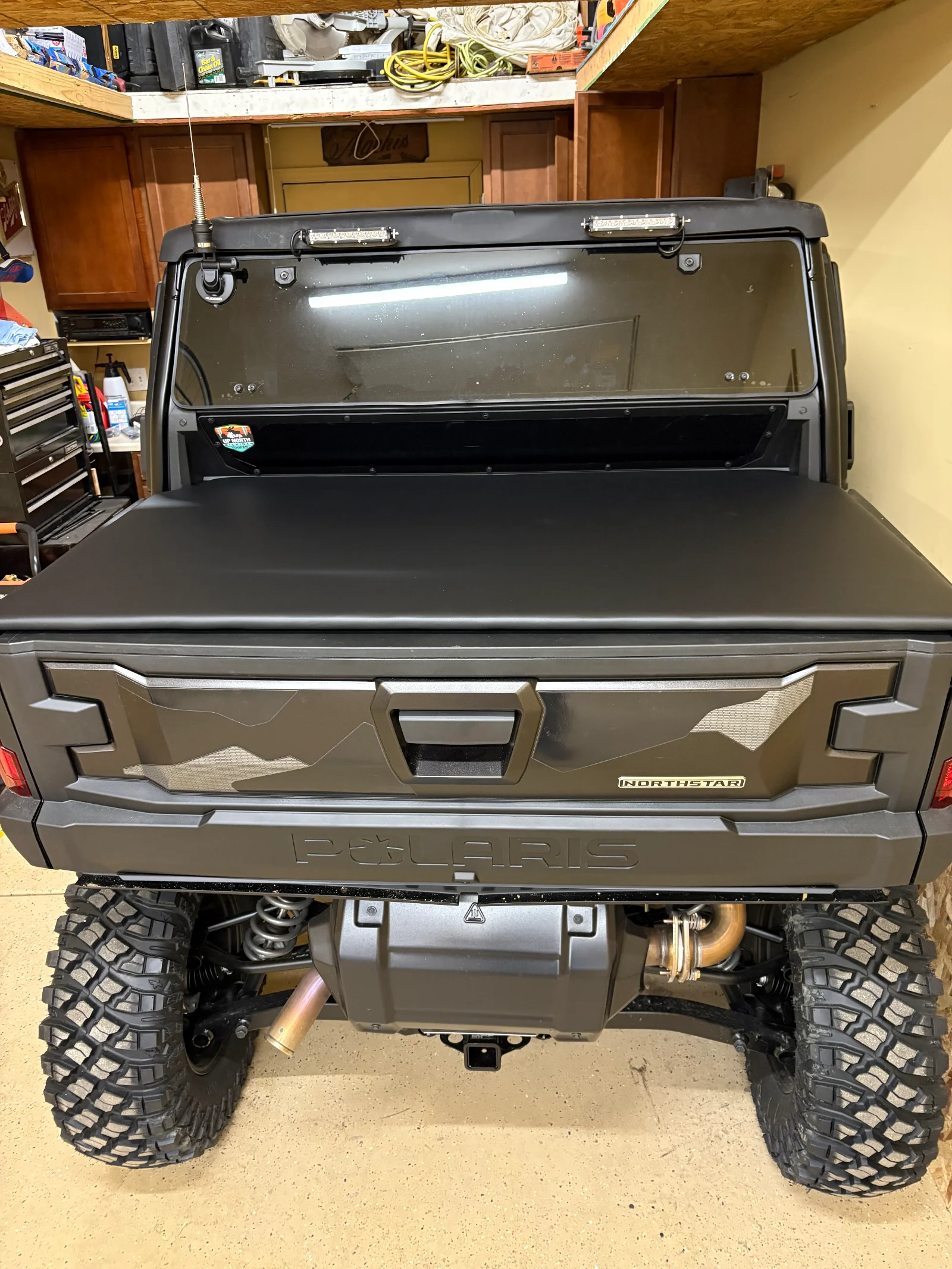

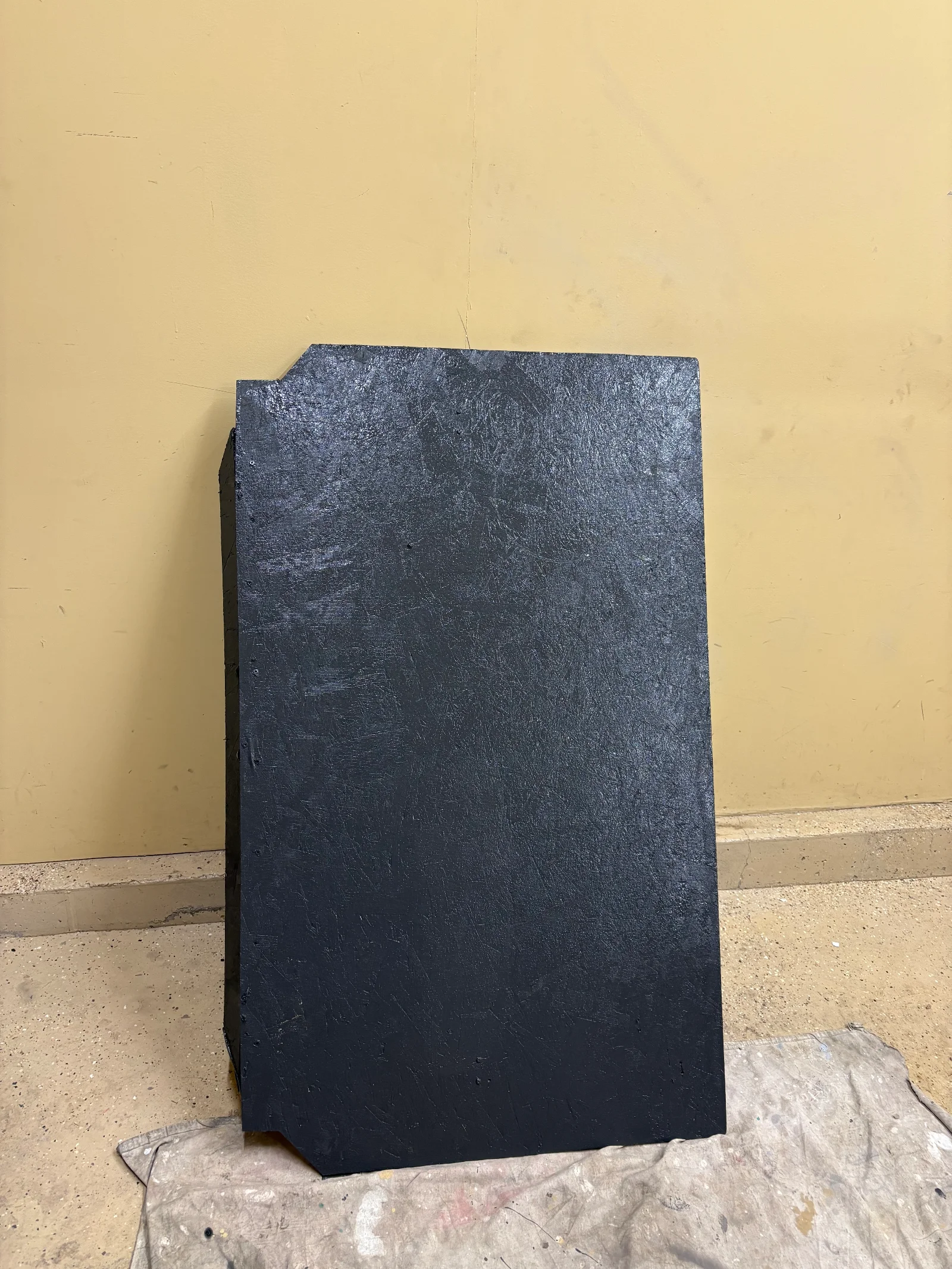

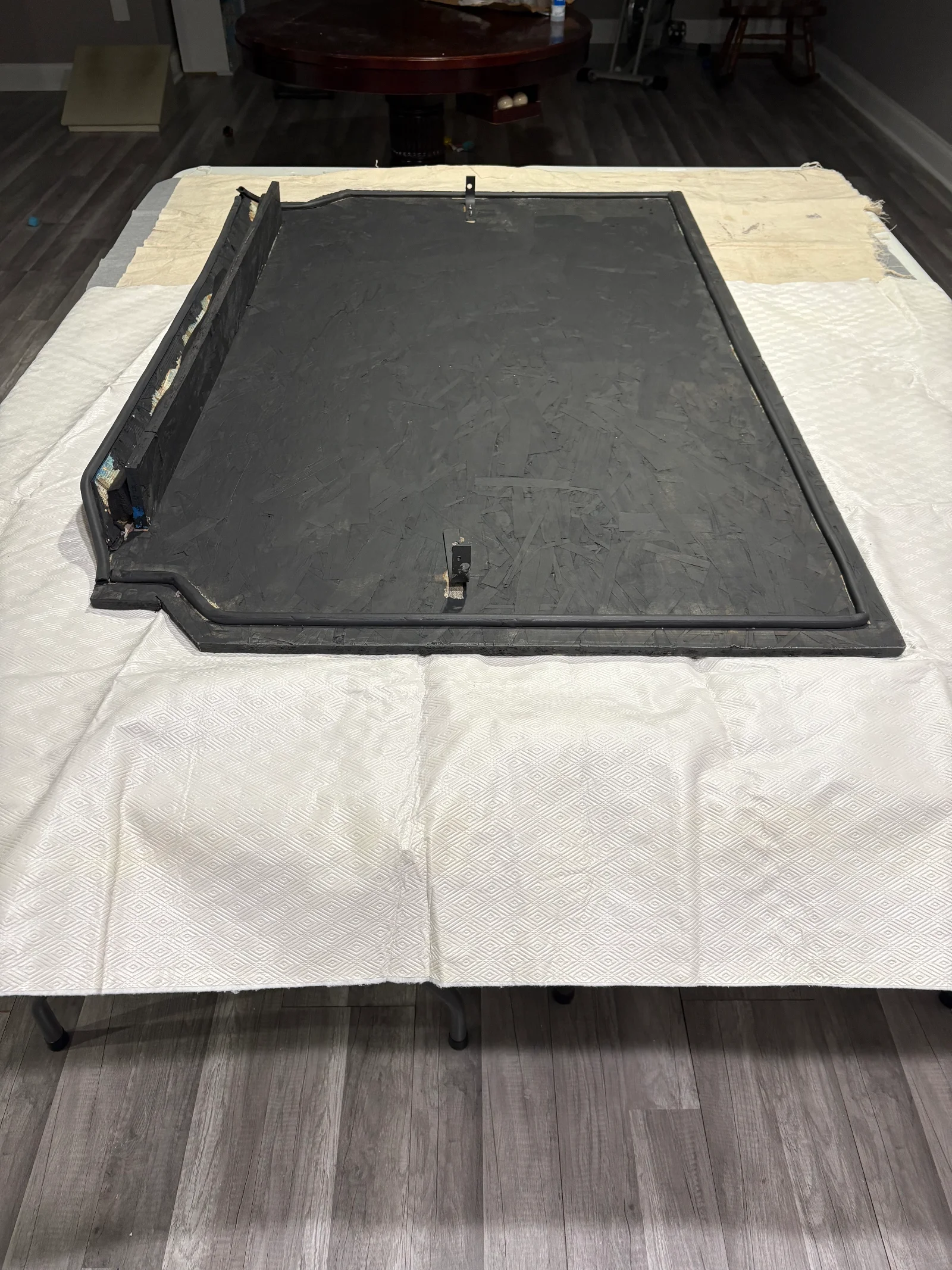

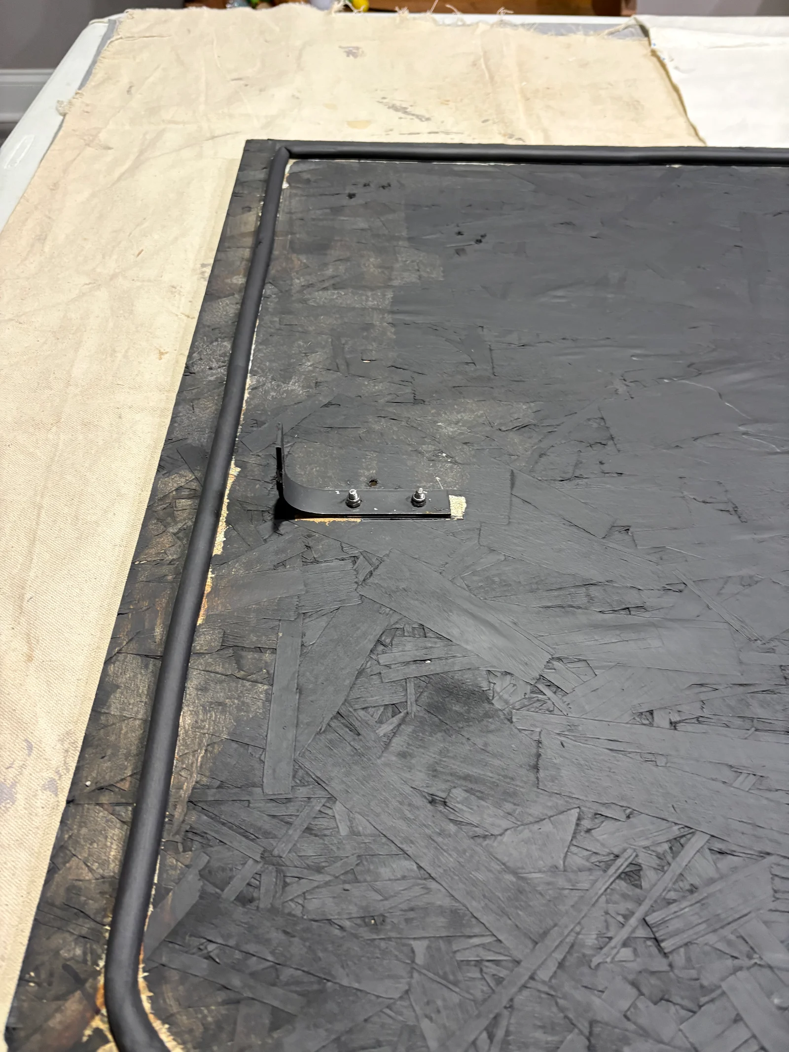

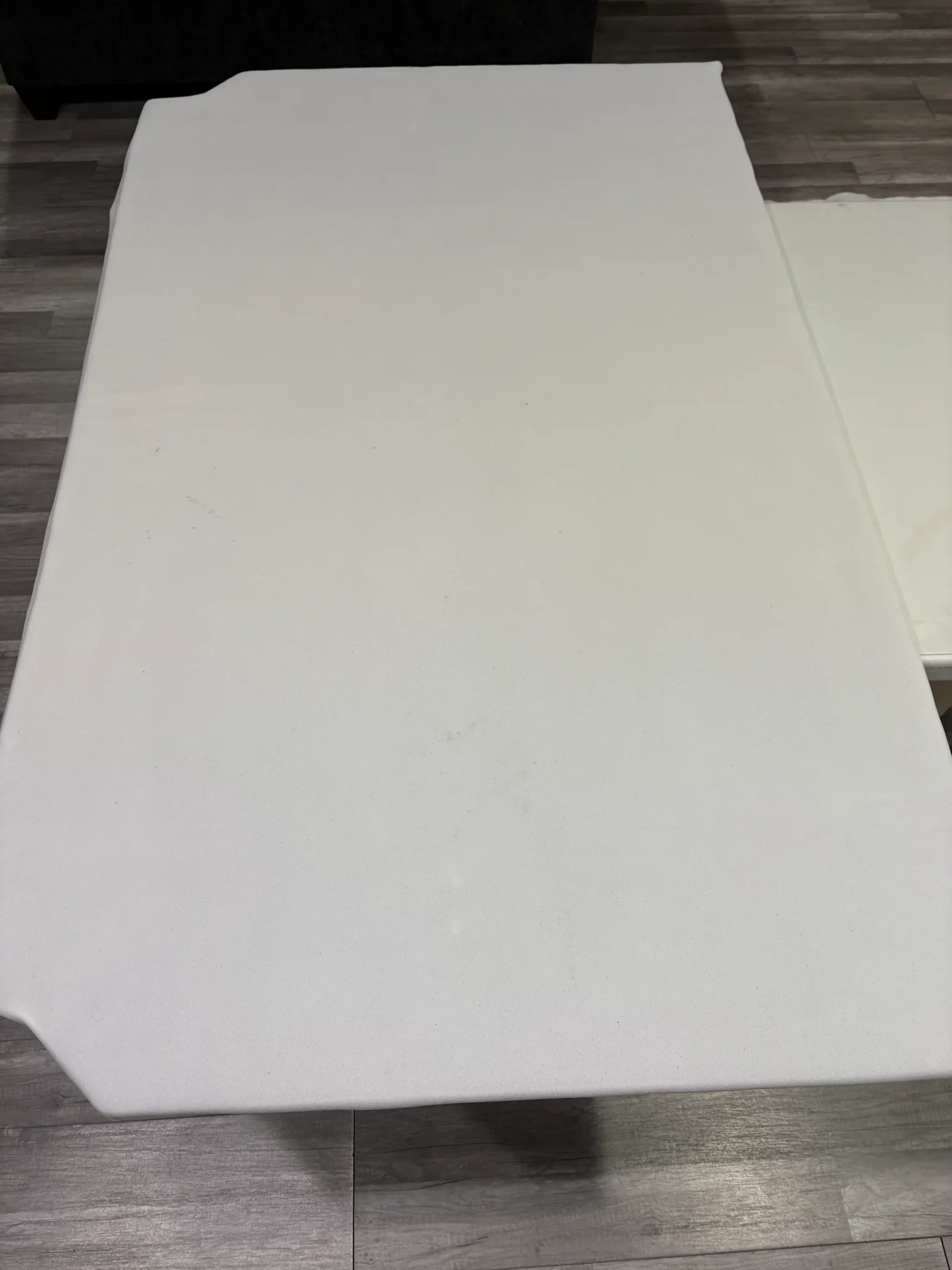

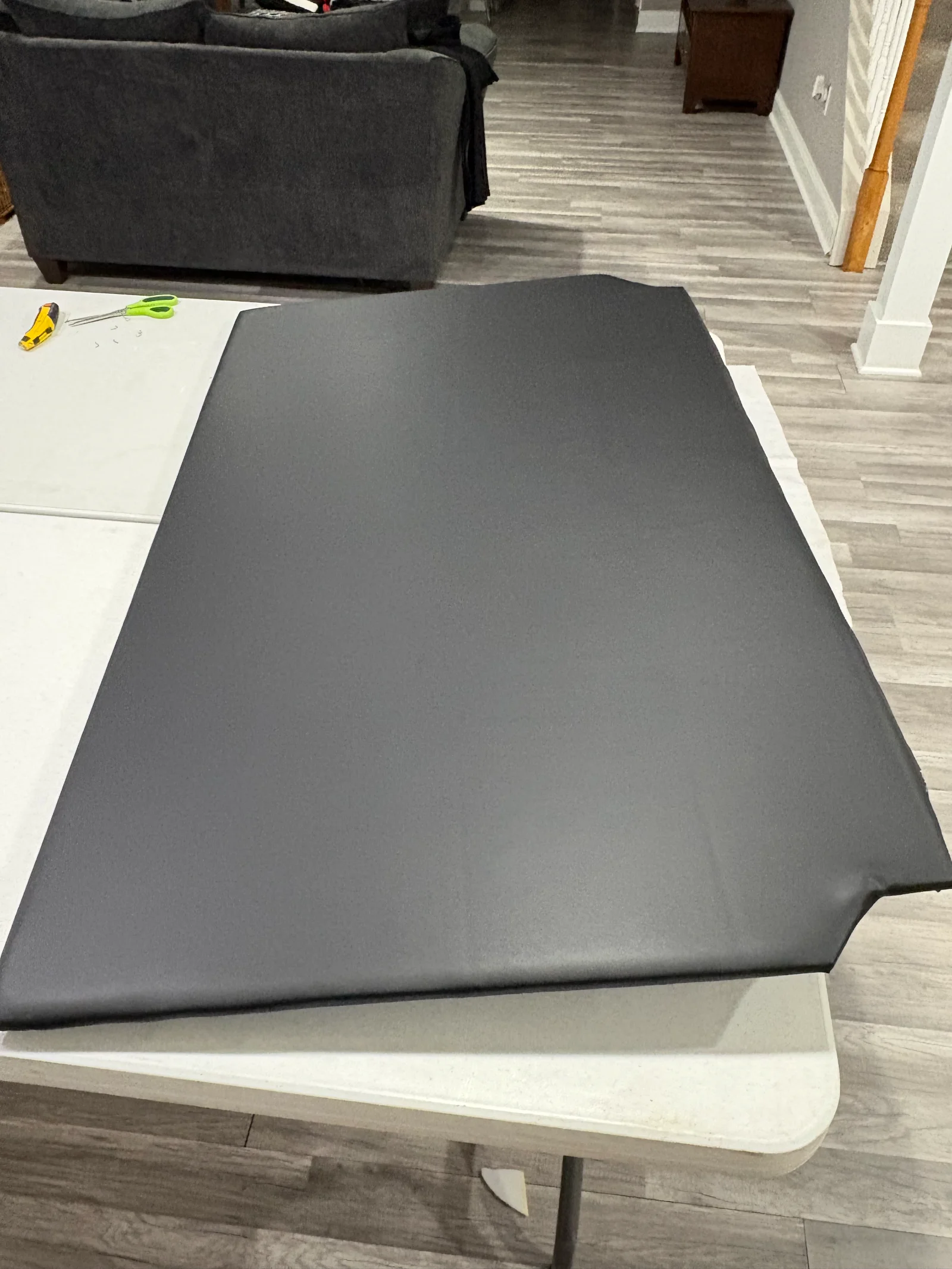

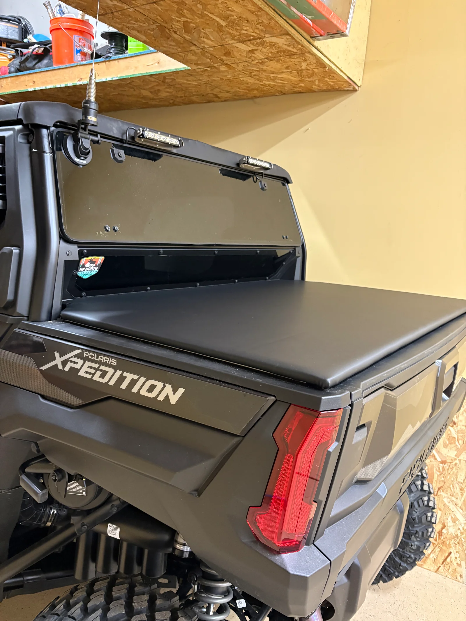

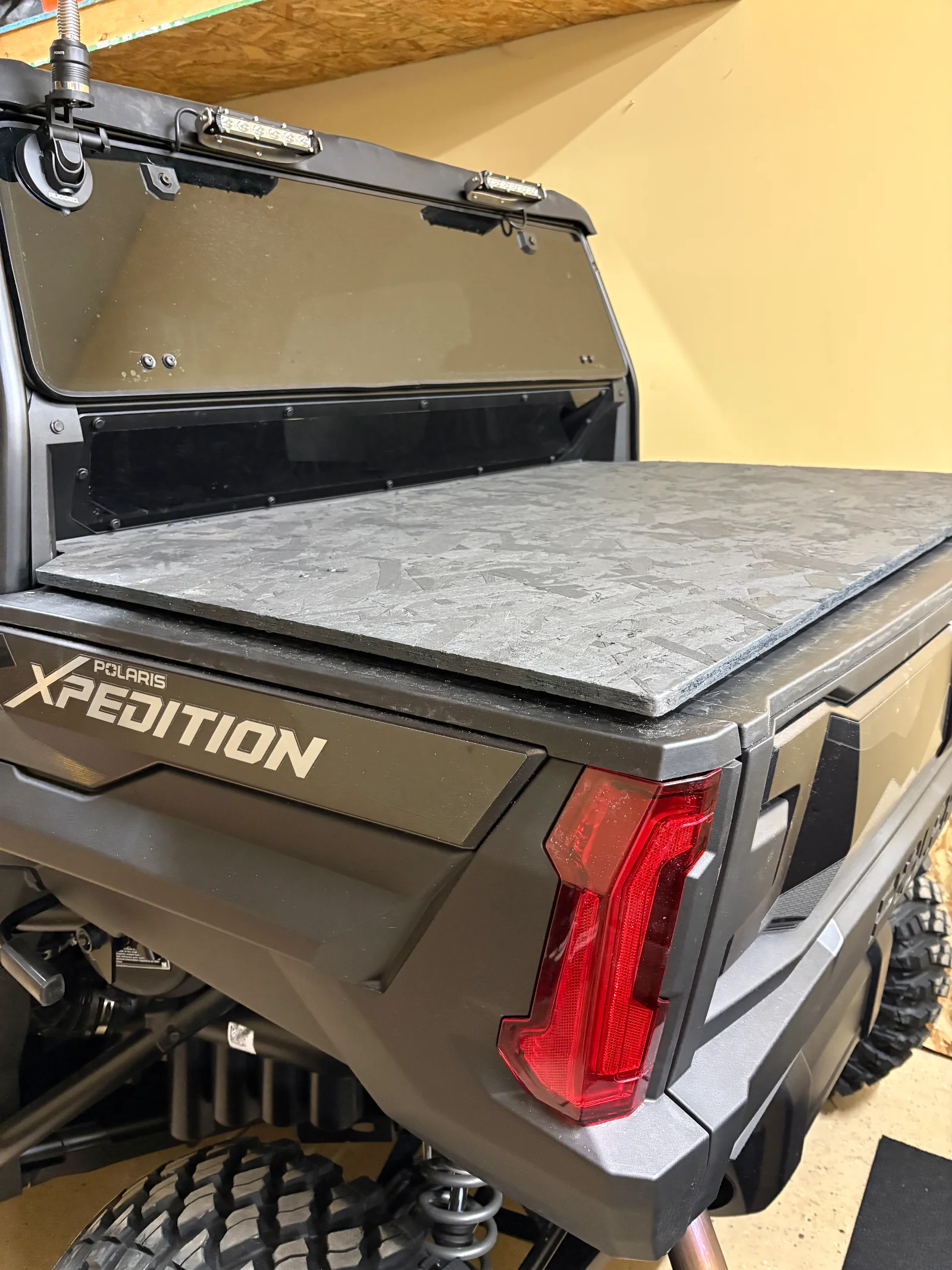

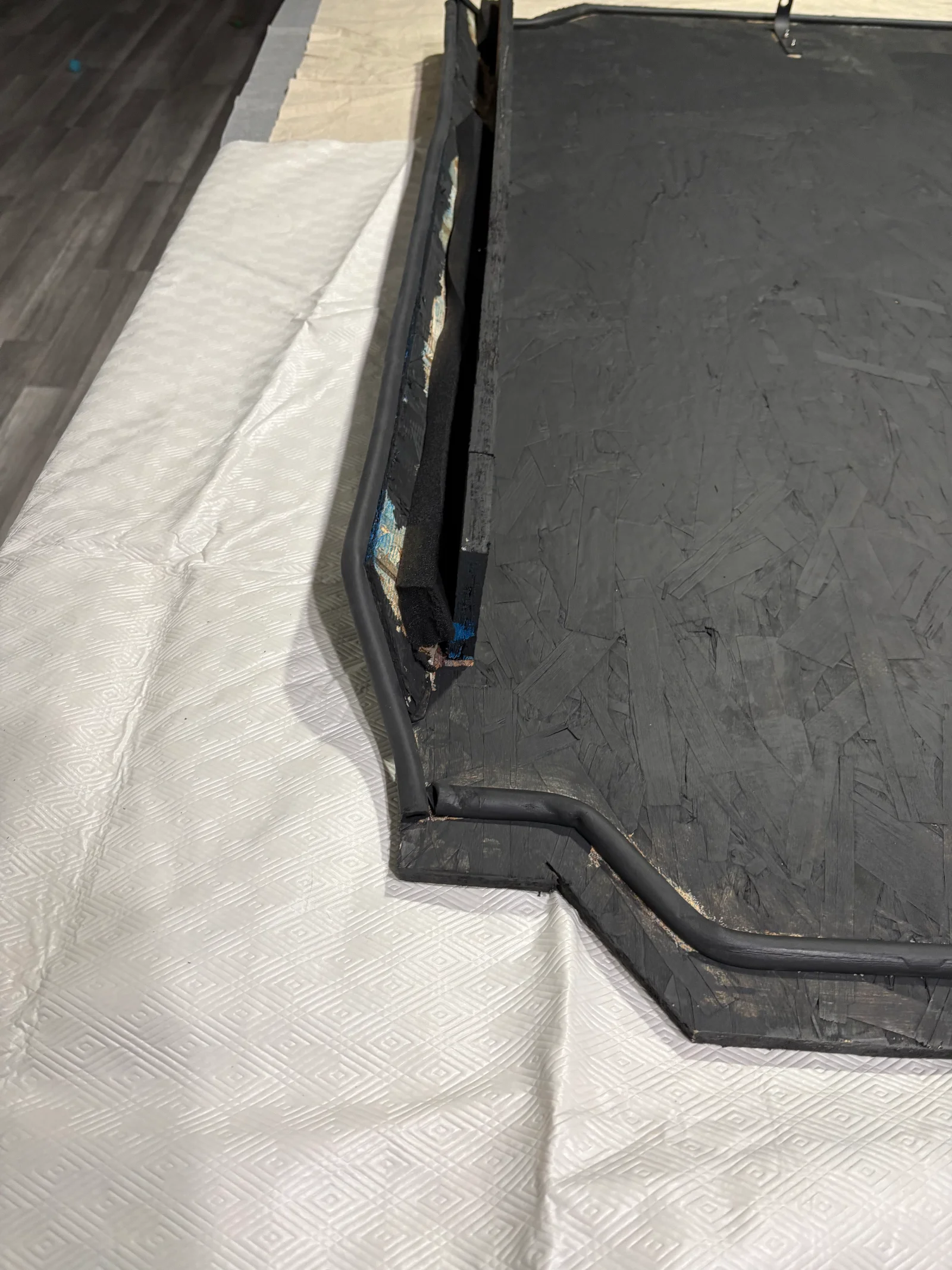

I ended up making one out of 1/2 osb panted black and wrapped with 1/4 foam with marine grade vinyl.
