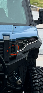

It's a good idea to keep it plugged in to a smart trickle charger, one that doesn't over charge and shuts down when at proper voltage. It's so easy with that charging port at front at left headlight.
Found it thank you special charger for these things ?
No, just look for one that is a "smart" charger that only charges when needed and doesn't over charge. Battery Tender is a common brand, they are small and usually have multiple connectors to use. The one on the ADV is common, same as some motorcycle ones. One pin is male and uncovered and one is female and covered.
