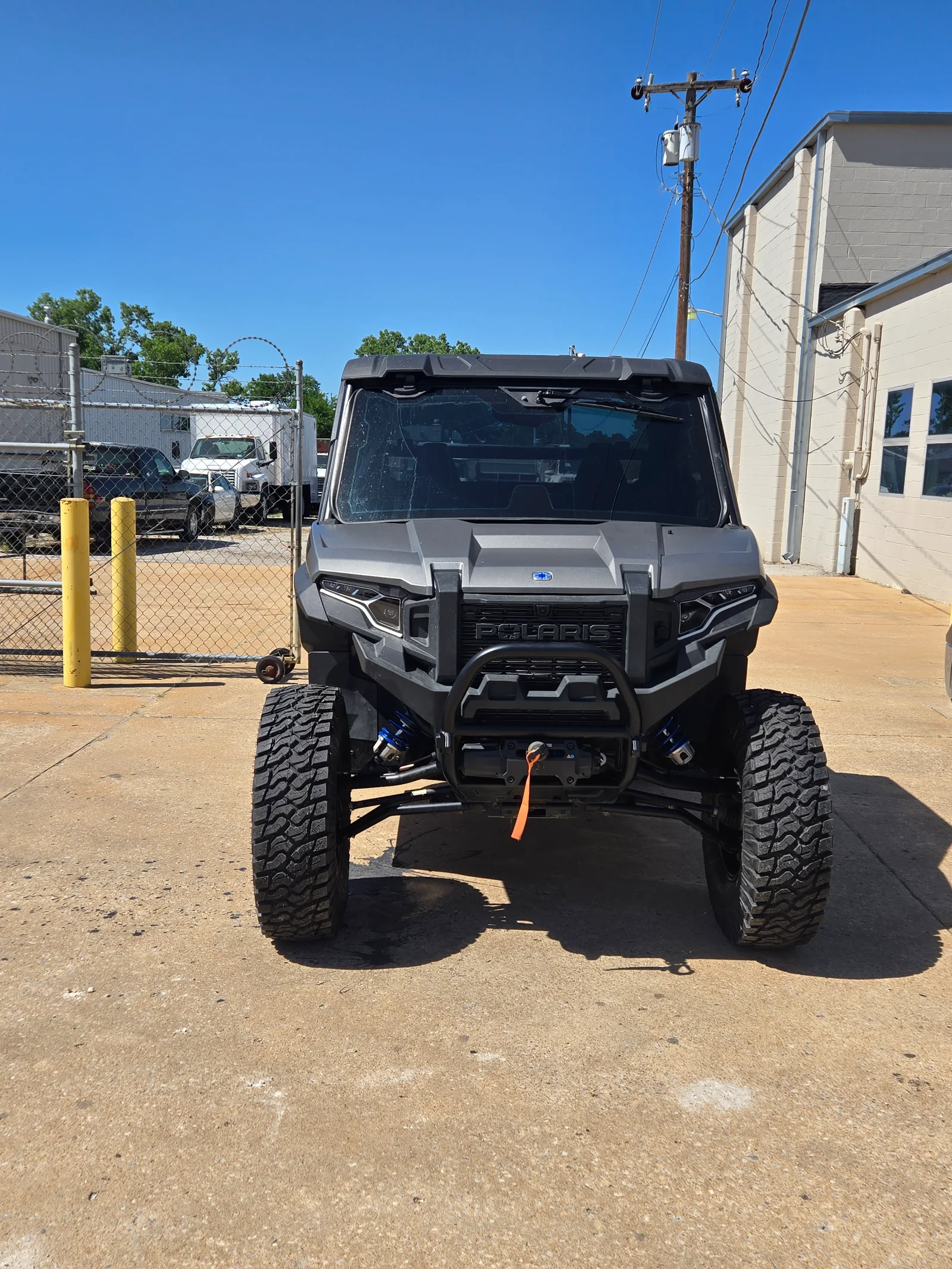

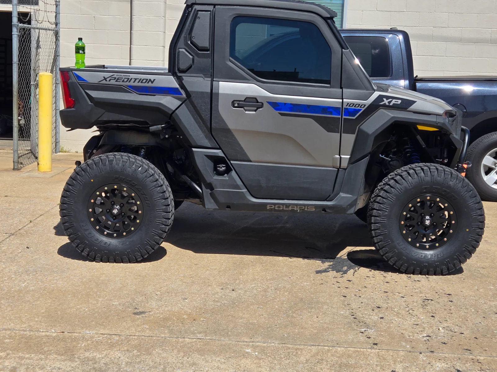

is anyone using forward offset A arms, if so is their really a noticeable diffrence. does it affect trun radius that much. thank you

I had offset arms on my XP900. It does affect turning radius slightly. The main problem is you will break your cv joints on the axles if you back up while turning sharp. SATV supplies steering stops with their arms but then your turning radius really sucks.
I was running stock axles, and then Highlifter, both had the same issue. If you can find axles that can handle the extra angle you might be ok.

I did the 1” forward to put 33s on.. I had to grind off the limiter pcs to get the better arc back in steering . I just have to make sure I don’t full steer then hammer throttles

I put 33” on my stock set up with offset rims. I have a good 1” of clearance while climbing down some technical black rock trails. I’m considering the change but am not sure I will gain that much. Many of the trails in TN and WV are a bit on the skinny side. Please share your thoughts. Thanks
