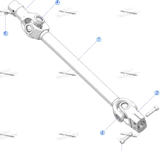

Thinking of driveshafts and remembering the necessity of a driveshaft requiring proper phasing...
Here is the Polaris parts page for the Xpedition front driveshaft.
Look closely and you will see that the U-joints are not aligned.

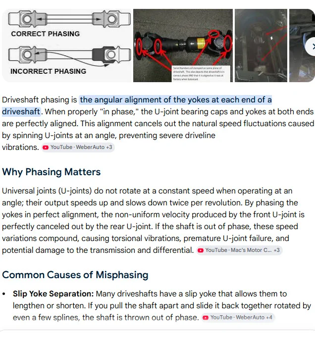

Here is a document on Driveshaft Phasing:
Note in the article that the U-joints must be phased correctly or the driveshaft is going to wobble or do other destructive things to itself.

Look at the graphic on the Polaris driveshaft and then at the properly phased driveshaft.
See any differences?

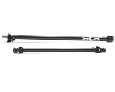

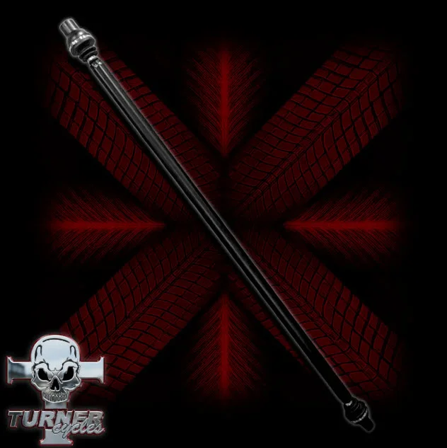

Here is a kinda dark photo of the Turner Cycles CV driveshaft for a 2-seat Xpedition. They also make them for the 4-seat models.
Notice there are no U-joints that must be phased. Just CV joints:

I believe this is the issue. I have seen one YouTube video of an Xpedition front driveshaft wobbling like crazy.
That is not a phased driveshaft!
I like the idea of the Turner Cycles CV shaft, but they state right on their website that they’re not good for high speed.
And I can confirm the phasing on Polaris’ OEM driveshaft. It’s keyed in the splines, so you can’t properly phase it without grinding out the splines. On the majority of machines, you don’t feel the vibration very much, but we’ve also come across machines with bowed shafts, straight from the factory. On those ones, the vibrations were definitely noticeable.
