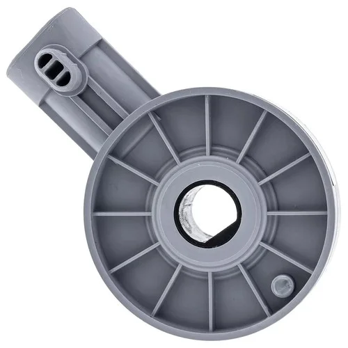

Looking for a Gear Selector Switch, Polaris is out of stock until end of November, current gear selector switch Invokes limp mode, I'm unable to find one through third party providers, Dealer diagnosed on August 28, 2025. Background on failure and dealer repair quote in attached .pdf. Question 1. Can this switch be bypassed? Polaris part number: 7662468 Believe this is what it looks like: Polaris SWITCH-ROTARY 2 PIN RESISTIVE 7662468 for sale online | eBay Thanks in advance for your thoughts and suggestions.
No real way to bypass that. It gives information to the ECU that tells it what settings to run. Like, in low, the torque and speed is limited. Where in high, it opens it up.
Best option would be to find a wrecked machine someone is parting out. It’s going to be a common part across the majority of Polaris’ lineup.
thanks, confirms what I'm finding out.
