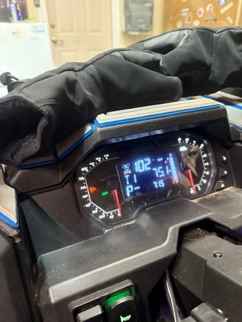

Hello, my 2024 Xpedition Ultima XP5 went for a drive and when i started my power steering did not work it was a tuff drive all day there is a warning light on it is a exclamation point with a funnel any body know why this is on and how to clear this or why the power steering is not working all of a sudden thanks.

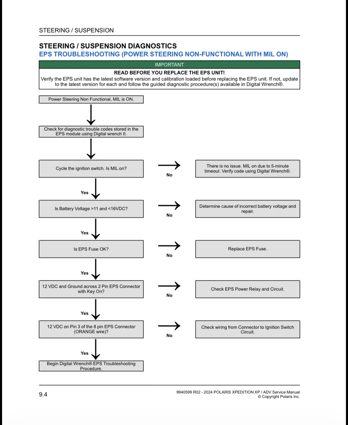

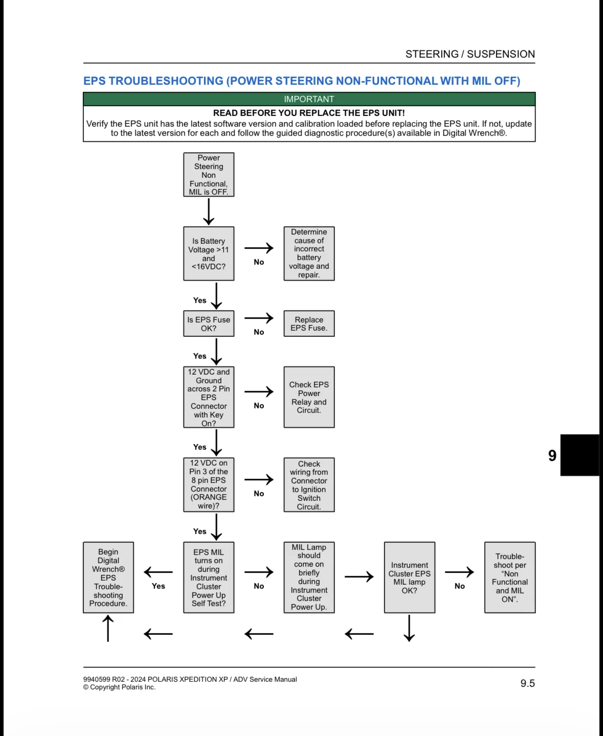

If you leave the key on without starting the machine for more than a minute, it disables the power steering to preserve battery. Cycling the key should clear that up.
If the machine was started right away, there may be a blown fuse to the power steering or a bad relay.
If cycling the key doesn’t fix the issue, and you’re still under warranty, I’d take it to the dealer.

I did cycle the key three times it cleared the dash but not the ride command?

Most codes are self-clearing when the issue goes away. If the power steering is now working but the ride command still shows the warning or code, you can try resetting the ride command by pressing and holding the center (Star) button until it restarts.
Otherwise it might need cleared by the dealer.
If the power steering still isn’t working, then I’m not sure why the dash cleared 🤷🏻‍♂️

Make sure your battery is fully charged,(being a 24 it may need a new battery), I had that problem with my RZR. The battery would work for everything else, but it was a little bit low on charge and I had the same warning light come on and no power steering,but once fully charged, it was fine.
Thanks everyone for the help I tried everything and ended up haveing to take it to the dealer to get it. Fixed the ride command need the computer to reboot but it is fixed now so thank you all for the help
