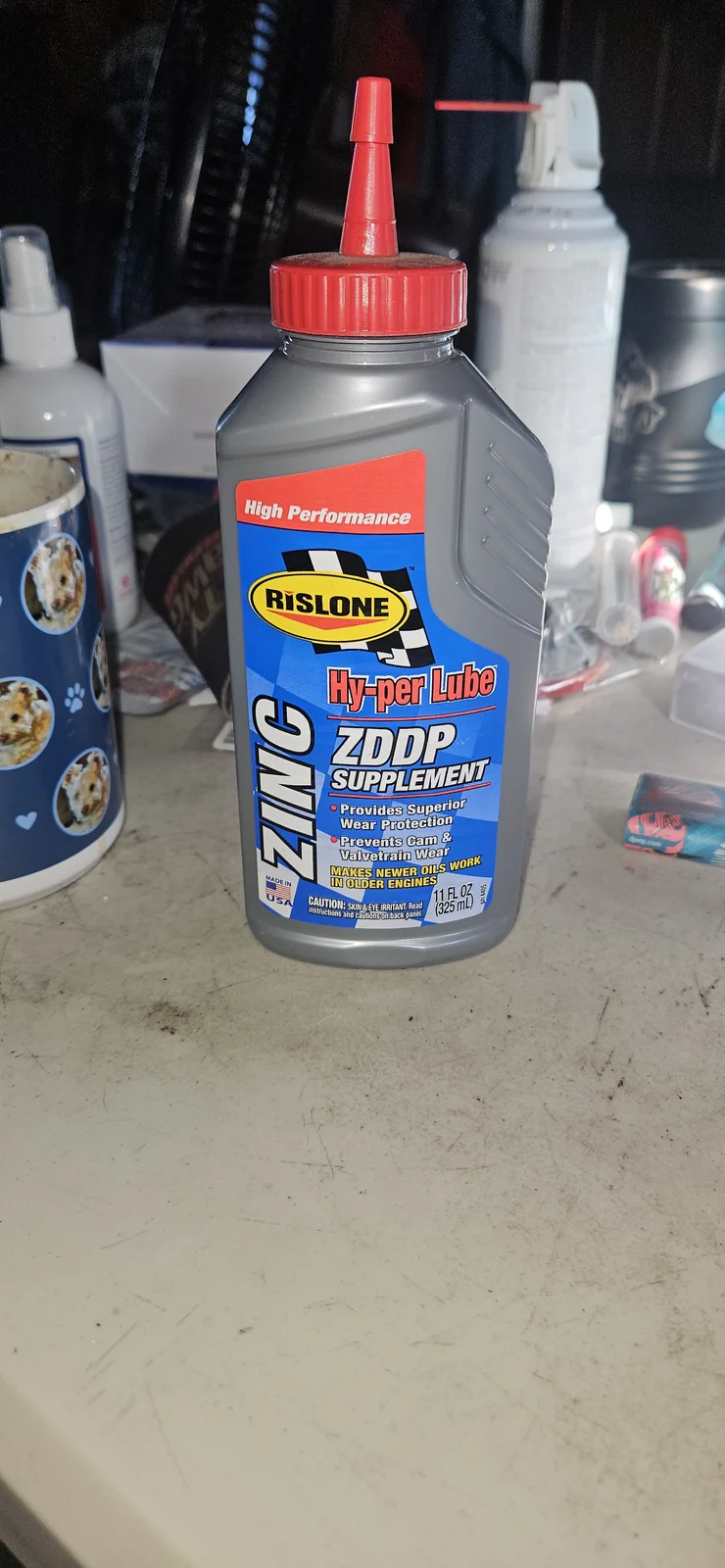

Anyone adding a little zinc to their oil?

I change my oil at less than 50 hrs. with Mobil 1 5w50 and 2 ozs. of zinc additive.

Zinc is need in classic cars because of the flat tapped lifters in older engines. Low/no zinc will cause the cam to go flat.

Nope, waste of money if you use the right oil.
I use Rotella T6 5w40. It has:
1310 ppm zinc, 1157 ppm phosphorus
as compared to Polaris 5w50 which is 860ppm zinc and 756 ppm phosphorus
