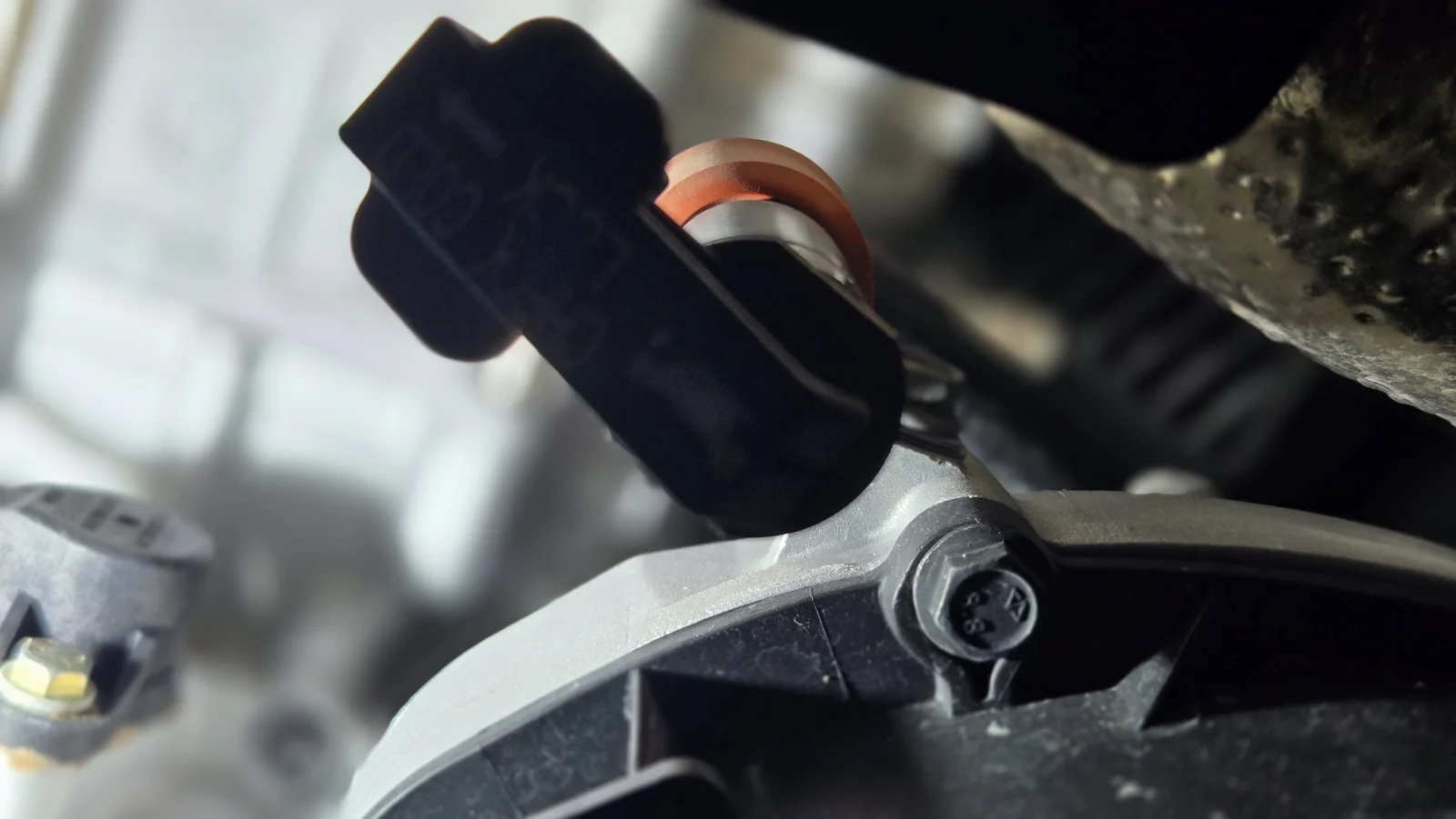

Did the first oil change on my 2026 ADV Northstar 2-seat.
At about the same time a couple friends have been installing a relocation kit on their 2025 ADV Northstar units.
Discovered there has been a change in oil filter location. Here's a photo of mine. You can't really tell from the photo, but the filter is now horizontal and pointed towards the Passenger side.

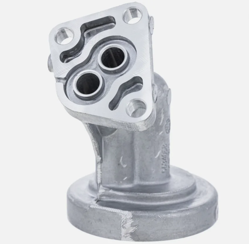

So, I started some investigating and with a bit of work, found this. Keep in mind, it's very difficult to find a website that has the 2026 Xpedition parts pages. Here is the oil filter mount for the 2025 Xpedition models. The mount bolts to the engine block using "filter adapter seal".
Polaris PN 3610348
Note that the filter is angled down.
Here is the oil filter mount for the 2026 Xpedition models.
looking at the bolt pattern on both, one can see how the angle of the oil filter can be determined.
After taking off the rear section of the skid plate, there was the oil filter.
I placed the oil filter wrench, socket, cap...whatever on the oil filter.
Then used a 3" extension and a standard 3/8" ratchet. Loosened the filter and removed it.
Dang! It's hard to see, but the filter is now mounted horizontal, which means it doesn't drain back into the engine.
