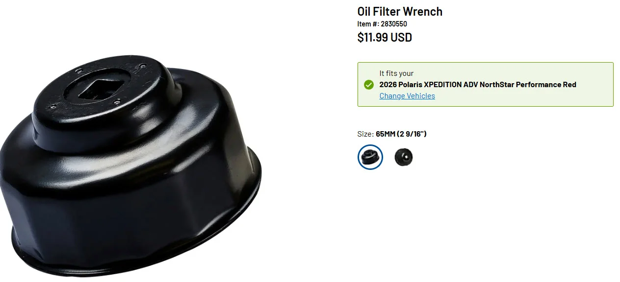

This is the redesigned on that is supposed to fit better. It was $11.00 so the savings would not be enough to make me want to stop at another store :)

For those who may not know...yet...this is what some are calling a 65mm socket. It fits over the end of the oil filter an has flats to match those on the oil filter.

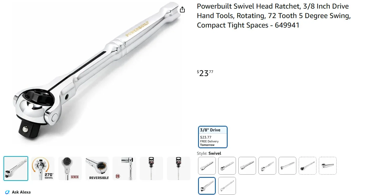

To loosen or tighten the filter, a friend recommended getting on of these swivel head ratchets. It provides easier access to loosen the filter.
and you'll need a 3/8" drive to 1/2" adapter to mate the ratchet and socket.
Just a little perhaps helpful information.
