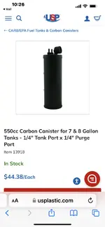

The vent is located on driver side . It goes into frame tube behind driver seat . Mine normally does smell on half or less fuel on hot days. I am going to install a charcoal canister in line . I am not waiting on Polaris to solve. Have a great day .
Ours did it for the first time on our latest trip to Colorado. Had less than 1/4 tank of fuel. Had to put the windows up and turn the AC on to keep the fumes out. Let us know if you get yours fixed with the charcoal canister
