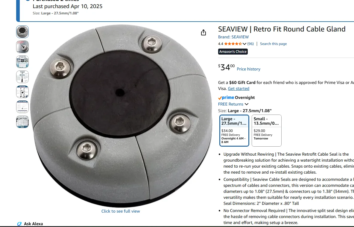

I bought the 50" rough country curved light bar with the brackets that mount in the door corners of the frame. They didn't send a grommet or anything to run the wire from the light bar into the cab. What is everyone using to do this? I don't want to get any leaks in my cab.

Just get a rubber grommet (most hardware stores have them). If there is a connector at the end of the cable, just make a single cut in the grommet to let the cable pass through. Then seal the grommet from the inside of the roof with black RTV.
