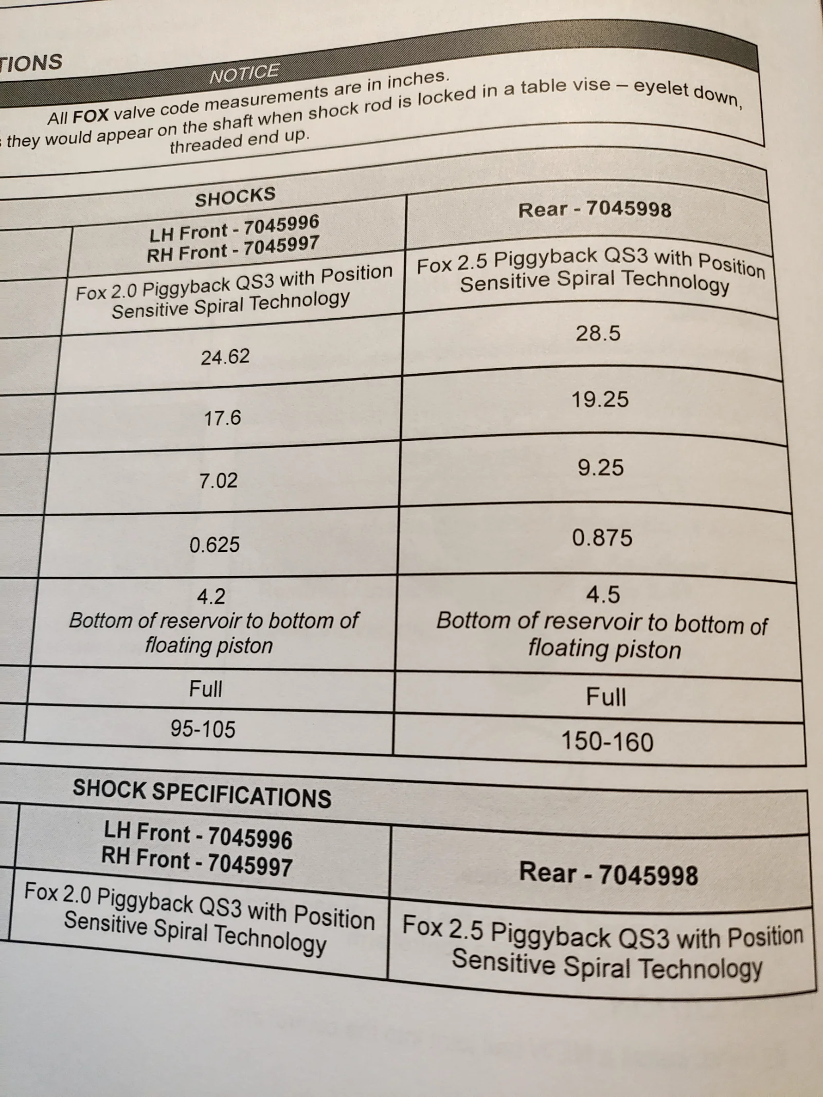

The service manual says the front shocks should be at 100 psi and the rears at 150 psi.

From the Xpedition service manual

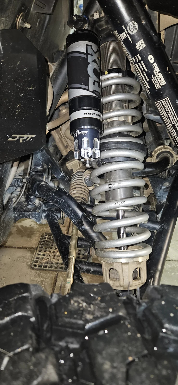

I did the shock therapy upgrade to mine and notice a wonderful feeling in the ride especially over the small bumps, and rocks . They are more progressive from the stock spring set up.
I went with the STI single springs. Rides great and no worry about spring rubbing on the shock body.
What kind of riding do you do? Been thinking of getting single rate springs. Their setup makes sense due to the weight of the machine
I live in Western Colorado, so we do all kinds of riding. Rough mountain roads to rough desert Moab type riding including some rock crawling. I like the spring set up. My son has installed several sets on Xpeditions including brand new Xpeditions for our local Polaris dealer. I PM you with more info
