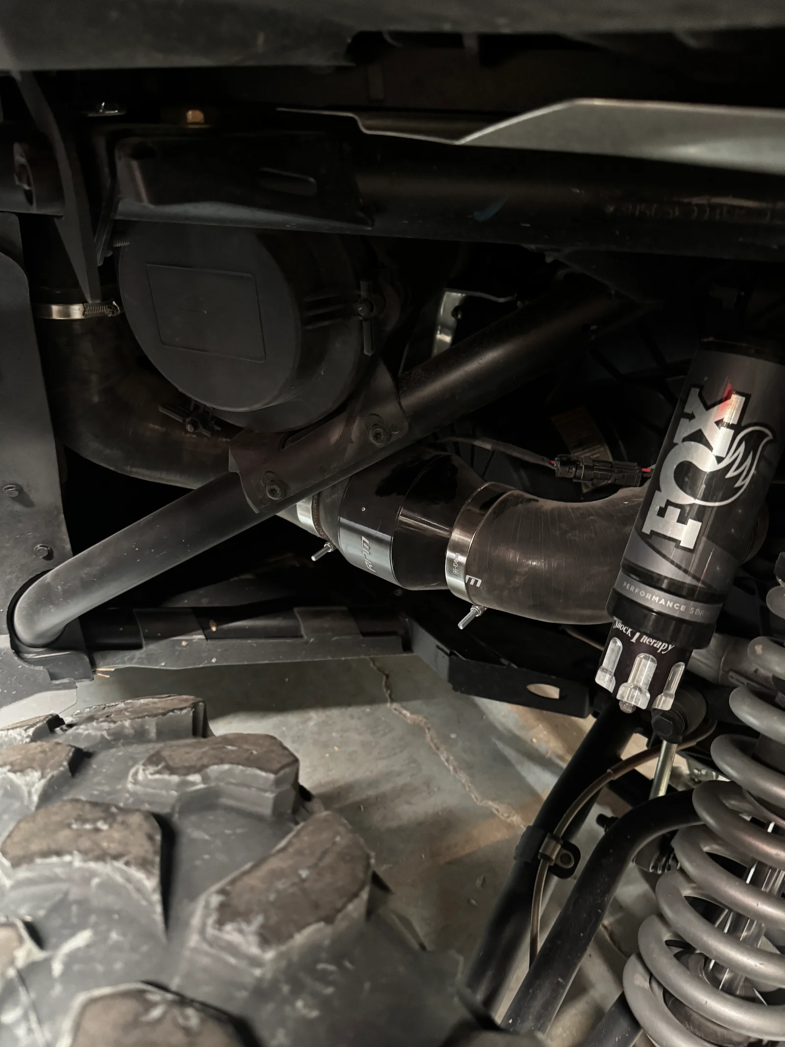

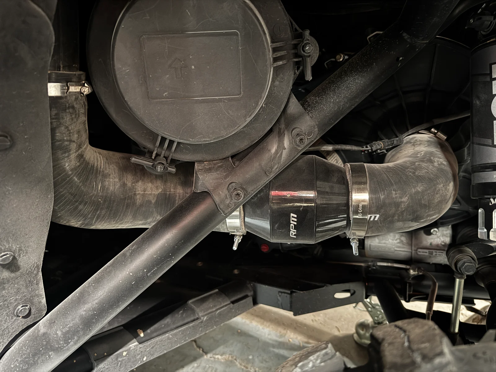

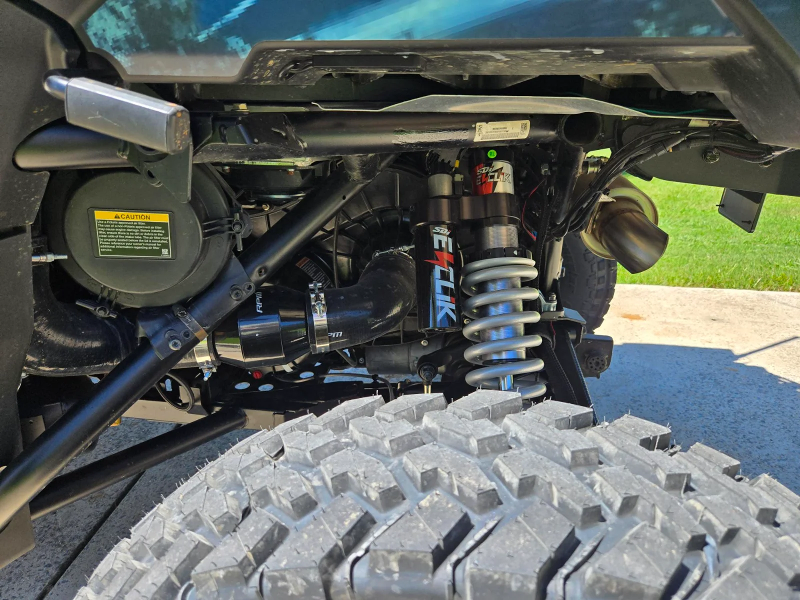

We installed the RPM ECF on my Brother’s ’25 Xpedition XP5 NS from brand new and every time we were riding together he was reporting 20°f+ lower belt temps than I was running. Both our Xpeditions have belt temp gauges installed so we can see what the belts are running when pulling our Camp Trailers.
With my ‘24 Xpedition XP Ultimate being one of the first to arrive after they were released, I have a few years of belt temp data to compare with.
I finally got around to purchasing and installing the RPM ECF last week, just before heading up to Little Sahara Sand Mountain Dunes, and the difference is amazing!
Last year, riding Sand Mountain, my belt temps peaked over 260°f and with any pushing stayed above 210°f.
This year, with the ECF installed, my belt temps peaked at 208°f and averaged around 174°f when not climbing the mountain itself.
The RPM Electric Clutch Fan Kit
(RPM Polaris XPEDITION "ECF" Electric Clutch Blower Fan Kit
Was very easy to install, simply plugging into the driver side taillight harness and using the RPM Silicone Clutch intake tube replacement (required to install the ECF) though I cut the wires near the fan and added a harness plug so the Fan can be completely removed when doing clutch/belt work, without removing the entire wire harness.
The price, like the majority of RPM’s products, was quite reasonable. At a grand total of $346.70 for both the ECF and Silicone Intake Tube, I feel like the extension of belt and clutch life will pay that back easily.
Overall, this is a highly recommended upgrade for anyone who likes to use their Xpedition to its fullest.

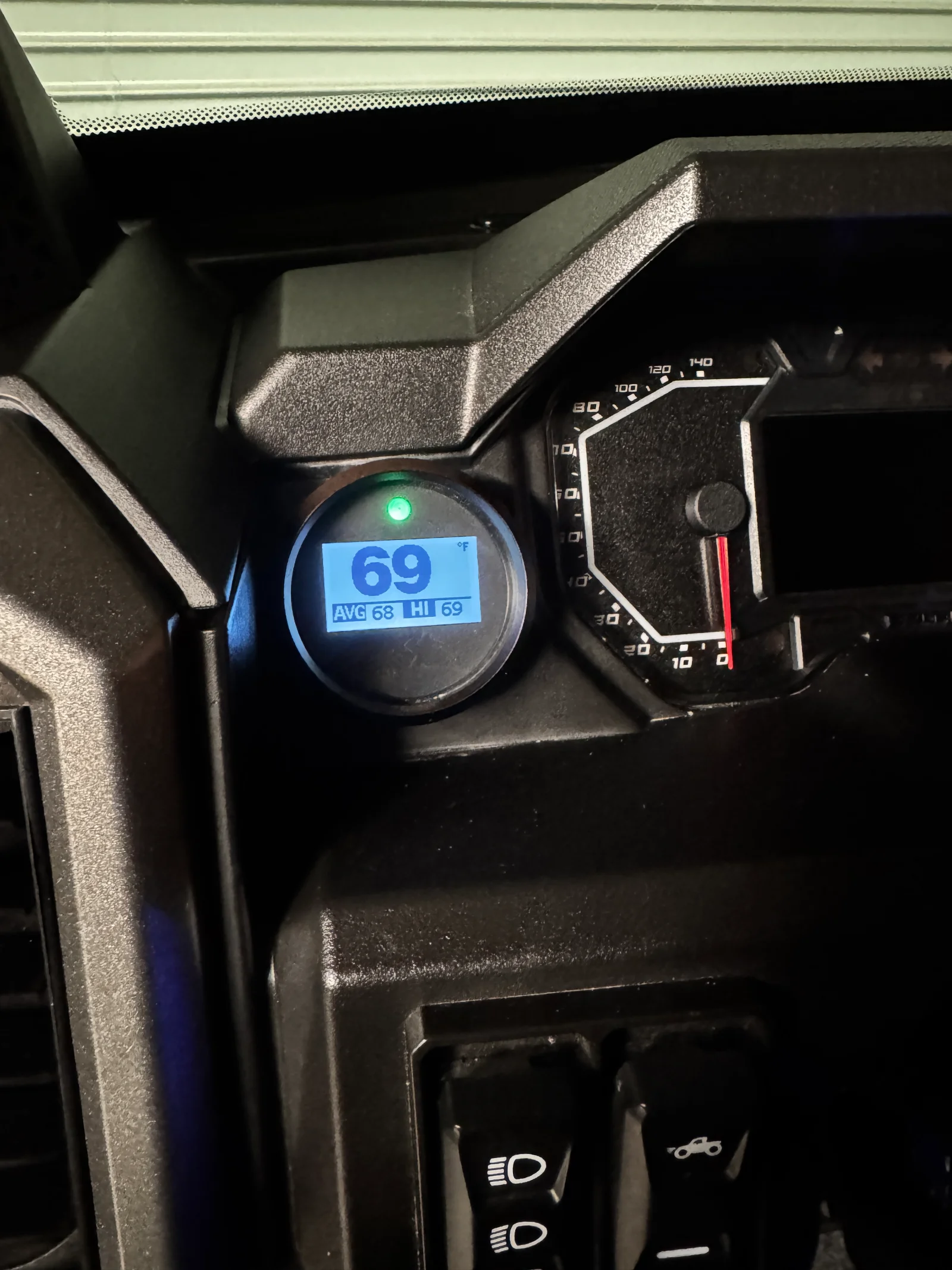

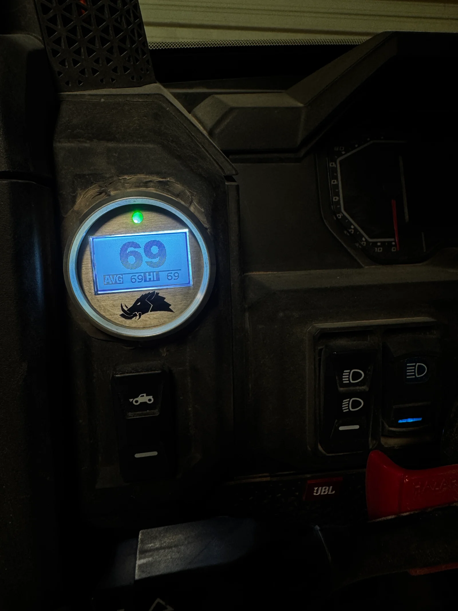

what are you using to monitor the belt temp ?
is there a specific model, and could you share some pictures of the install of the sensor.

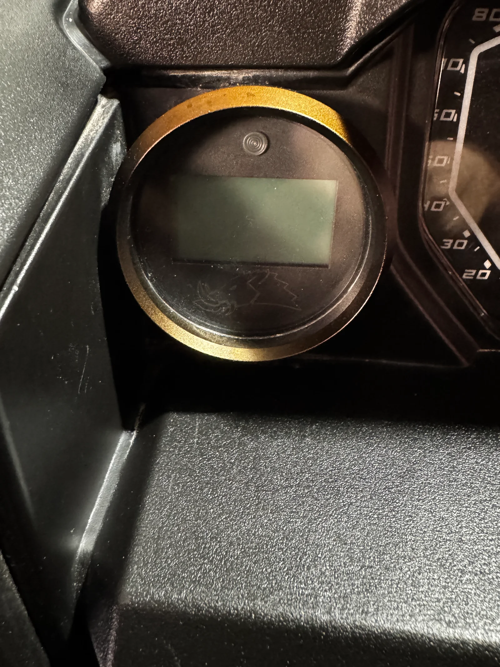

Their older model gauge was non-dimmable. That’s what’s on mine. The newer gauges are dimmable and need a rocker switch slot for the dimmer/program switch.
3.2 Dimmable Infrared Belt Temp Gauge | Razorback Technology
With my Xpedition being an Ultimate, I have the vent covers for adding switches and gauges. The Northstars are more limited on mounting locations.
I found on my Brothers Northstar that with being very precise, the gauge just barely fits between the instrument cluster and side.
I did have to carve just a little off the instrument cluster lense, behind the dash, for the gauge to fit, but it was minimal and didn’t break the seal of the instrument cluster.
On mine, I ran the sensor cable up the a-pillar, back along the cage and down the rear pillar, and then back to the clutch housing.
On my brother’s, we installed it at the same time as the Turn Signal Kit, so the sensor cable was run along the bottom frame near the driver side, and then up with the factory engine harness and over to the clutch housing.

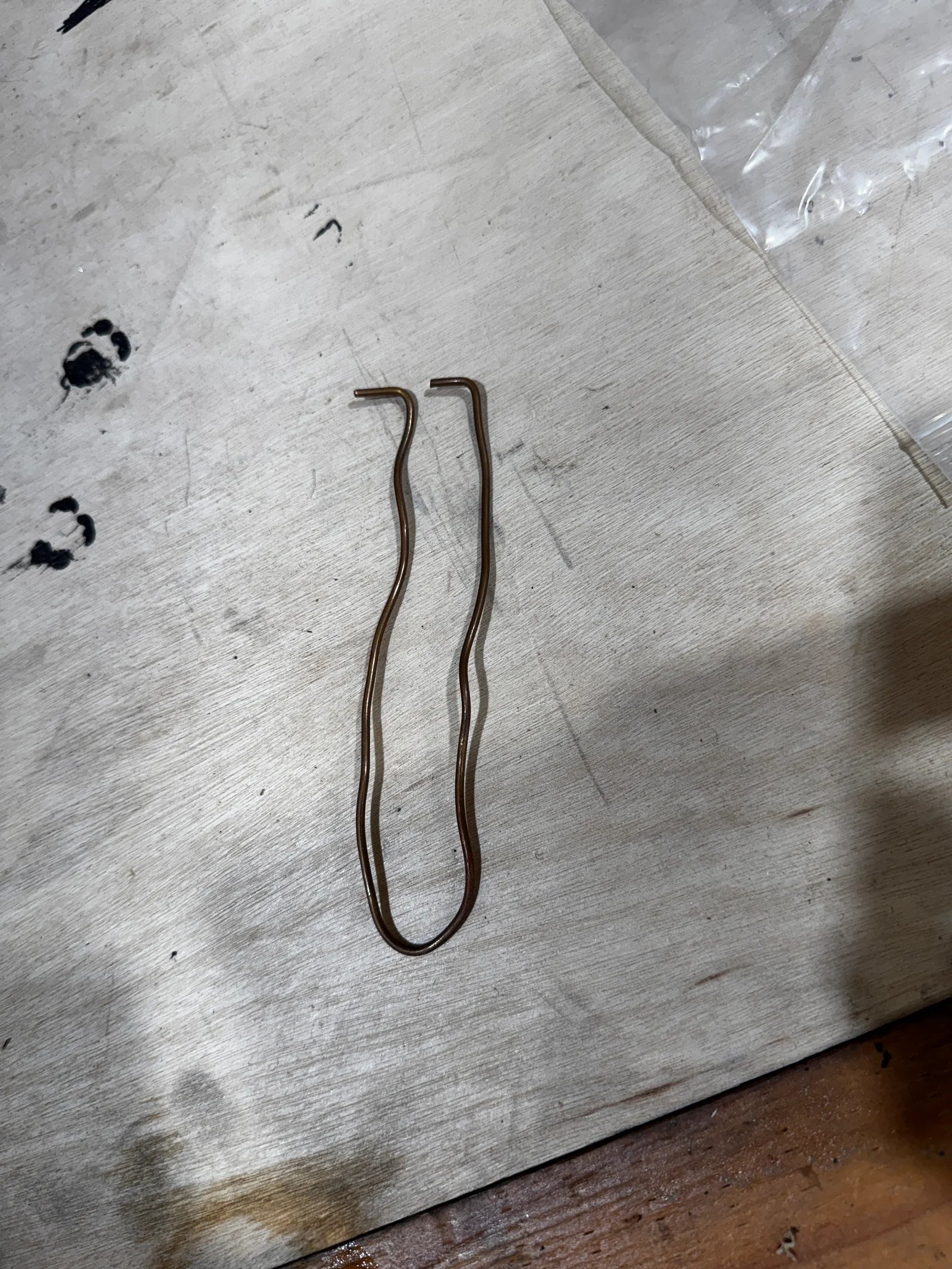

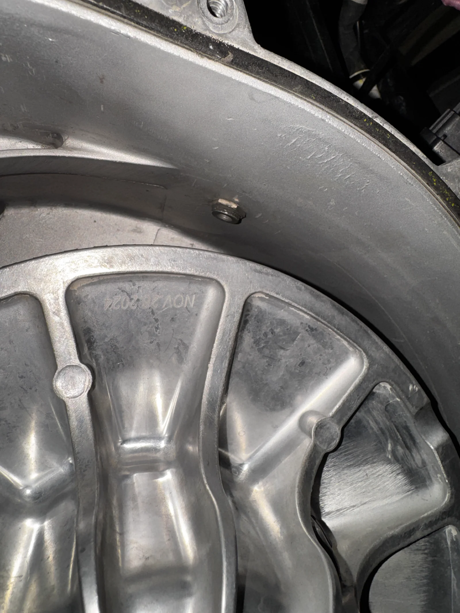

There’s pretty much only one spot with enough space to fit a drill and that’s right behind the throttle body. (If you have the ADV it’s going to be bit more work than the XP)
To mark where to drill, I bent a piece of wire…
So the sensor would be centered on the belt. Make sure to remove the belt and secondary clutch before drilling so you don’t damage either.

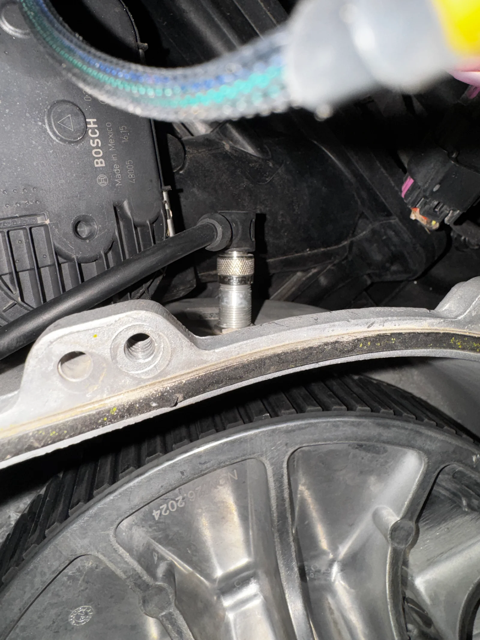

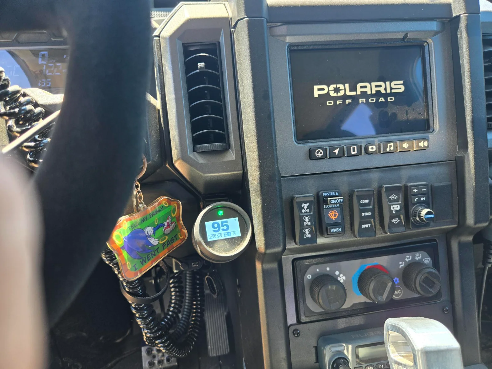

I have the RPM Fan and I am very pleased with it. I also did the Razorback temperature gauge and again i am very pleased. fwiw Razorback does offer a fan that works with their gauge.
I mounted my razorback in a pod mount from summit racing Holley 26-619 Holley Gauge Pedestal Mounting Brackets | Summit Racing
worked well for my particular install.
I like the pod mount. The Northstars in particular are space challenged for adding accessories like the temp gauge
