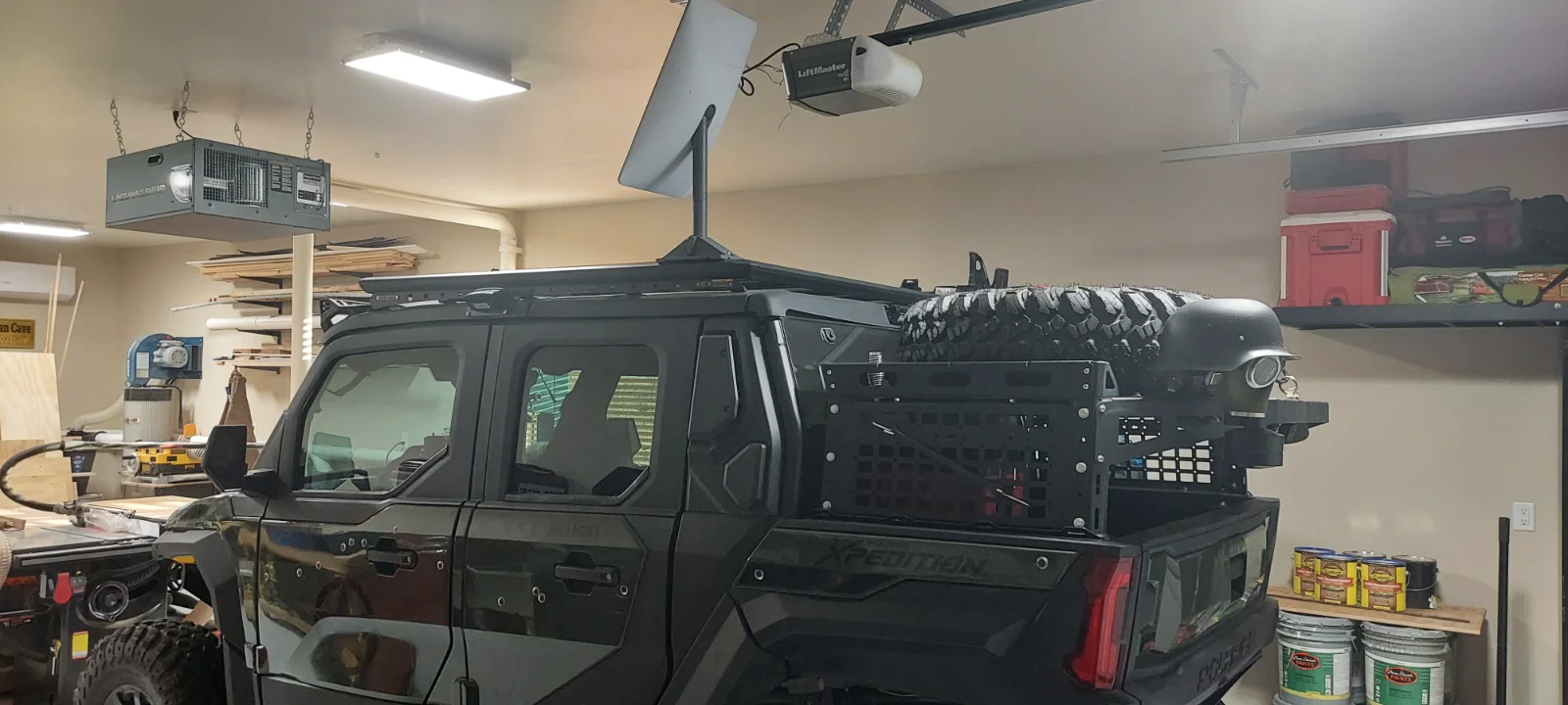

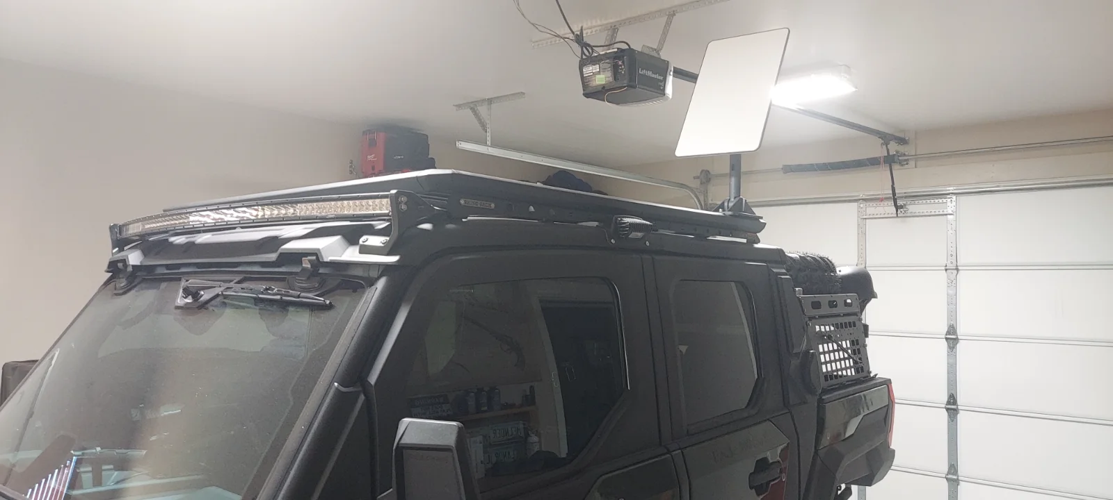

Starlink mini on top of Rhino roof rack for a year or so. Couldnt be happier with functionality.. work well to 250 feet or so for handheld device. Modified mount to reduce damage to dish from low hanging branches. Wiring down above liner, through rear pillar to above/near skid plate and up through center console to lighter plug inside console (wanted engine running to receive power). Use Jackery like portable power station (1024 watt rating) when engine not running (parked, or at campsite with toy hauler). Needs direct line of sight from mini to open sky (some tree obstructions ok). No problem with 10 amp fuse ... can't remember if I may have put in a very very slightly larger fuse for a previous project need to double check i tend not to stress any circuit beyond 75% capacity. Also have both acc and engine on usb ports in cab from previous project. Fyi, im currently installing a DC to DC converter to charge the power station via the solar ports while I'm moving in the X. Installed 4 gage wire/fuse/40 amp/breaker switch to bed area of adv 5. The mini dish/router likes more current to improve reliability/availability depending on physical proximity constraints. Will be testing workability after this Fridays FedEx delivery of DC to DC. In the process of installing 2048 watt power station and additional solar panel on RV / TOY Hauler using like architecture for either solar or DC using my truck's alt / battery for DC to DC (50 amp). [Now that I understand the stock battery wiring fuse/isolation architecture I may not be concerned about running down the X's battery because of excessive accessory battery use]
