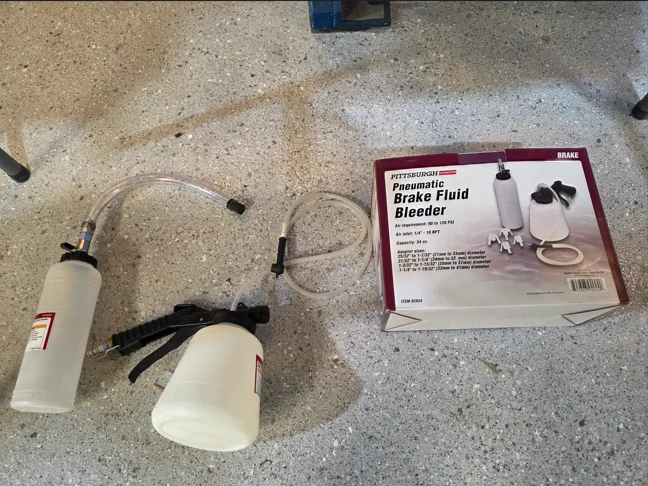

Starting with an empty brake system. Bleeding all the air out can take a lot of time and two people. A couple years ago, at Harbor Freight, I bought a brake bleeder kit that uses compressed air to create a vacuum in the the bottle and pulls brake fluid through the system. Here is the kit:
