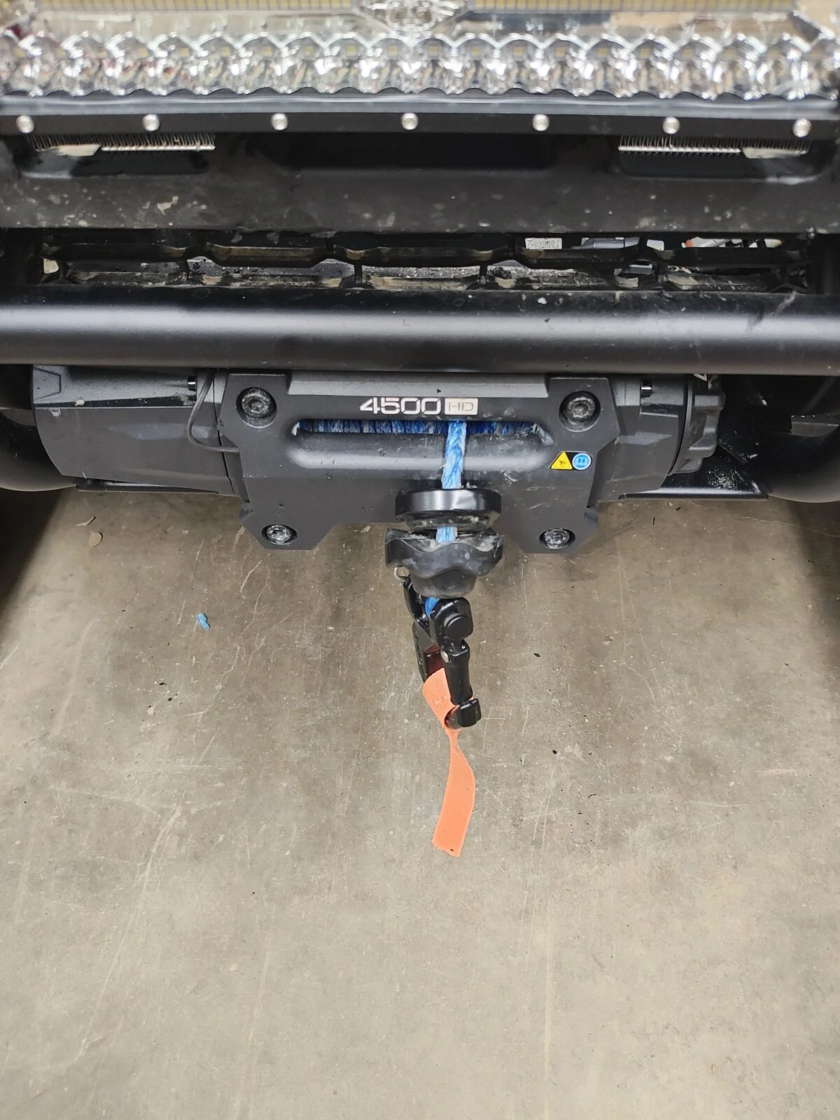

My Northstar Auto stop did not work from the factory. It actually pulled the rubber donut with the magnet into the Fairlead and tore it up..
When I added the remote control kit to the expedition that changed out the Auto stop box as well. My auto stop now works except I had to mount the donut behind the rubber stopper instead of on the outside of it like it's supposed to be. That might be because the magnet got all broken to pieces and part of is missing. Not sure about that.
When I added the remote control kit to the expedition that changed out the Auto stop box as well. My auto stop now works except I had to mount the donut behind the rubber stopper instead of on the outside of it like it's supposed to be. That might be because the magnet got all broken to pieces and part of is missing. Not sure about that.View attachment 769
The rubber stopper is there to allow a little tension before it stops. Otherwise it’ll hang loose like in your picture.
It should. If yours isn’t auto stopping you should check the plugs and make sure it’s plugged in at both ends. It’s a standard feature on the Xpeditions
The Auto Stop and remote are stock with the 6K winch but not with the 4500 winch. You have to order that and the remote as accessories for the 4500 winch.
It was factory stock with the auto stop on my 4500# winch on my XP 5 Ultimate. Just no wireless remote.
Same here. My auto stop works fine with the rubber stopper between the magnet and fairlead. No remote here either. Was disappointed in that as my Ranger came with the remote.
I see on Polaris's web site it says the auto stop is standard on the ADV 5 Northstar and another place it says it's an accessory. So I'll call Polaris tomorrow and see what they say. If it's stock I want it!
Answer: Standard on the NorthStar.
