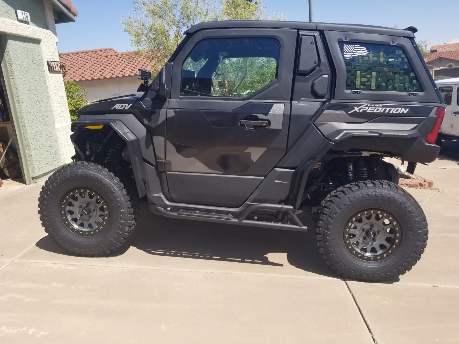

So I have decided to hold off on adding a mid travel kit on my 2025 ADV Northstar . But I would like to replace my wheels and put 33's on it . The Pro Armor wheels on it now have a +62 offset . I would like to put something in the +10 offset on to set the wheels out a couple of inches on each side . Does anyone see any problem with that , and any sugestions ?

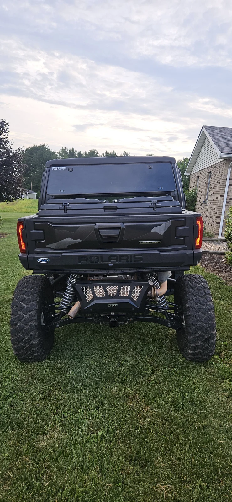

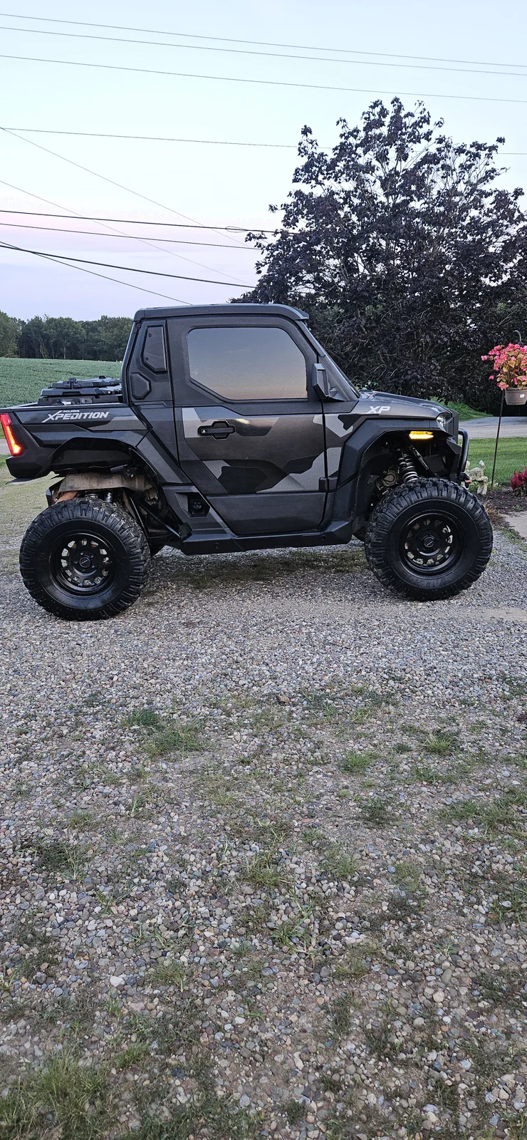

I went with 4+3 wheels and 32x10x15 tires.I'm at 70"wide. No rubbing or other issues. I've since added MTS springs.
