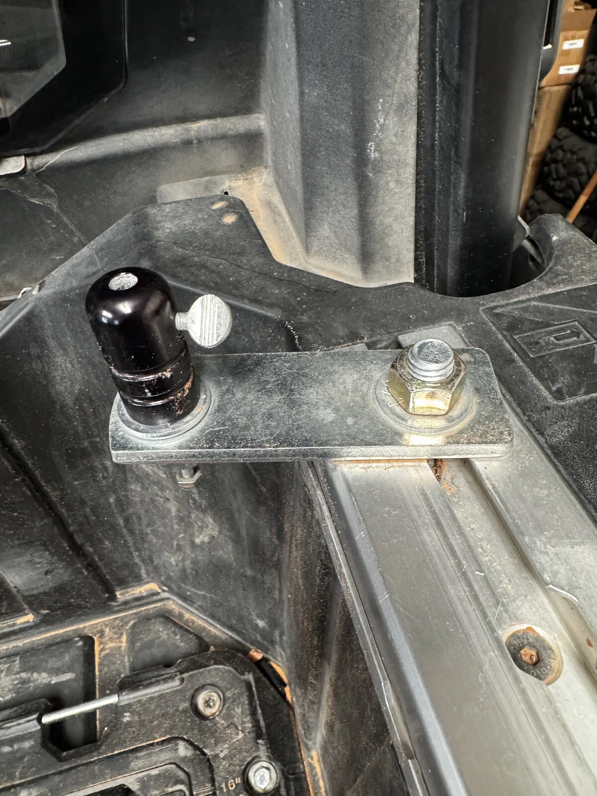

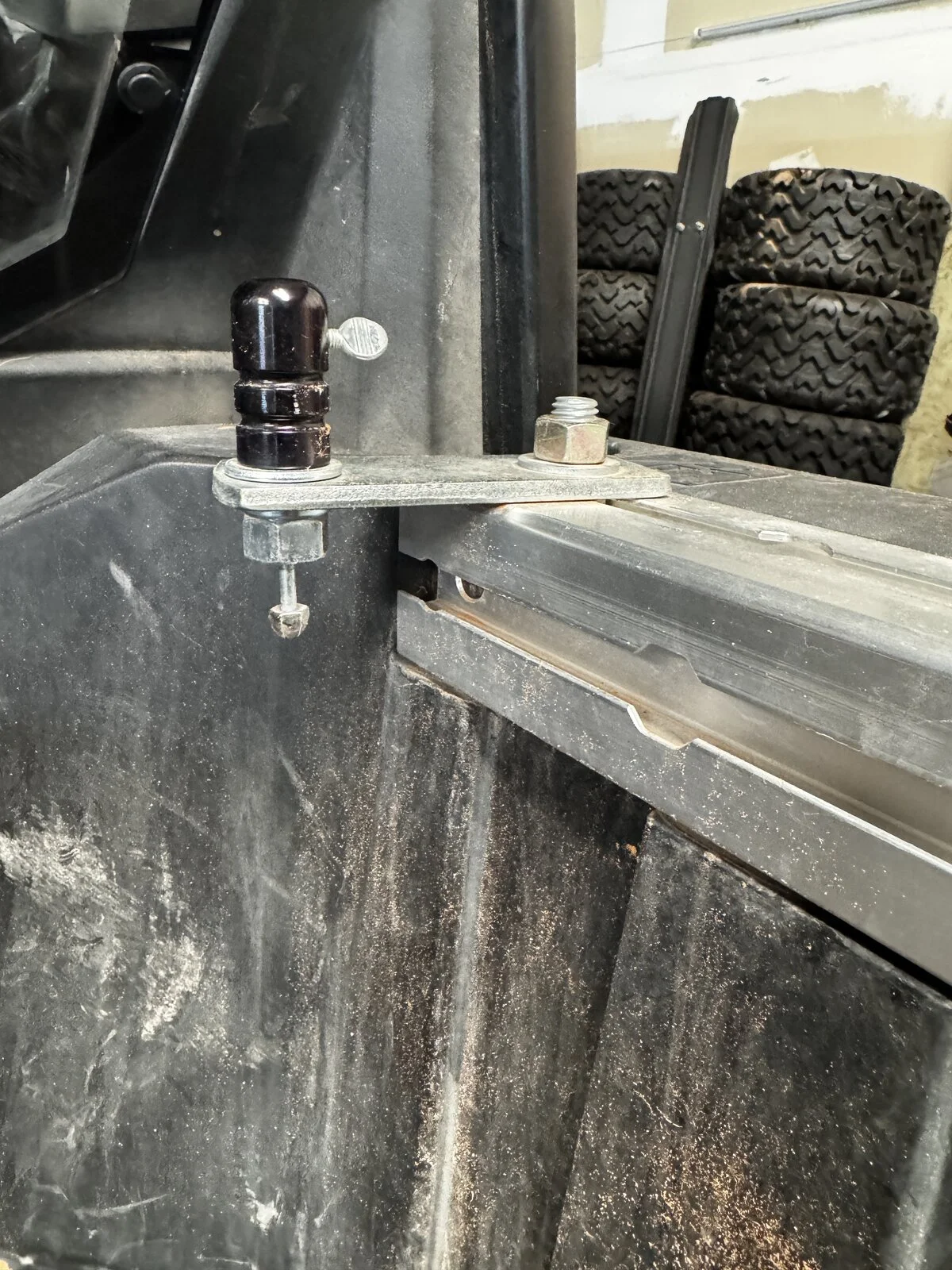

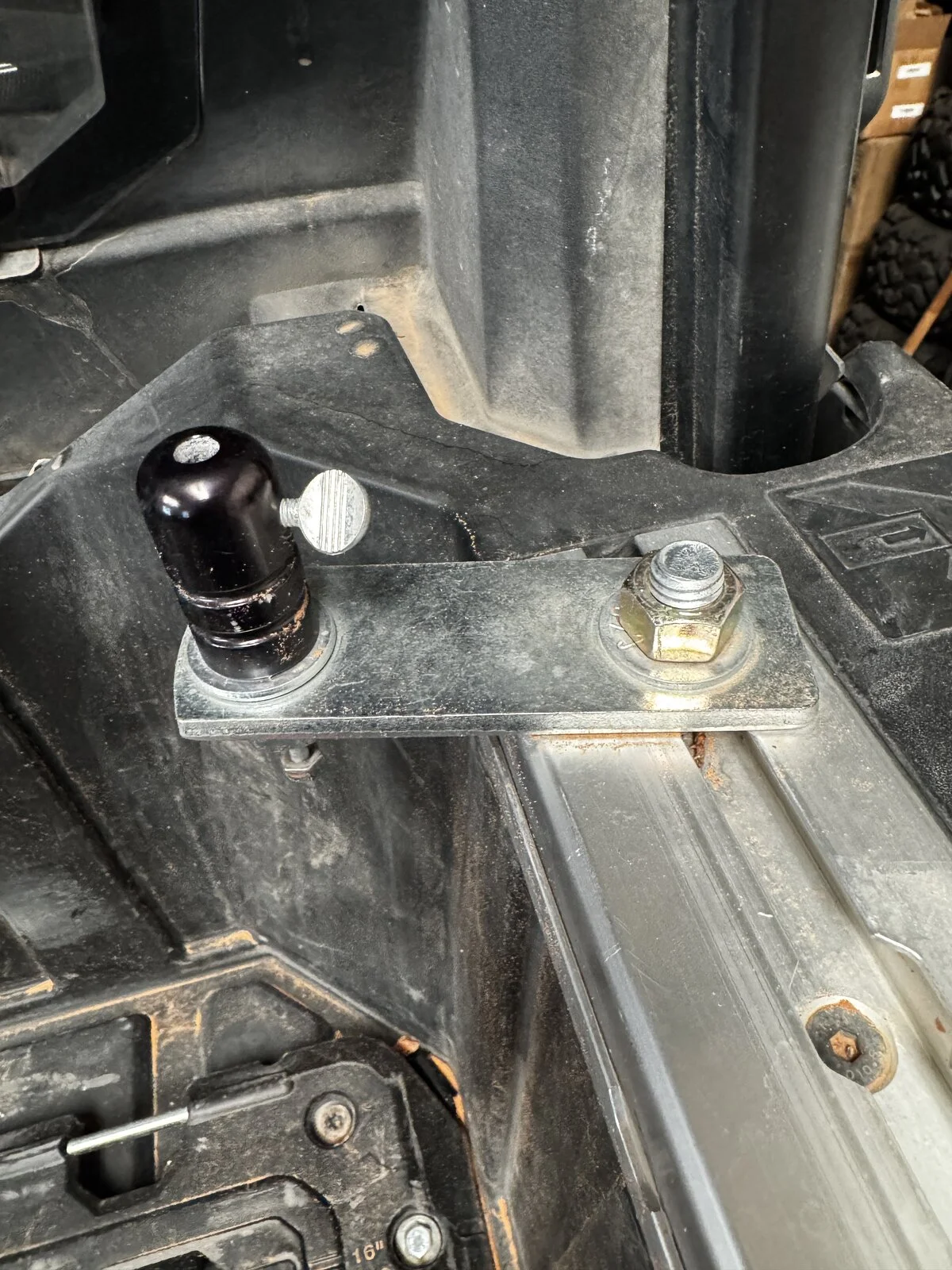

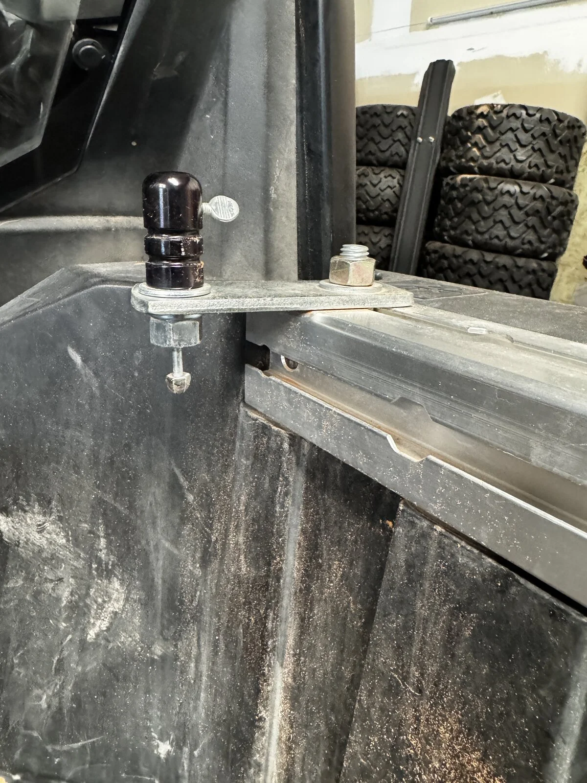

For a less expensive option that only works with the XP, this is what I did.
These are just 1/4” spacer bars I had laying around with holes already in them. (Basically a 1/4”x 1-1/2” flat strap). A 1/2” bolt will drop into the rail slots but I had to file the shoulder by the head for it to slide down the track. These have worked great for our Xpeditions but I was keeping an eye on Vyper for all the ADVs we work on.

That is the what I am going to do for my daytime flags for the dunes. At this point, until more things are made for the Xpedition, it is going to have to be homemade! lol
