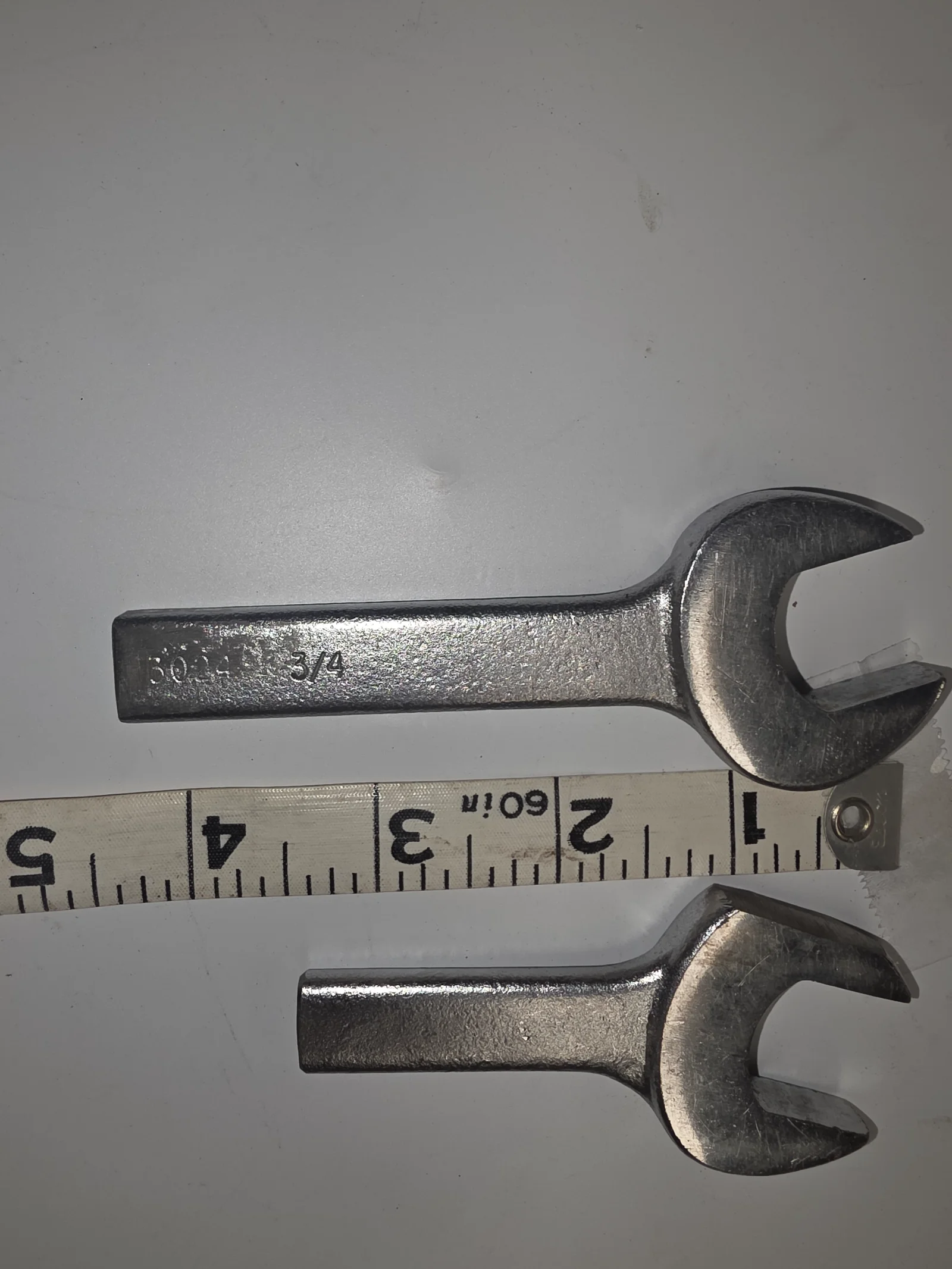

Pirate here, I've seen a number of posts on FB about adjusting the Xpedition clutch cable.
Here is a photo of the tools I made for getting the job done easily and without bloody knuckles.
I took a two excess 3/4" combination wrenches. Determined the lengths. and ground one side off for clearance.
Here's a photo:
Just thought I would share.
