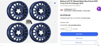

So I am looking at buying these wheels for my xpedition. 5 +1 offset. Am I gaining any width because these are only 6" wheels where the stock wheels are 7" wide with a .68mm off set.
I am running 5+2 and I am 68" wide. Should be way more stable than the stock width
