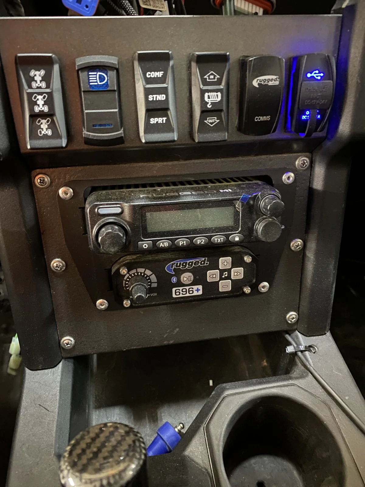

Probably be a little more work on yours as you have to remove the headlights to install the strips (according to the instructions). And switch blanks shouldn’t be a problem for you. Our Xpeditions are XP Ultimates so we cut out the lower part of the dash where the A/C controls would’ve been and the lower switch area to install radios there.
I’m curious where Rugged will try to mount radios on a Northstar. There’s no room on the dash with the A/C controls in.

Probably be a little more work on yours as you have to remove the headlights to install the strips (according to the instructions). And switch blanks shouldn’t be a problem for you. Our Xpeditions are XP Ultimates so we cut out the lower part of the dash where the A/C controls would’ve been and the lower switch area to install radios there. View attachment 148
I agree. I have the same rugged setup as in your pic in my current Viking but with the stereo system and fully enclosed cab I'm gonna see if I wanna do an install or not. I always have handheld HAMS for comms but obviously not as much wattage as a mobile radio. We mainly used our headsets for music and in cab comms.
Radios at the least are a must for us. Most of our rides are fairly large groups and they tend to get strung out on the dusty desert trails. In a Northstar I could see going without coms but they’re good noise reduction on open cabs as well as being able to talk to passengers without yelling.
Totally agree for both reasons you cite...in cab and group comms. I have loved my system on my Viking. I won't do it unless it's a clean install like yours so I'll have to see what they come up with.
