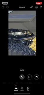

Xpedition Turbo Kit on the way ?
Here’s proof of life .
It would shred belts before clutch kit . Bikeman kit with a whole lotta weights.
That’s what I have currently on mine with their tune and exhaust. Running 35s and got the chance to drive a bone stock one the other day. There is some difference between the two as far as power but not enough to question 35s.
Yes it does have an intercooler . I am mounting my radiator on roof rack . I will probably oversize cooler if I don’t like theirs.They mounted it in front of air intake hose for clutch .
