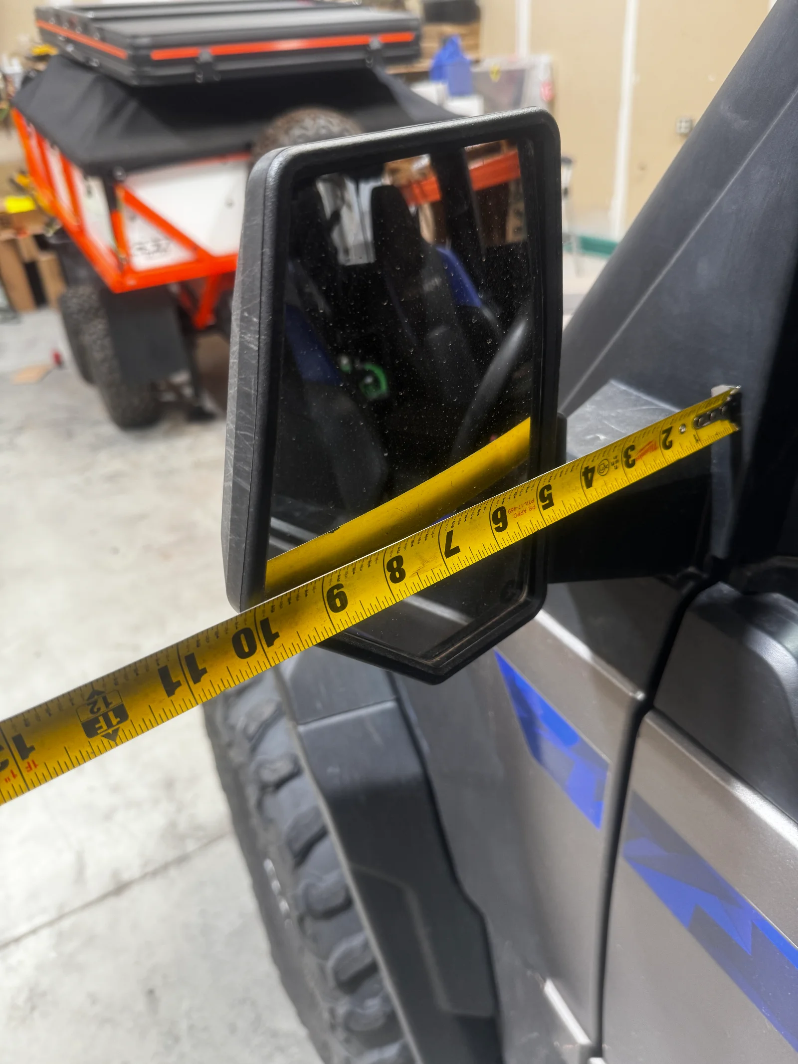

0 miles so far. Just adding accessories. Still looking for some type of side mirror that doesn’t look ridiculous.

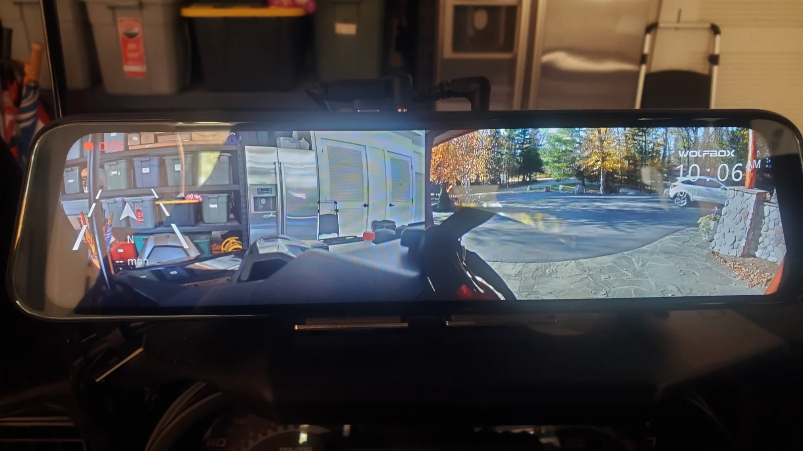

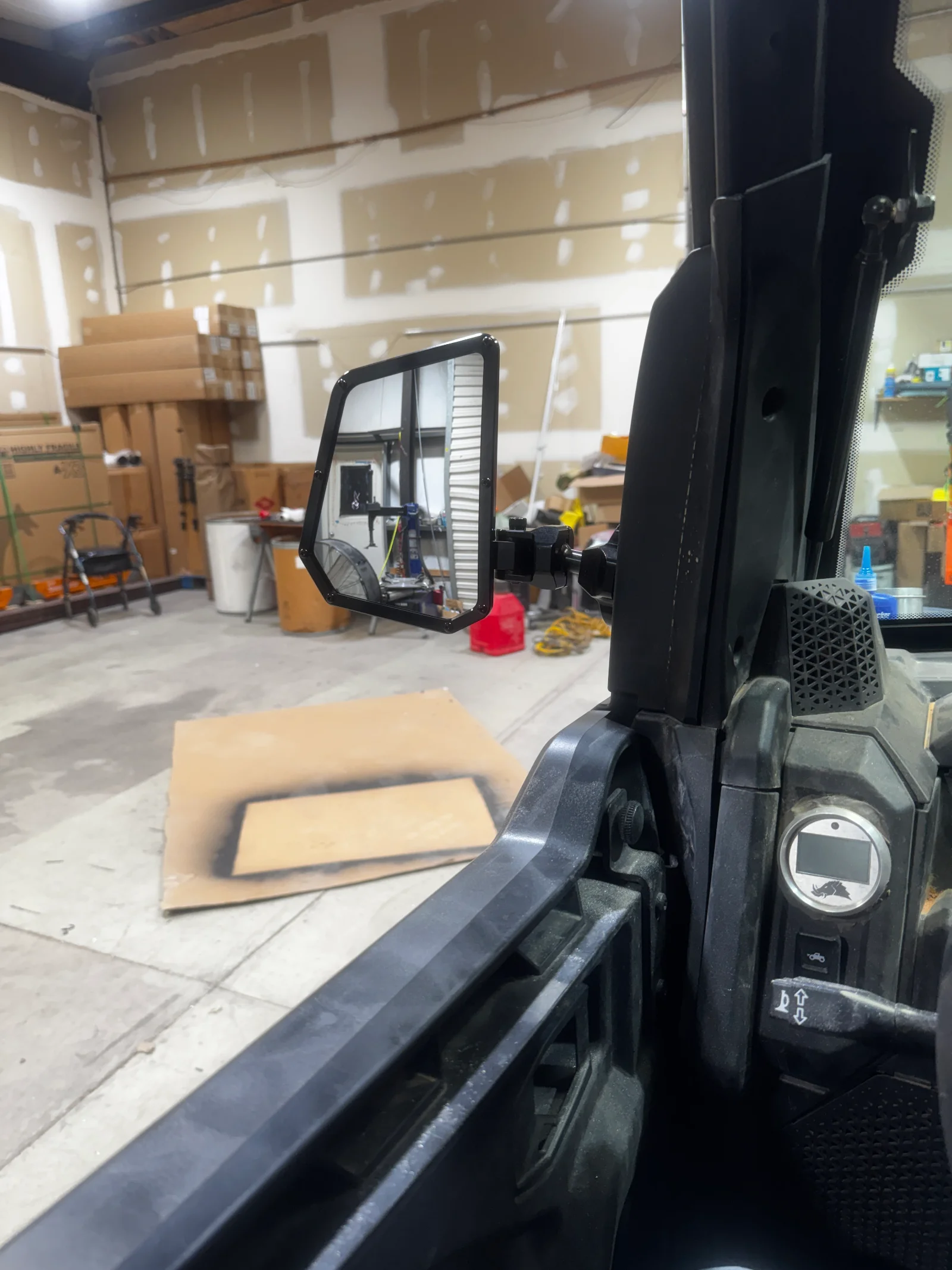

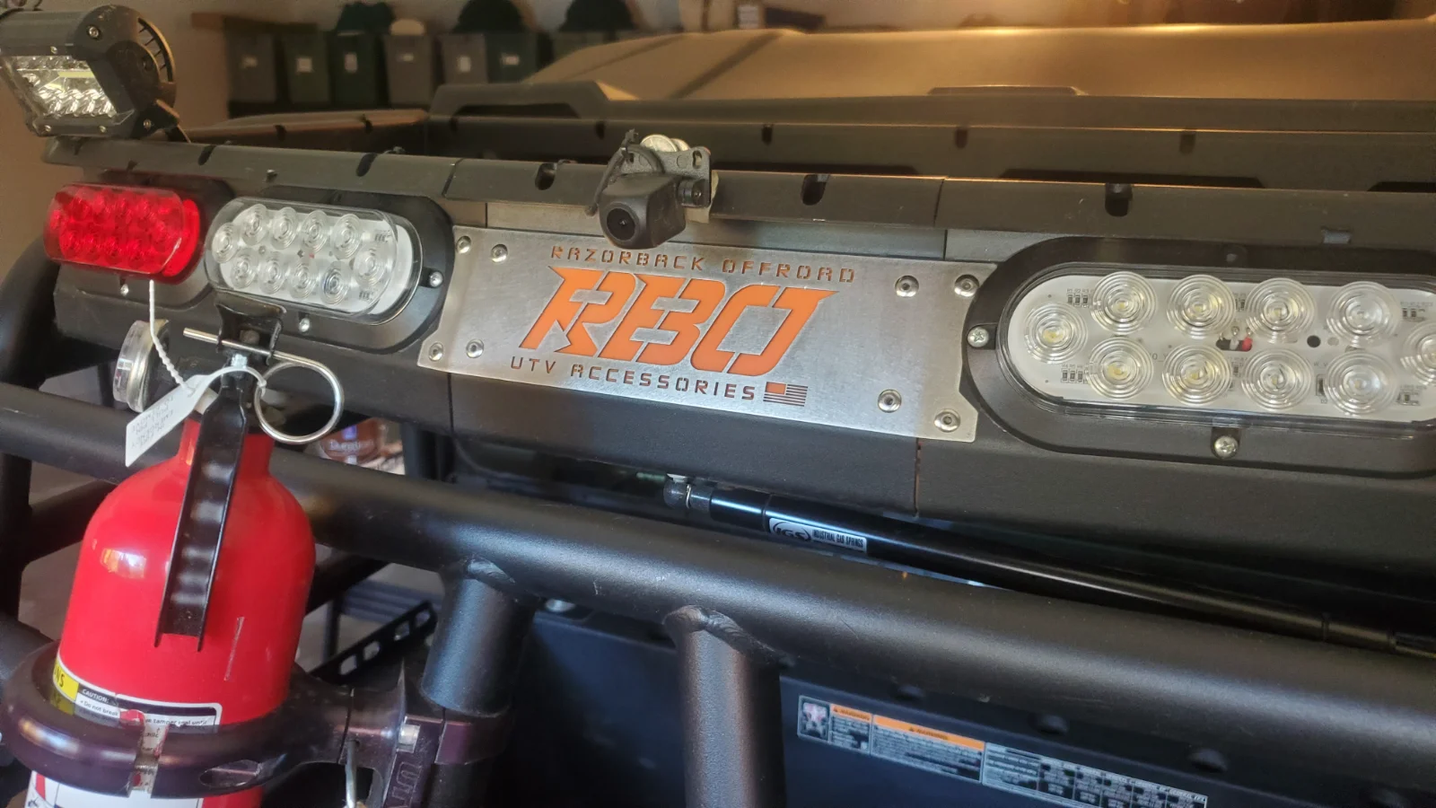

I have not bought my Expedition yet but I'm going to do the same thing I did on my general. I bought my general in the spring and mounted the rear view mirrors on the a pillars then when winter came and I put on the canvas & window enclosure and they interfered with the rear view mirror so I took them off and replaced them with a wolf box digital rear view mirror. You mount the camera in the back and I mounted the actual mirror directly in front of the steering wheel. Having it mounted in front of the steering wheel allows you to just glance down rather than to have to look up and to the side. It also blocks less of the windshield. Here in Minnesota we ride some pretty tight trails and the mirrors hanging off the side of the rig just created problems.
The first picture shows the rear view mirror before turning it on. The second picture shows the rear view the third picture shows the front view the fourth picture shows the split view front and back and the fifth picture shows the camera.

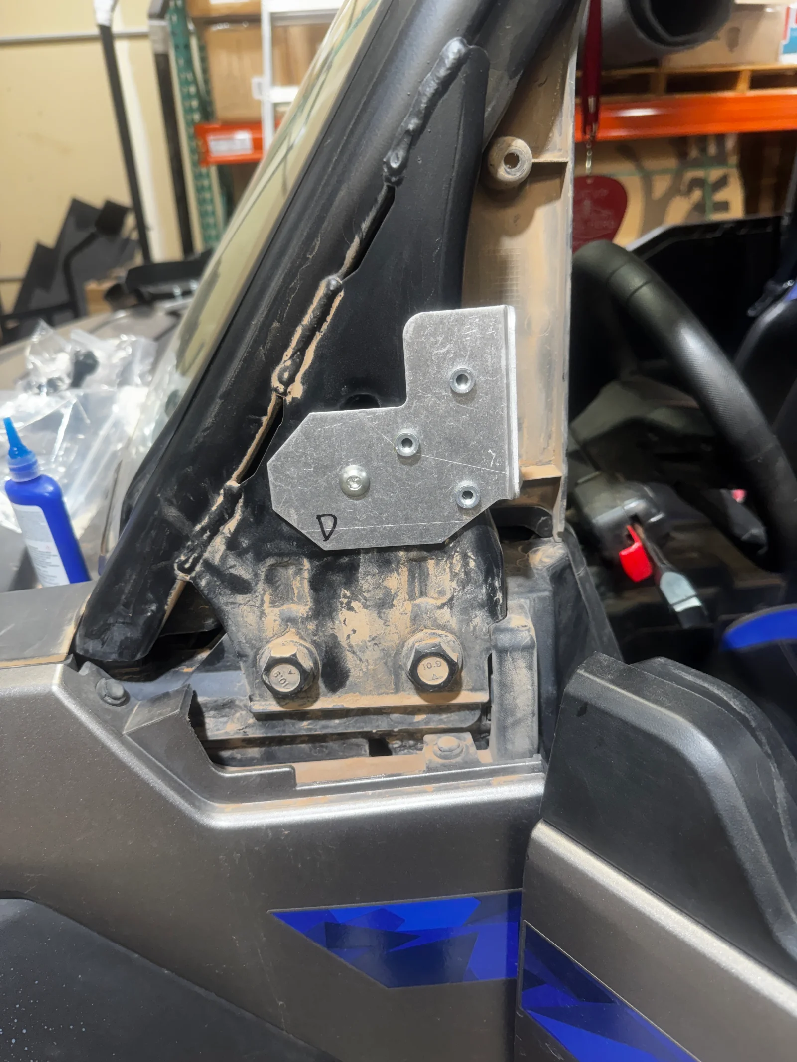

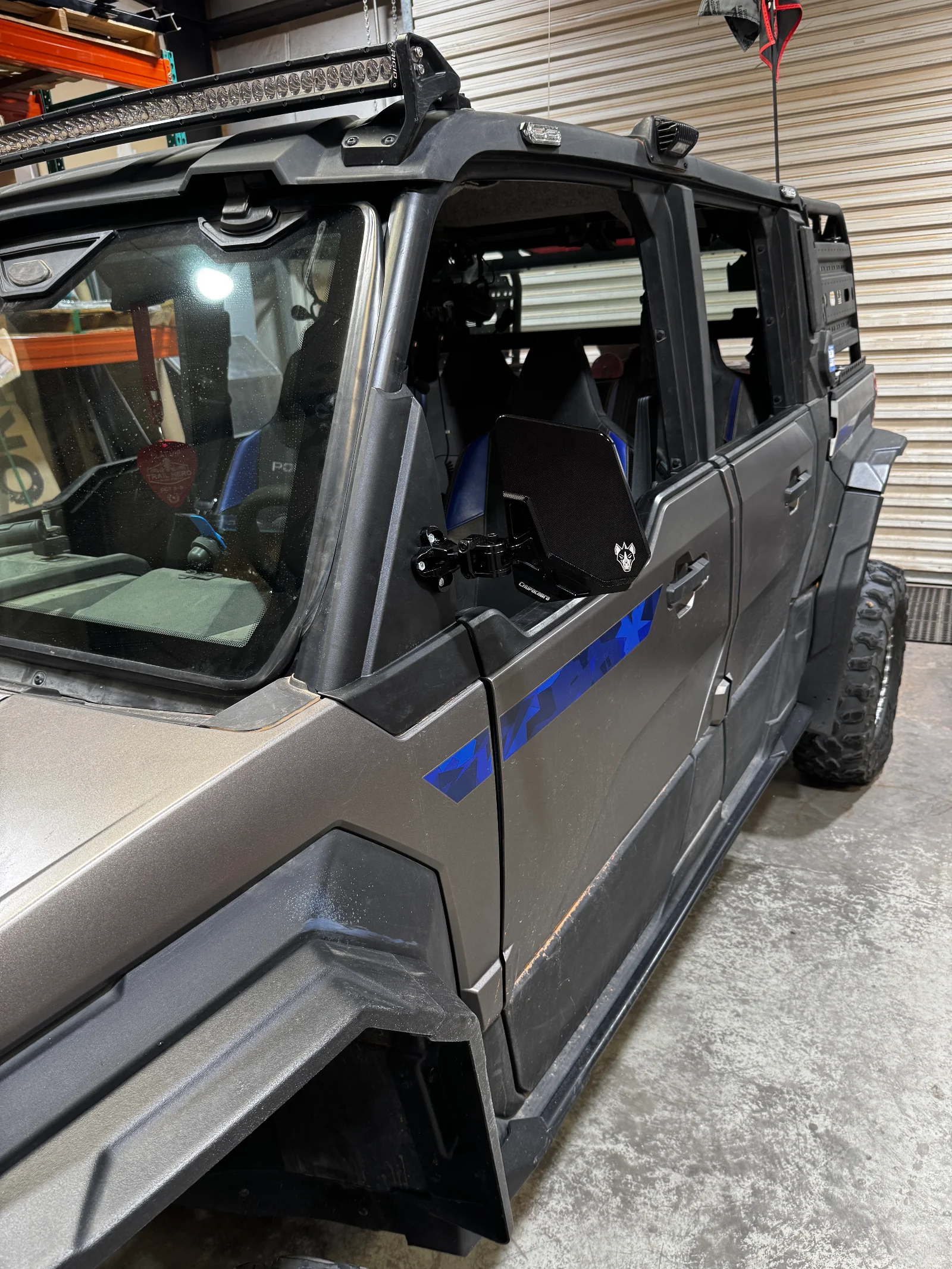

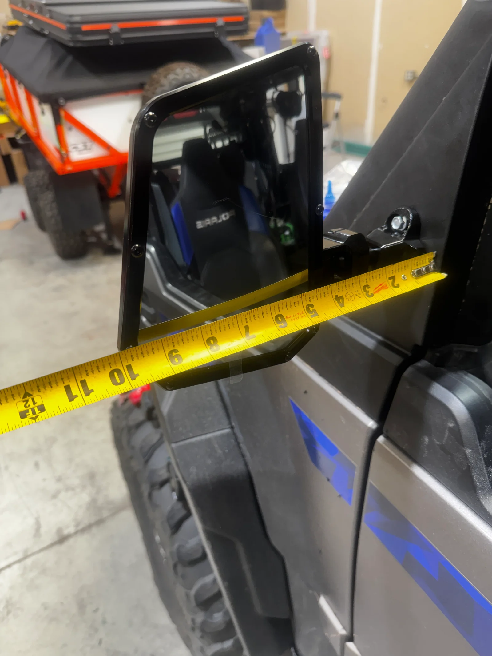

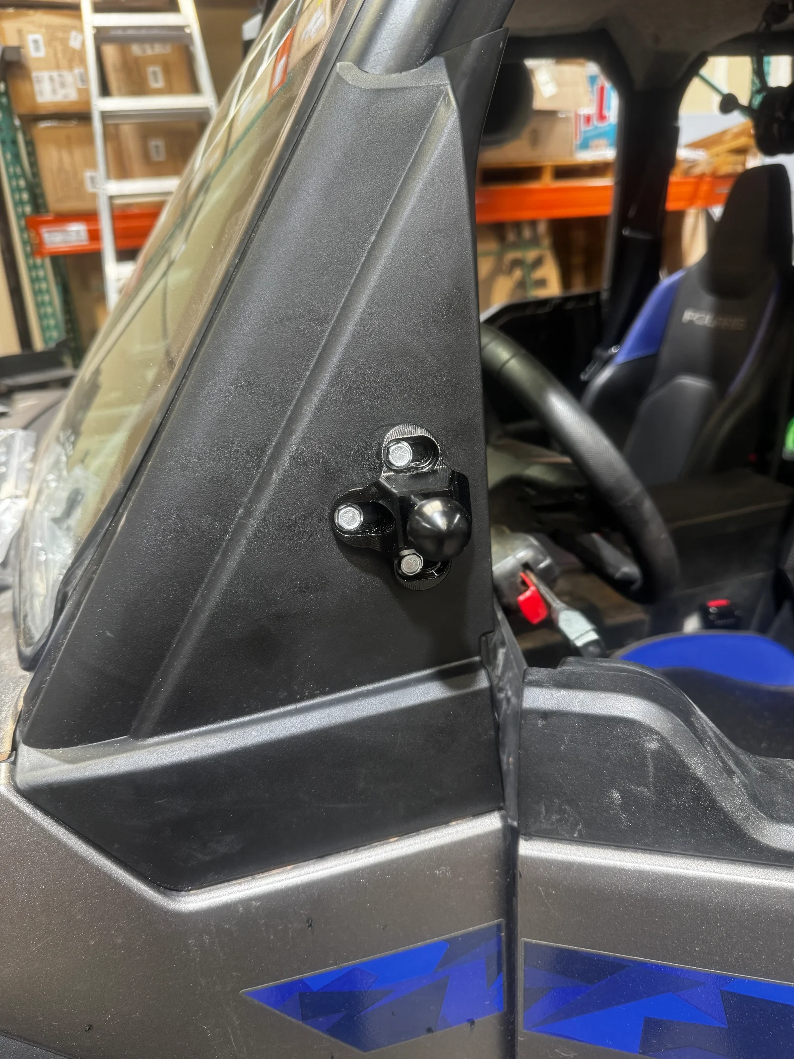

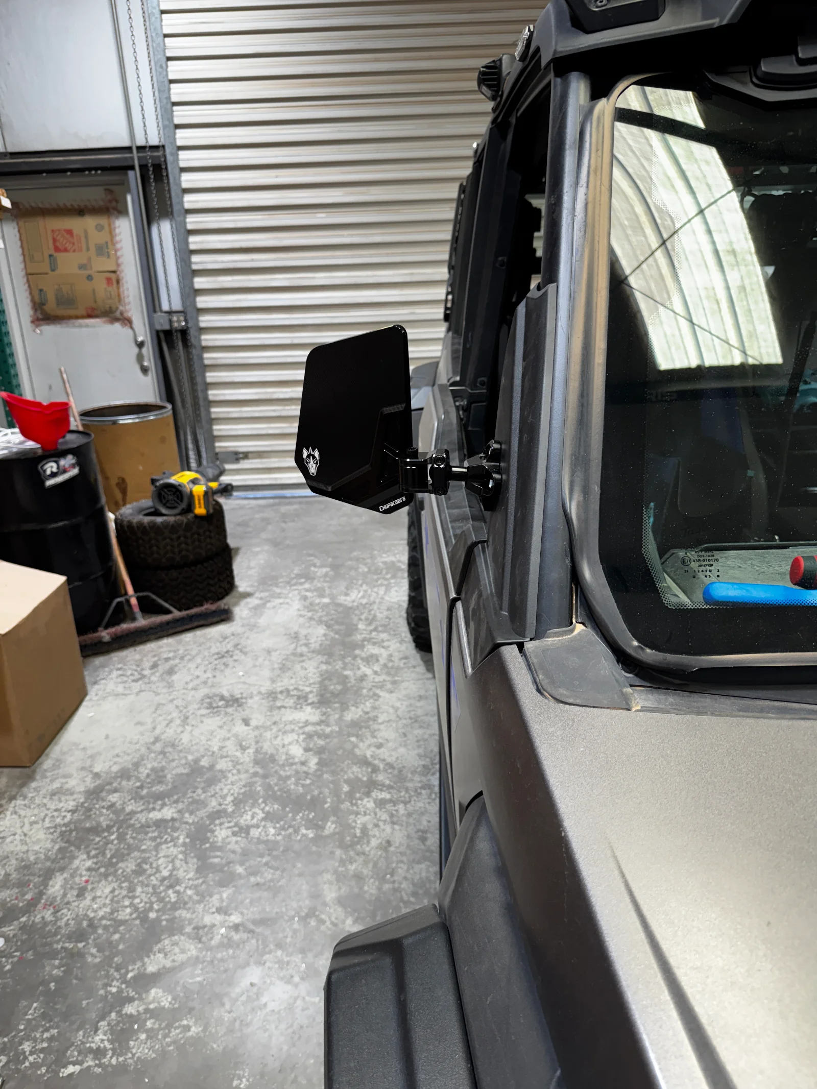

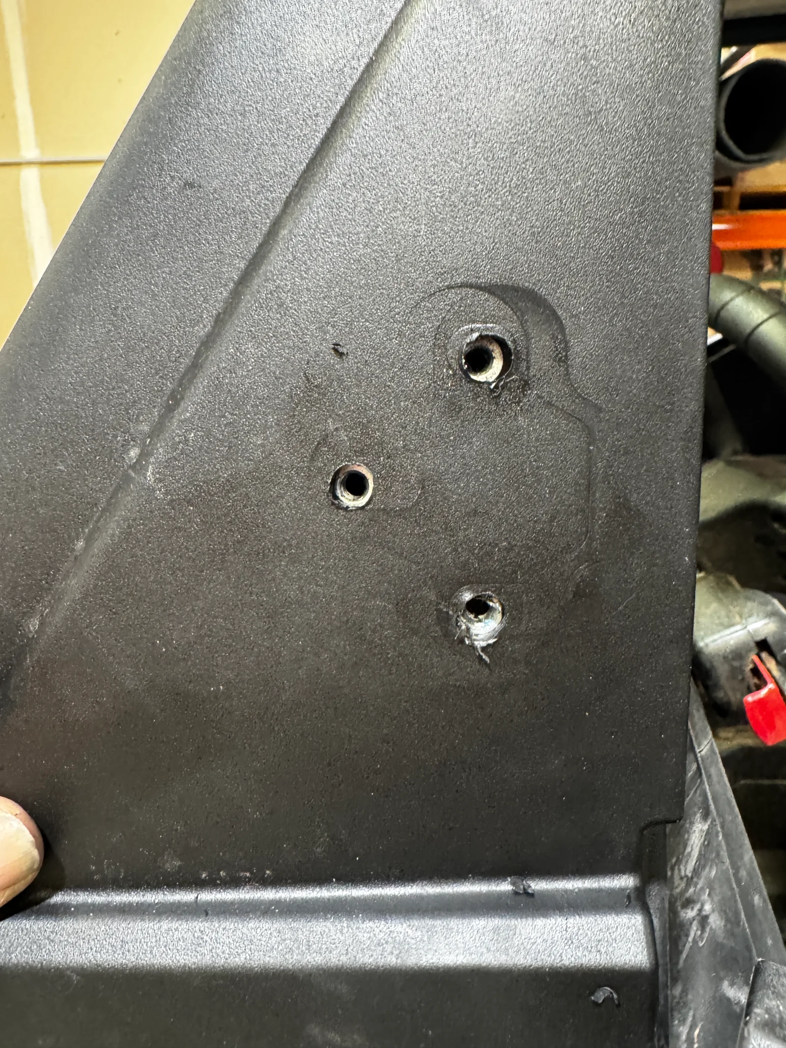

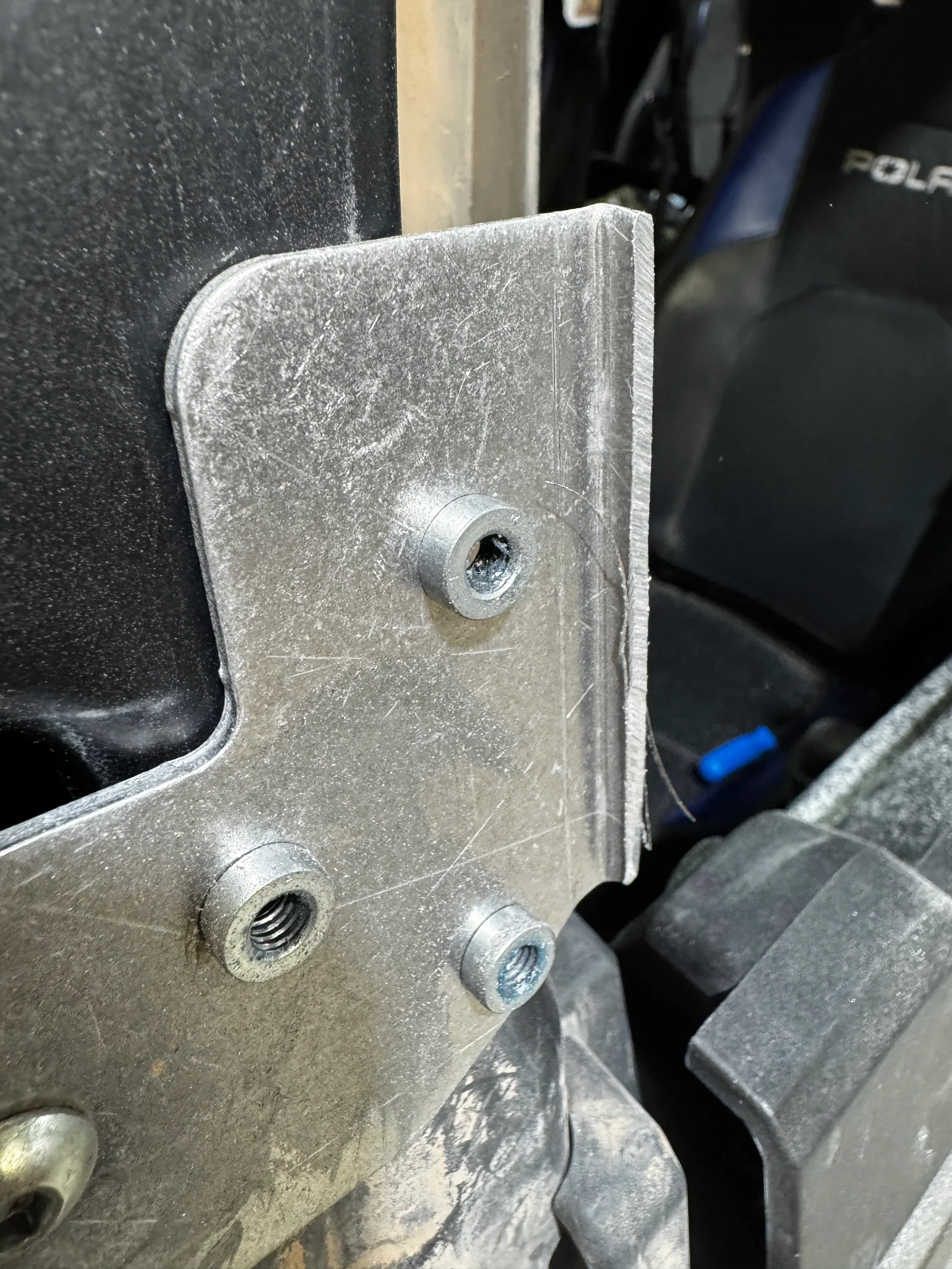

Just finished installing the Chupacabra Cuero UTE mirrors on my Xpedition. Overall, they look great and have way more adjustability than the Polaris side mirrors.
Installation is a bit tricky (some of it shown in the video above). But also because Polaris welding jigs can be a way off sometimes. As it turned out I had to grind the lips down on both sides, where they’re bent out. They were holding the plastic panels out too far. Also, all the bolts were 3mm-5mm too long. Since I didn’t have proper length ones handy, I just cut off the ones they sent.
Fit and finish, once they’re installed, is excellent. They look very clean on the machine.
With the standard price of the Cuero UTE Mirrors and Xpedition mounts at $220 and replacement glass at only $8… there’s really no reason to ever get the Polaris mirrors again.
