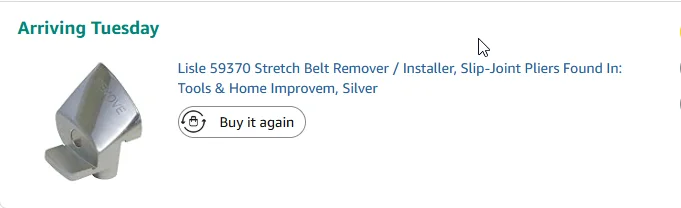

I bought a spare alternator belt to carry. Anybody installed one yet? EPI makes an install tool but it's been on backorder for months. On Amazon they sell these. Anybody tried one?

Ppppfffttt...I got this one. Didn't look like it would work. Made contact with EPI and learned I needed their BRT3 tool for the Xpedition.

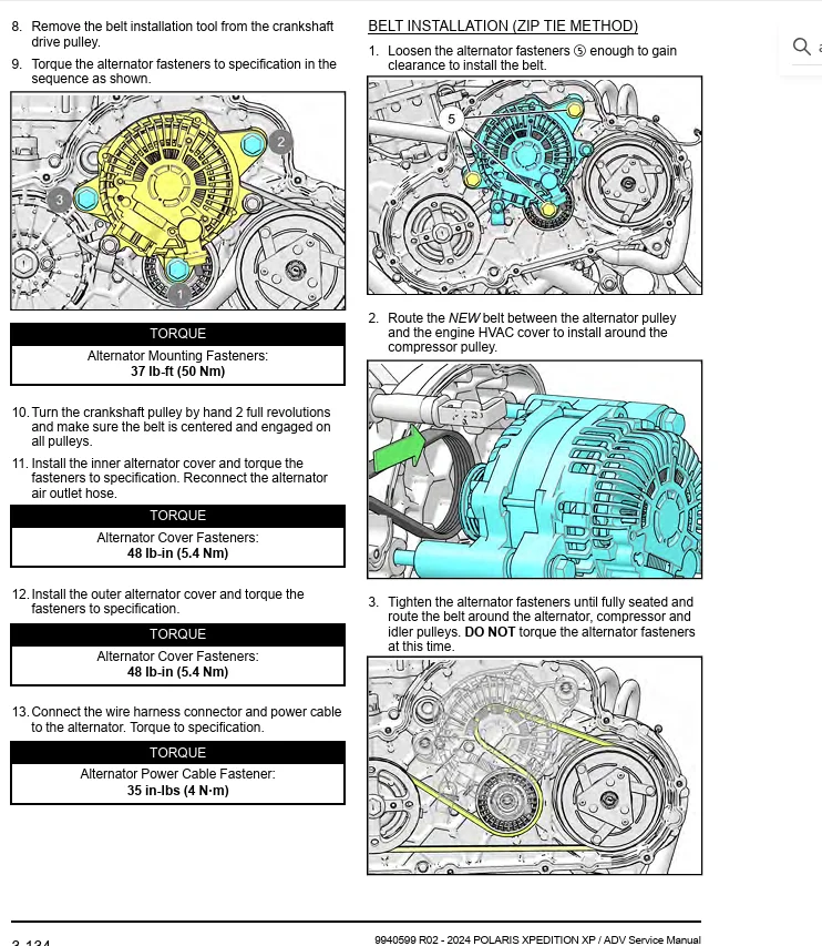

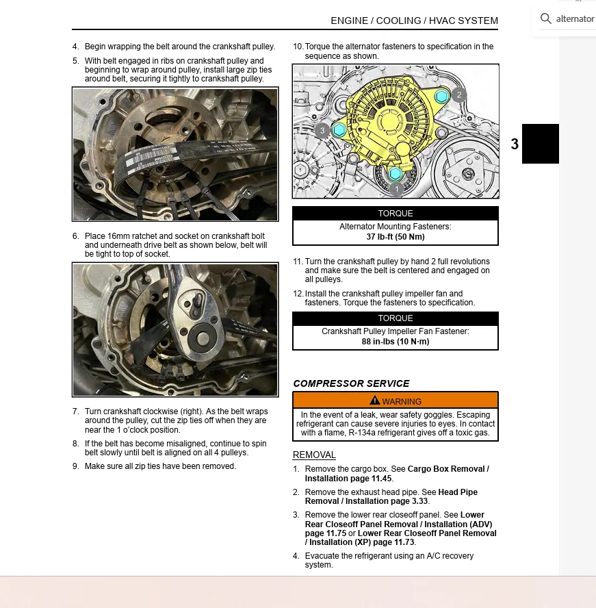

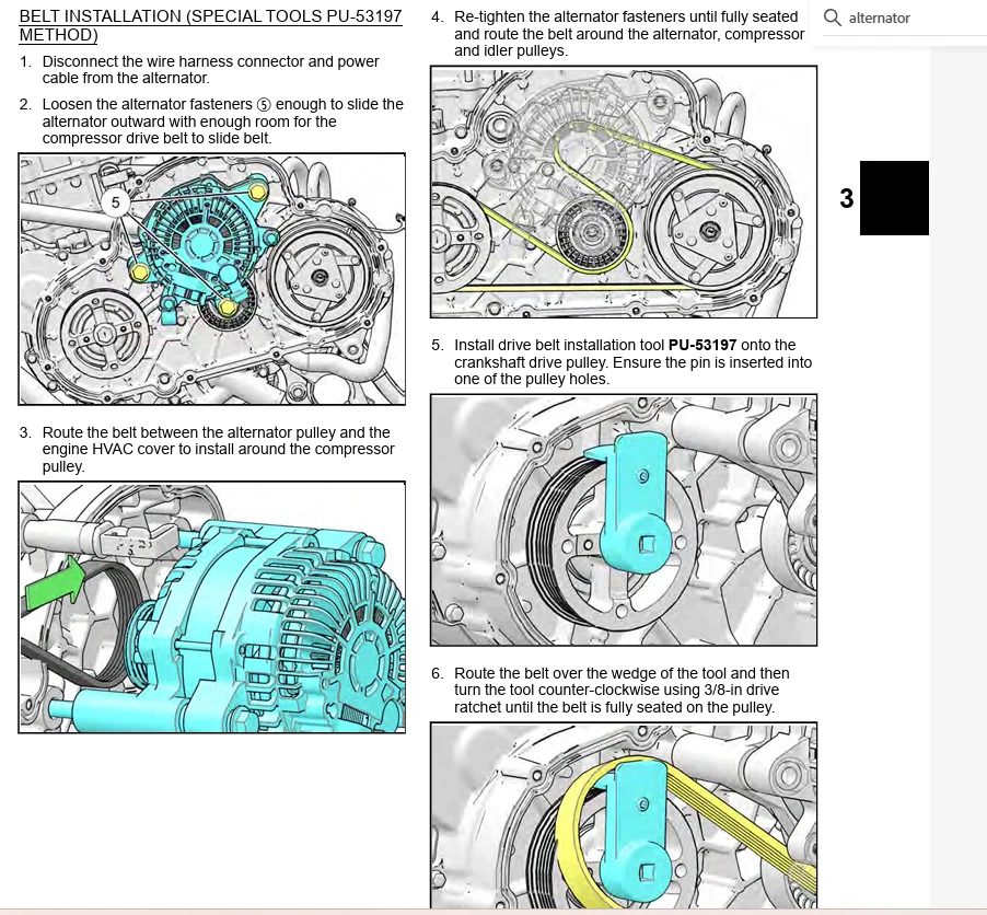

So I have been researching this. A post on the Ranger HD1500 forum (same belt setup) says the Lisle tool will not work. Then in the Polaris service manual they have there own special tool. The EPI BRT3 is just a cheaper version of the Polaris tool. Then the service manual shows two ways to install the belt. One with the special tool and the second with zip ties. Attached a few pixs
I'm going to return the Lisle from Amazon.
