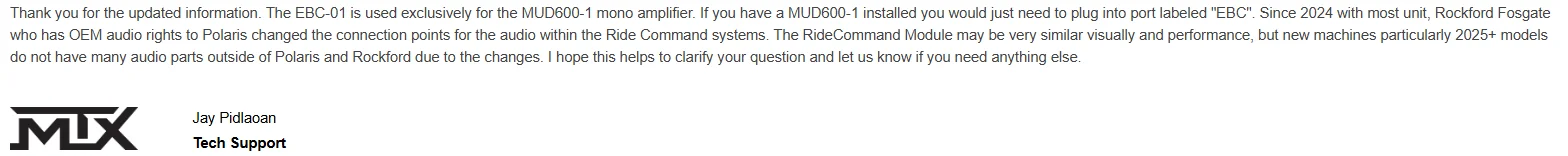

OK, the thump of the bass in my Xpedition is just too much. So I purchased an
MTX
EBC-01 External Bass Control
Designed for use with MUD600-1
Looking at the lower Driver side speaker on it is JBL red label.
I contacted MTX. This is the reponse I received:
Can you inform me what this means? And is do I have a MUD600-1? What is the EBC-01 that is mentioned?
And lastly, do I have the correct MTX kit. I now see the Rockford Fosgate words, I that the actual stereo device?
Thanks to much to all!
