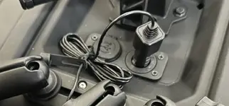

One of the drawbacks of the Xpedition cockpit is the lack of storage space. In other side by sides, you can install door bags to get that storage space. Time will tell on how we get it in an Xpedition. So, Polaris came out with their RAM Mount for the Phone. I had it install as they said to, but I had a backing plate added to strengthen the mount. I'll eventually install the SDR Motorsports mount that they displayed at the Sand Show when it produced. In addition, I had a triple USB device (1 standard USB and 2 C ports) and a 12-volt socket installed to power the phones and the GPS. I put those Items on a switch so I could have power when the vehicle is shut down. Since both those devices came with in-line fuses, I had a fuse block and a 100amp Thermal Circuit Breaker installed. Nothing worse than something going wrong, and it's raining, and you have to find that damn fuse. No more, just look under the hood.

The wires were run from the back of the 2 devices (12v plug-in and USB plug), to an on/off switch on the bottom row of the vehicle panel, then through the firewall at the vacant hole Polaris provided to run wires (Polaris Access Port), to a fuse block protected by a circuit breaker.
I like how your power sources were mounted. Did you build the plate to mount both of the charging devices Or did they come togethe? If so could you tell me where you purchased? thanks for your time.
Actually, I bought this: https://www.amazon.com/gp/product/B0BDK455B2/ref=ppx_yo_dt_b_asin_title_o05_s00?ie=UTF8&psc=1
and this: https://www.amazon.com/gp/product/B09PDBWWDR/ref=ppx_yo_dt_b_asin_title_o05_s01?ie=UTF8&psc=1
and then swapped out parts to get the desired result I wanted.
