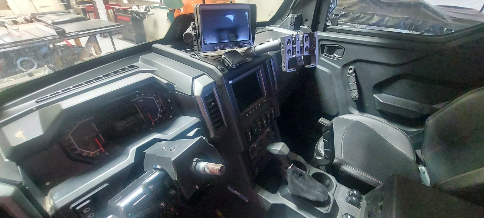

I like the tackiness of a suede wheel. I've had them on all my RZR's in the past. It's off-road show season in southern Utah so got a discount on a nice replacement. This past weekend saw this thread on removal, and followed suggestions... The red lock tight was a bear to get the nut to move. I did old MC tie down straps on either side of the wheel spoke to the seat mount on one side and the wire hole in upper roll bar on the other, this held the wheel steady for the breaker bar. I tried the rocking back and forth with no luck. Printed out the "steering column removal" from the service manual. Thinking HA, easy, just two upper frame bolts and the shaft bolt. Problem was reaching up under using only hand tools. My suggestion is, if you don't already have a power socket wrench, get one. After an hour of getting those 2 bolts off, it still took some whacks with a hammer to knock the plastic wheel off. The hardest part was getting the assembly back in. Holding one part with one hand trying to fish the bolt through. I found using a drift pin on the other side held it up. And I should have picked up an electric wrench at that point, but didn't... 3 clicks at a pull takes a lot of time, it's not hard but tedious. And the plastic edges on the dash are sharp. Didn't bleed at the time but the scabs that formed the next day say otherwise. Did a couple street laps to make sure it was centered and strait before I torqued the wheel nut tight. Hope this helps others on replacement.
