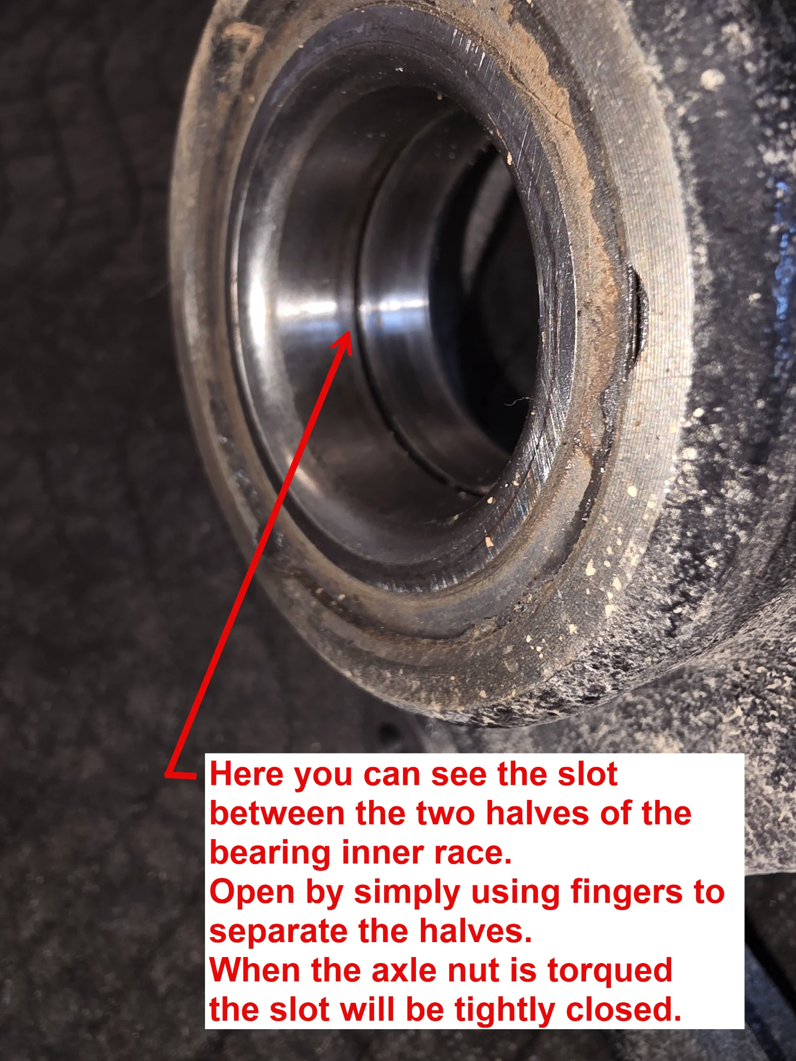

This photo shows an Xpedition front wheel bearing pressed into the Bearing Carrier.

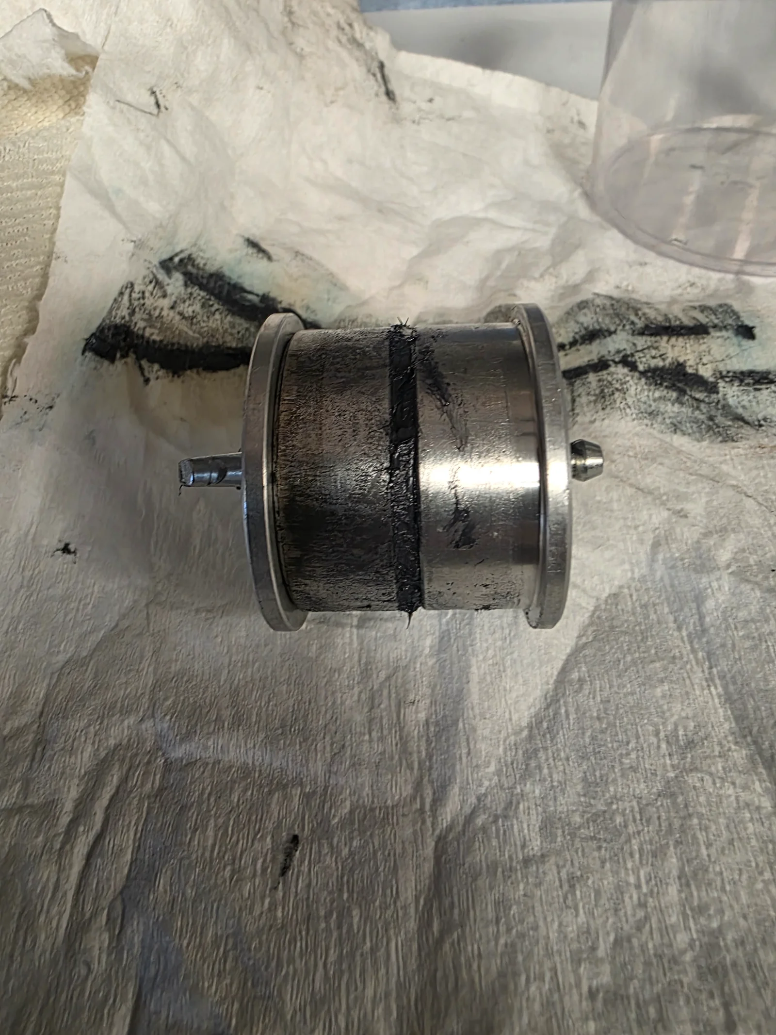

This is the top of my tool: It's available from TwoGuysHobby.com Designed for 44mm bearings.

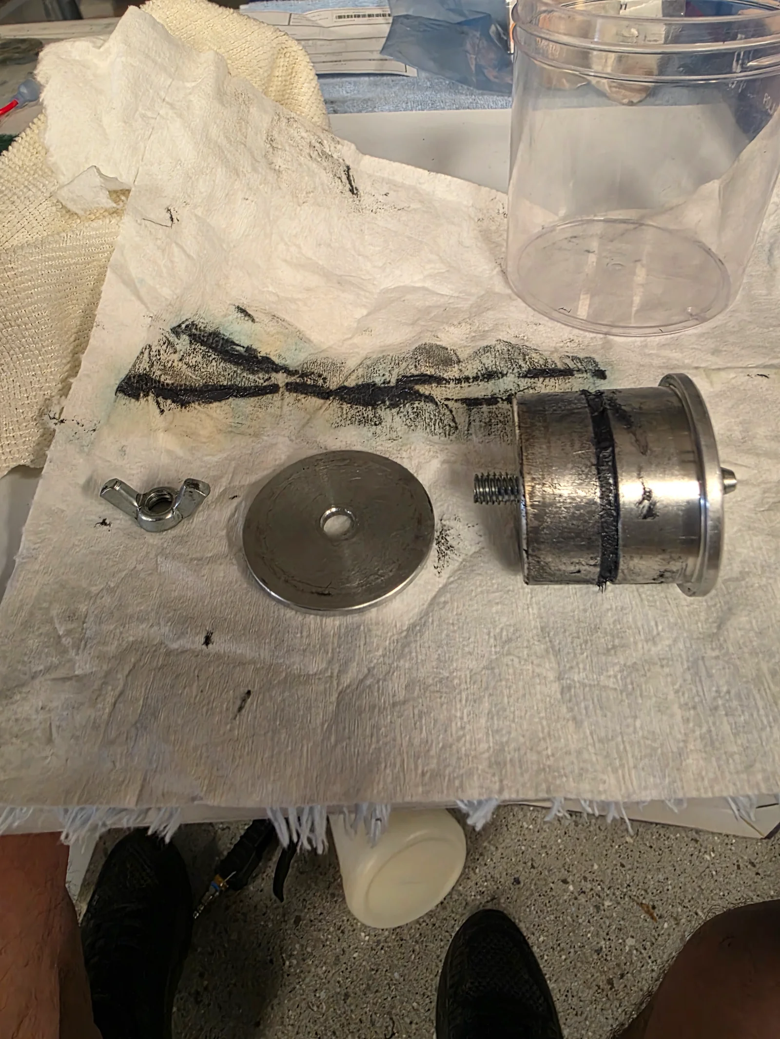

These are the components. The greaser. Note the groove, full of grease, at the middle. This is where the grease comes from and
goes into the bearing. Then a backing plate to keep grease in the bearing and a wing nut to hold the backing plate in place.
This is the grease I'm using. I use it on my Bobcat skidsteer and excavator for 26 and 23 years with no issues.
Hope this helps,

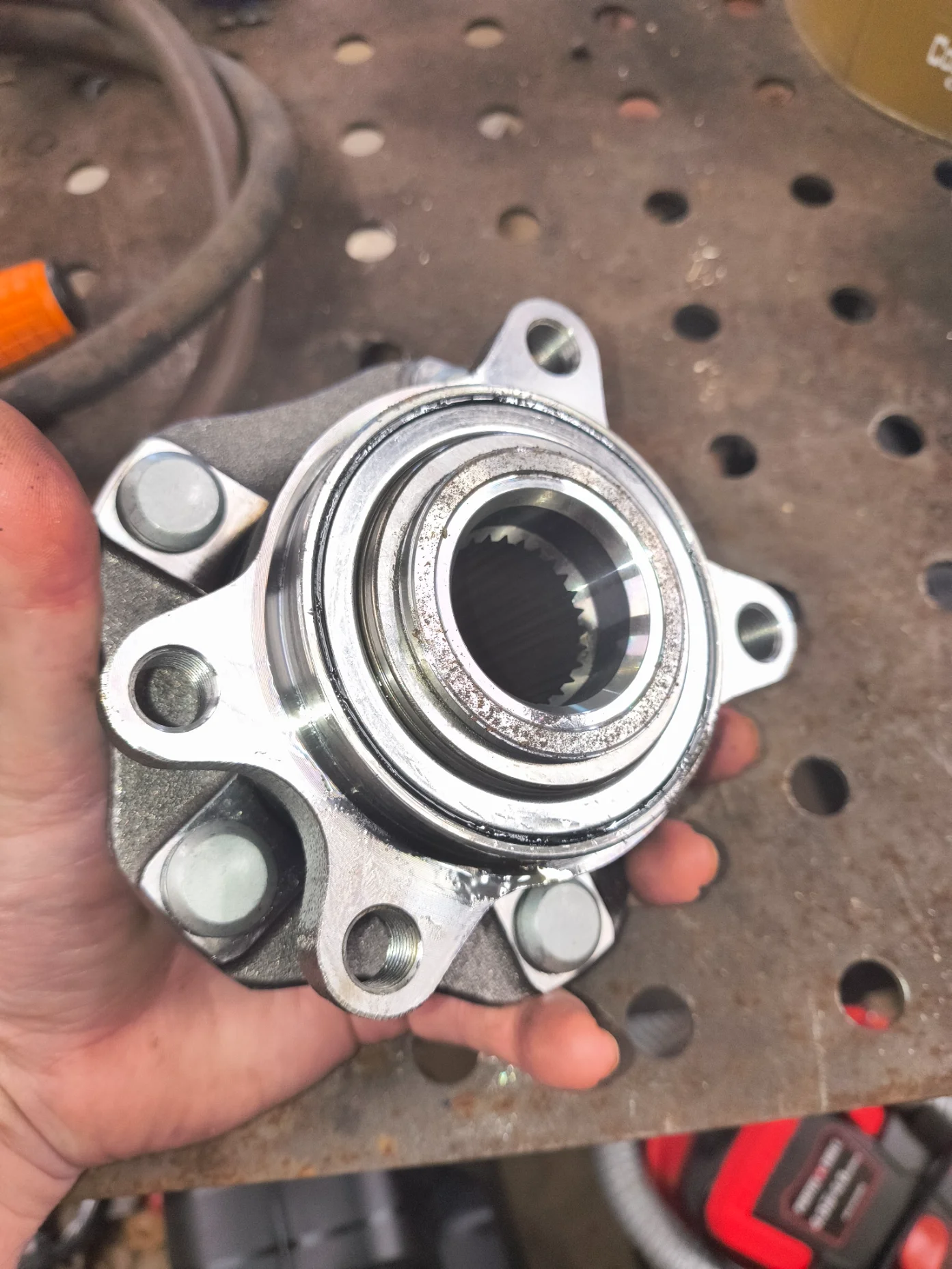

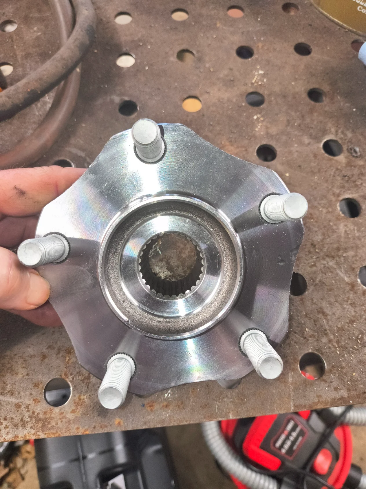

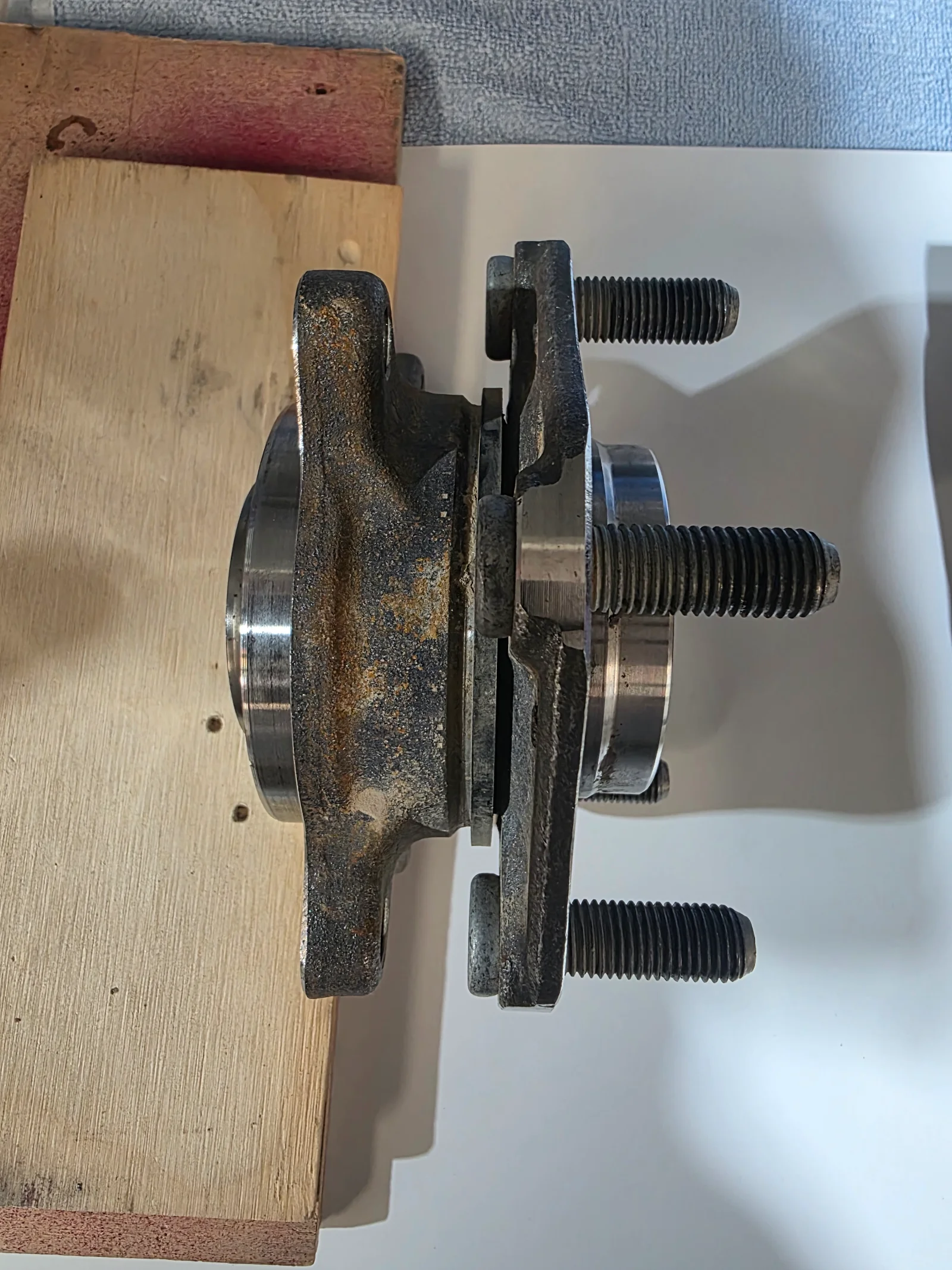

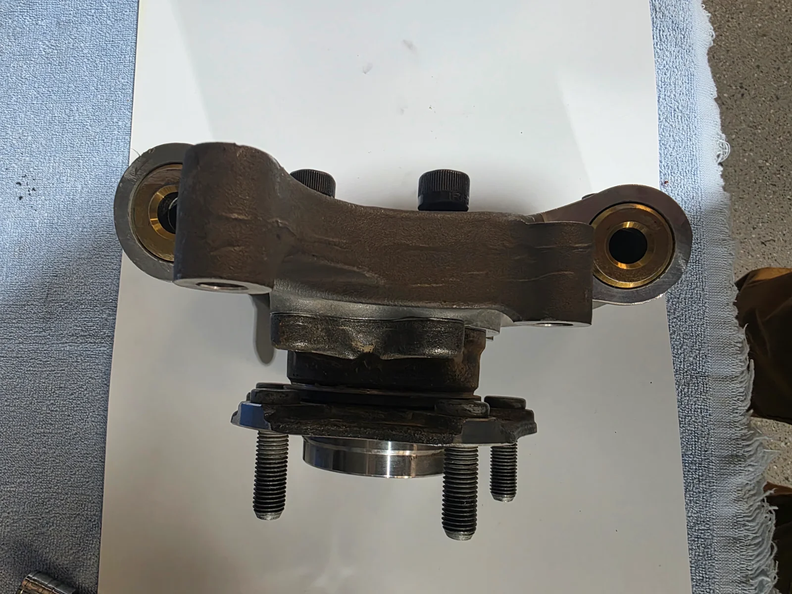

This photo shows you the "ASM - UNITIZED HUB" as sold by Polaris. There are three pieces.
The piece with the five studs is the front piece. The studs are the wheel studs. The brake rotor goes over them and then the wheel.
This piece rotates with the tire/wheel. The means of checking the bearing condition is to rotate the tire and feel for roughness.
The back piece has four threaded holes for bolting the bearing assembly to the Bearing Carrier.

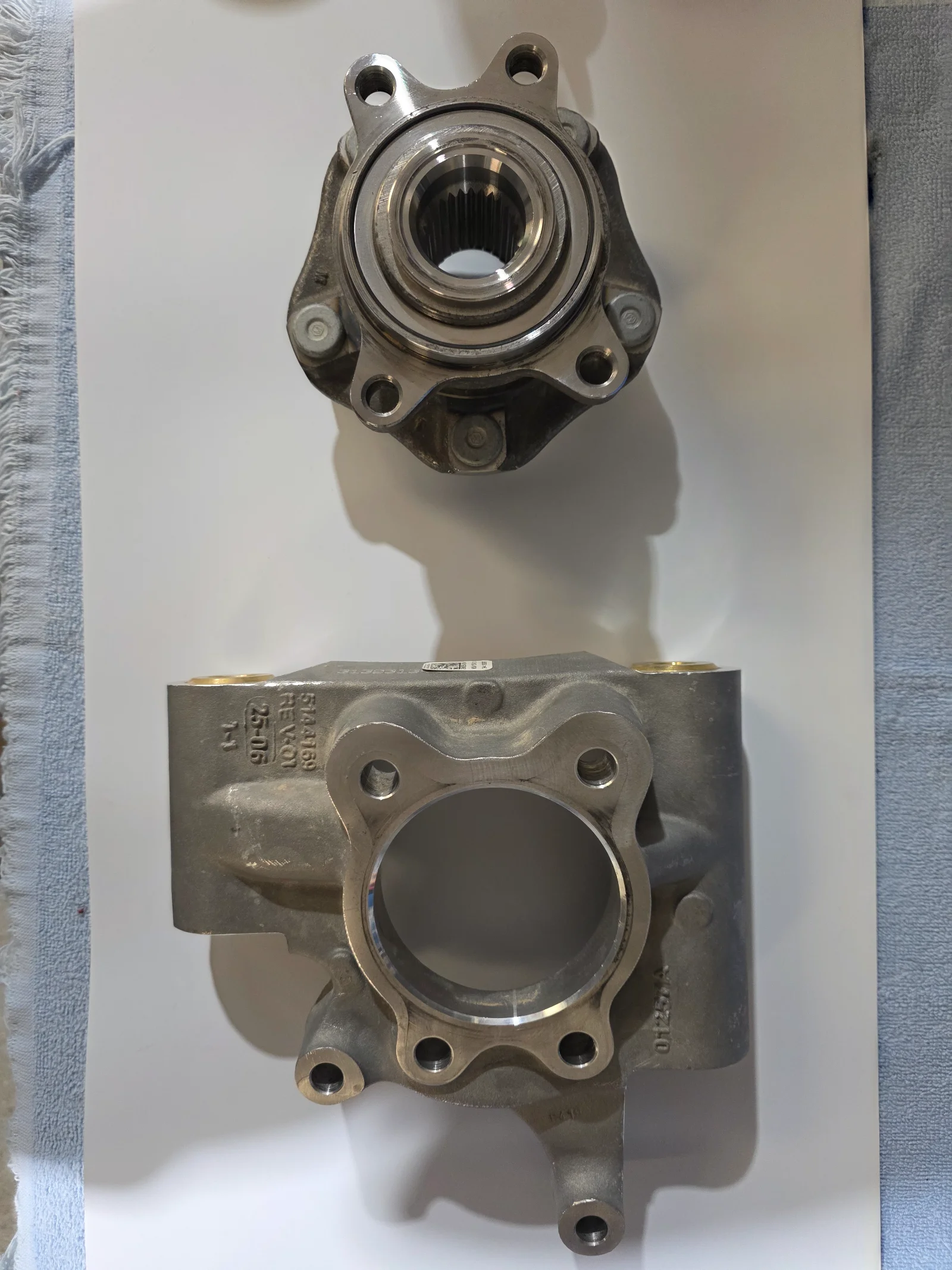

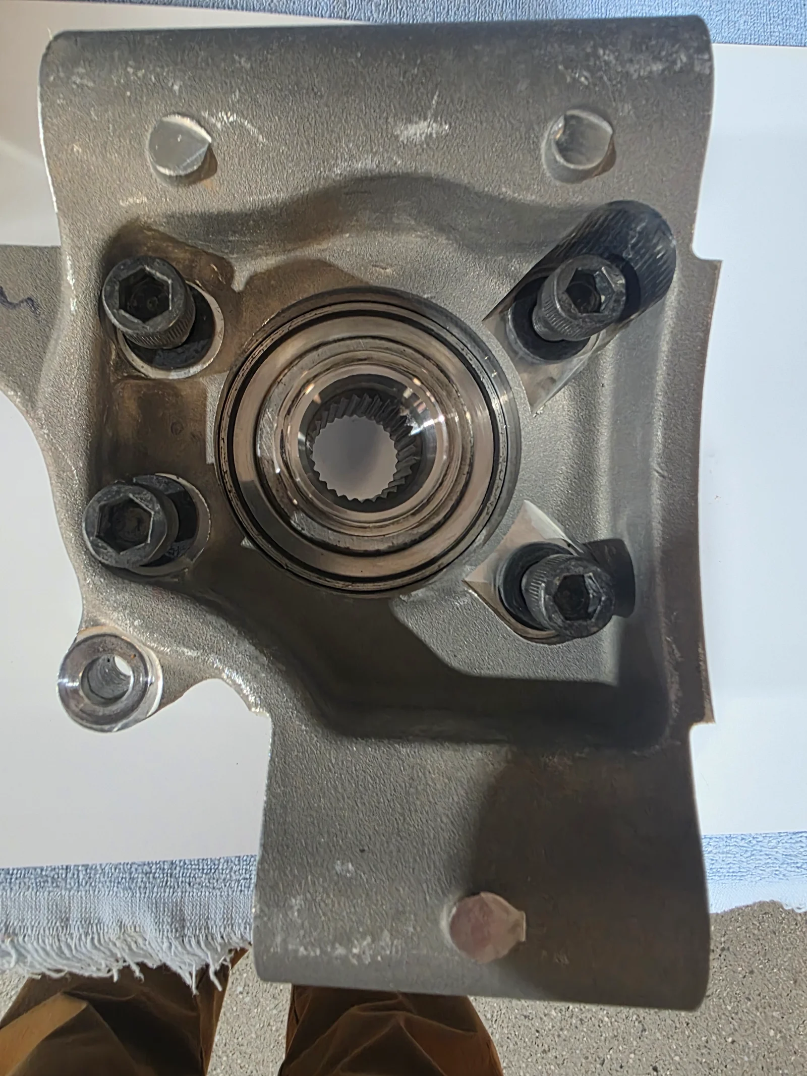

Here is photo of the Bearing Carrier showing the four bolts that thread into the back piece of the Wheel Bearing Assembly.
As one can see, there is no large snap ring to keep the bearing from backing out of the Unitized Hub Assembly.
My2026 Service Manual shows one can remove a large snap ring and press the Rearing Wheel Bearing out. Thus the Service Manual is not
correct as it shows the bearing can be pressed out. My 2026 and PolarisParts123.com show Polaris sells only the Unitized Hub Assembly for $209
I'm not going to try this until I have too!

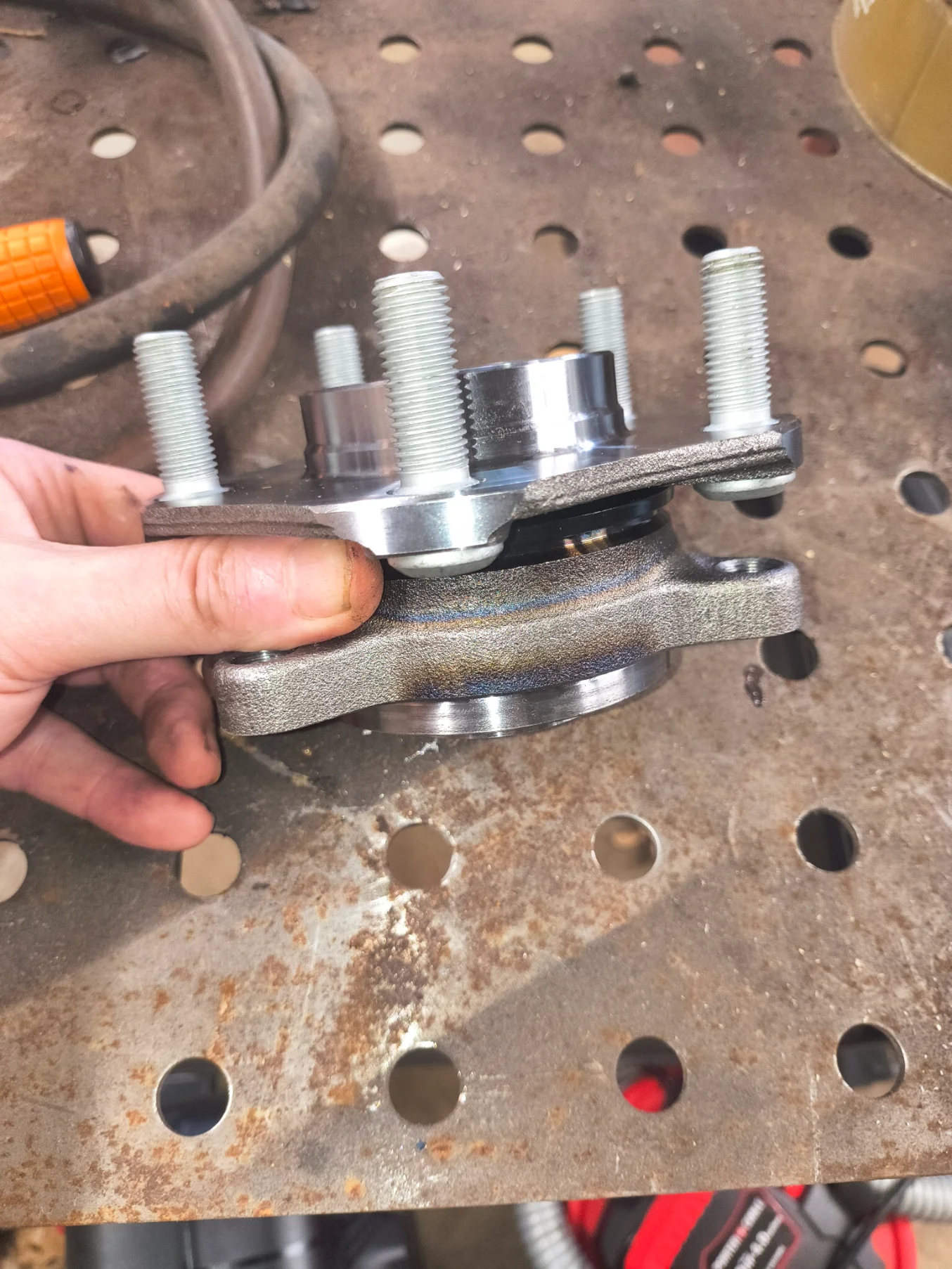

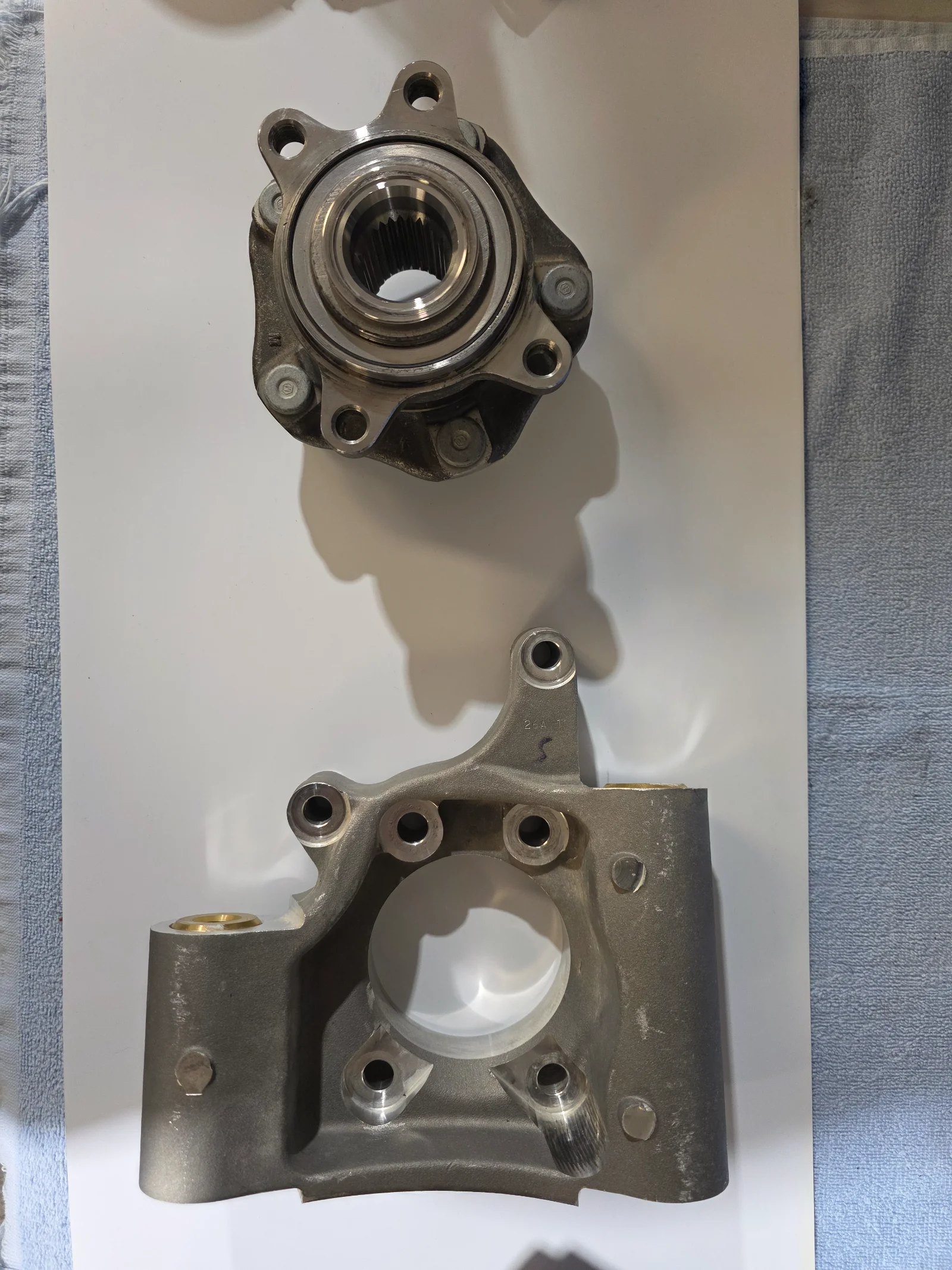

This photo is of a side view of the assembled Bearing Carrier and Unitized Hub Assembly:
Hope this helps explain things.
