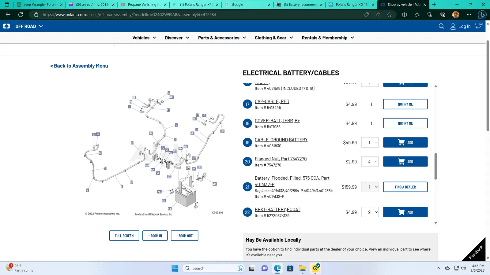

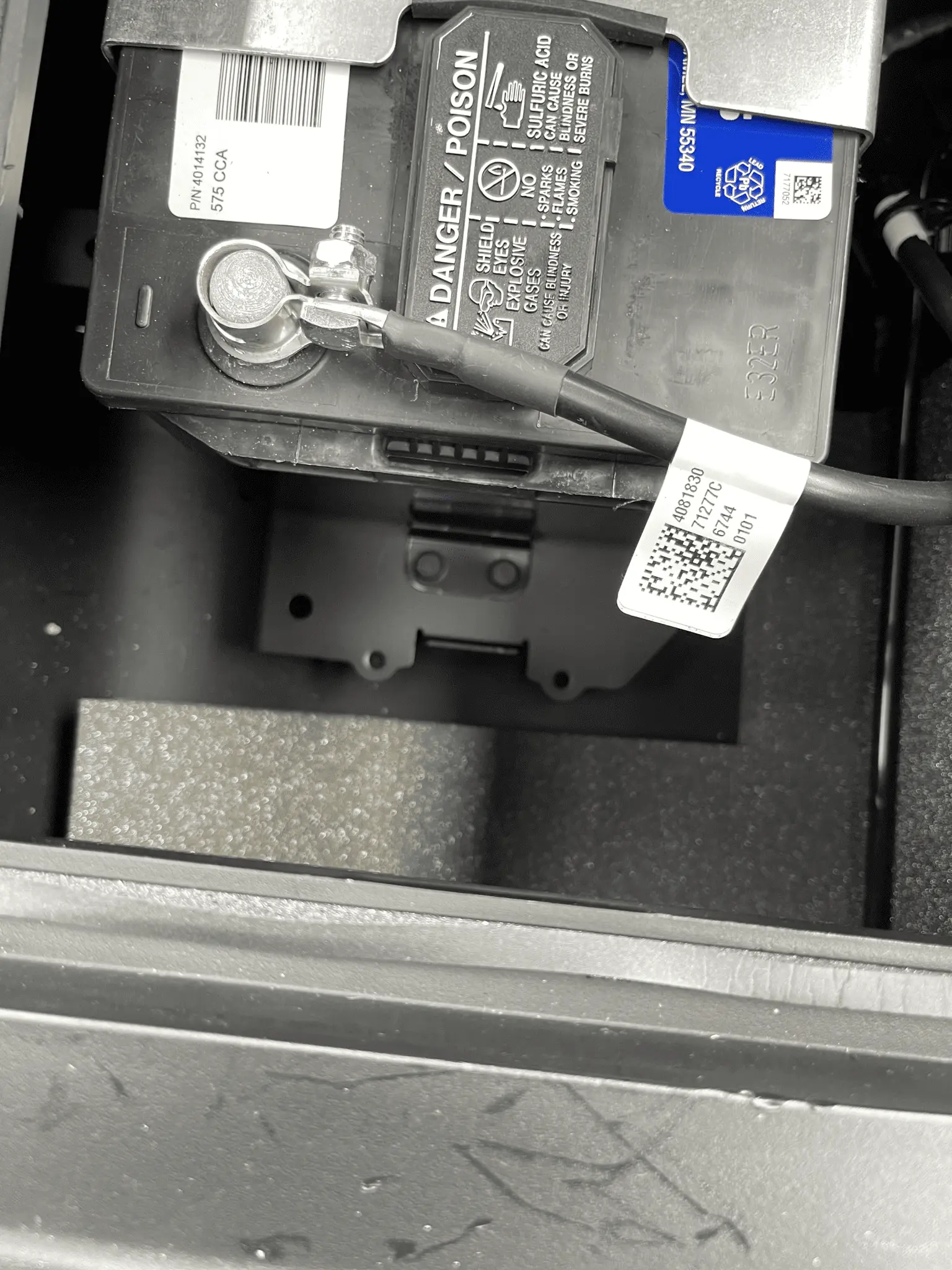

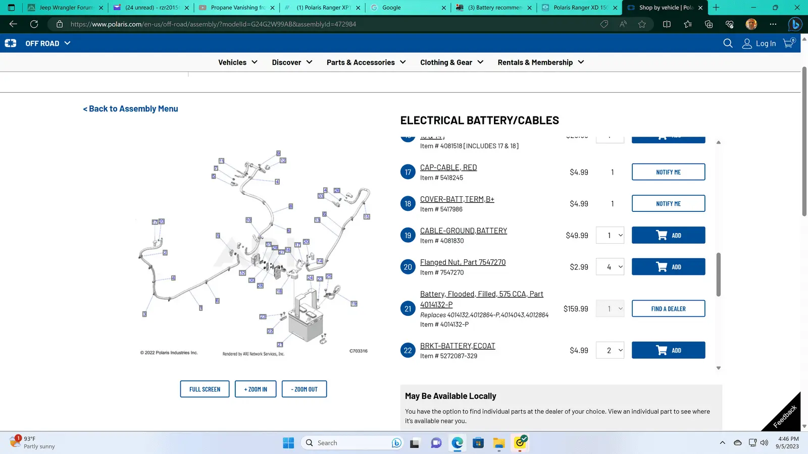

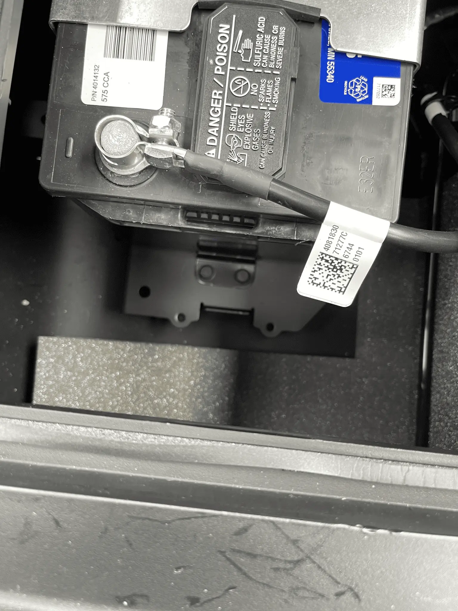

I looked the other day and its a lead acid battery- part #Battery, Flooded, Filled, 575 CCA, Part 4014132-P all expeditions come from factory like this.
Well this is strange. I went by the owners manual recommending to use an agm charger. I just checked my owners manual and there is no battery model info. Why they would recommend an agm charger for a flooded wet cell battery is beyond me. Are you saying you pulled the driver's seat and inspected the battery and it was flooded with removable caps?
This is from the Polaris site, from parts for the expedition, I also confirmed by looking in the battery compartment .
View attachment 546View attachment 547
Just gets more interesting. I saw that parts diagram and found it was from a Razer, at least that's the way it came up even though my Xpedition was listed. It was copyrighted 2022, another indicator its not for our machines. But your pic definitely proves we have flooded wet cell batteries and they want us to charge them with an agm charger. Wonder why??
Most likely the engineers wanted an agm battery and Corp said flooded, to save money.

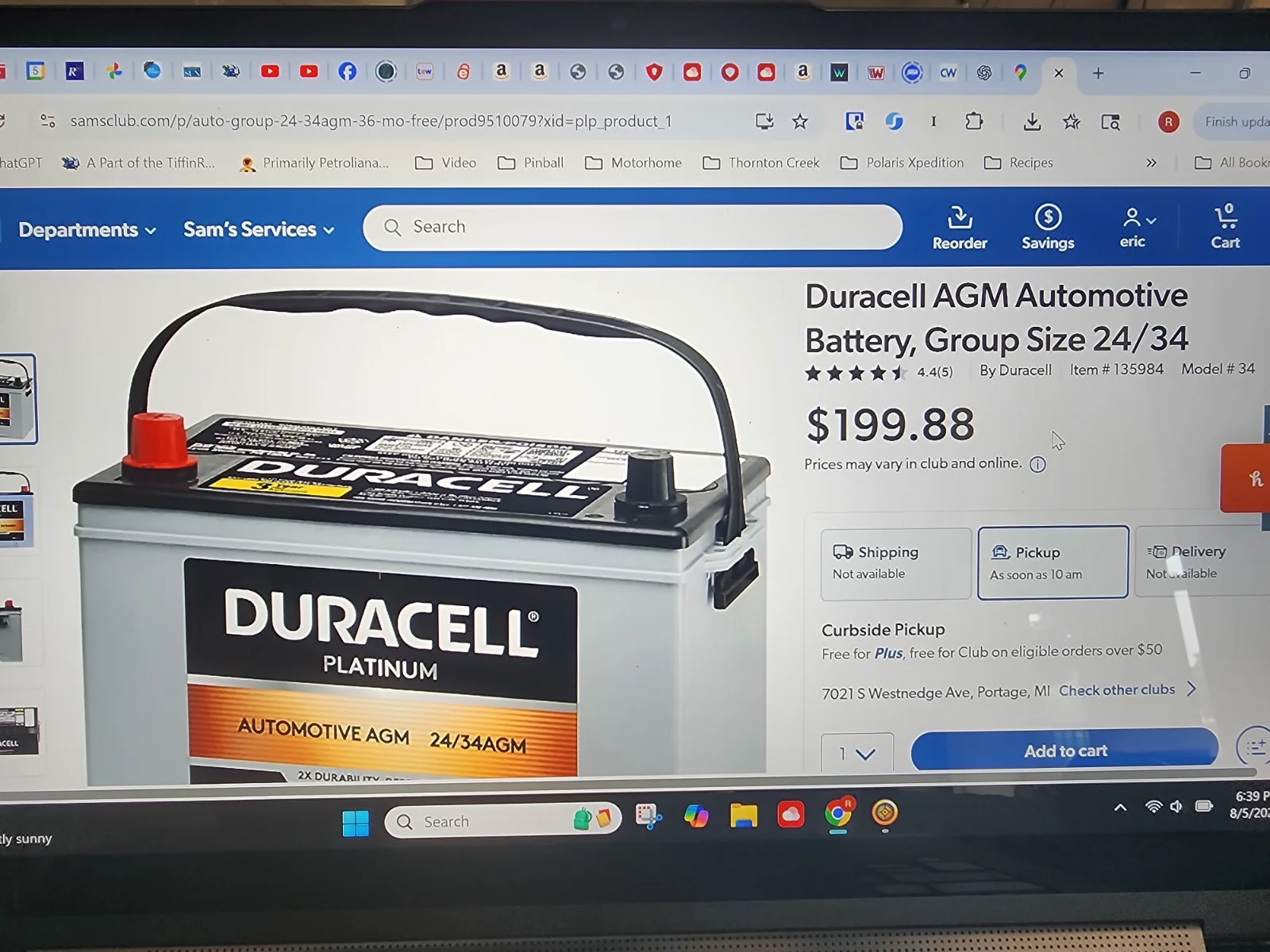

I put this agm battery in. Duracell from Sams Club. Made by Deka (East Penn). I use Deka batteries whenever possible. Good stuff.
