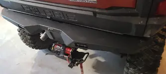

I put one on my Northstar and found it to be a tad bit of a challenge. It did not mention removing and discarding the drip edge under the bed. Then had to cut out a chunk of the heat shield to get to one of the mounting holes. But all in all it went on, looks bad azz, and the lights are great. Would recommend it. Versus ... nothing but plastic!
Here are a couple shots

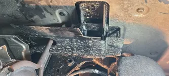

I agree. This screen capture shows two brackets, which the video says bolt the bumper to. One is above the installers hand with two holes in it, the other to the outboard of the red wire shown on the drivers side.
On my Xpedition XP5 these brackets do not exist; nor are they shown in the service manual on the cargo box frame exploded views.

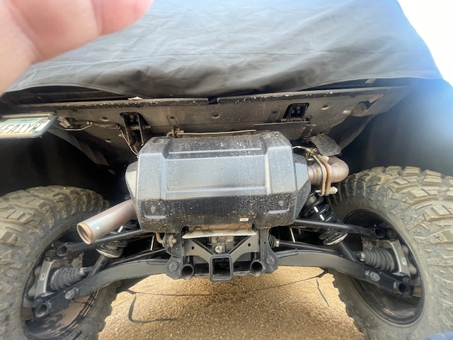

I got curious, so I took a photo of my XP5. Underside of box looks nothing like theirs. 🤷‍♂️
Wonder if Polaris made a late design change to remove the brackets? The Polaris "bumper" attaches a whole different way.
