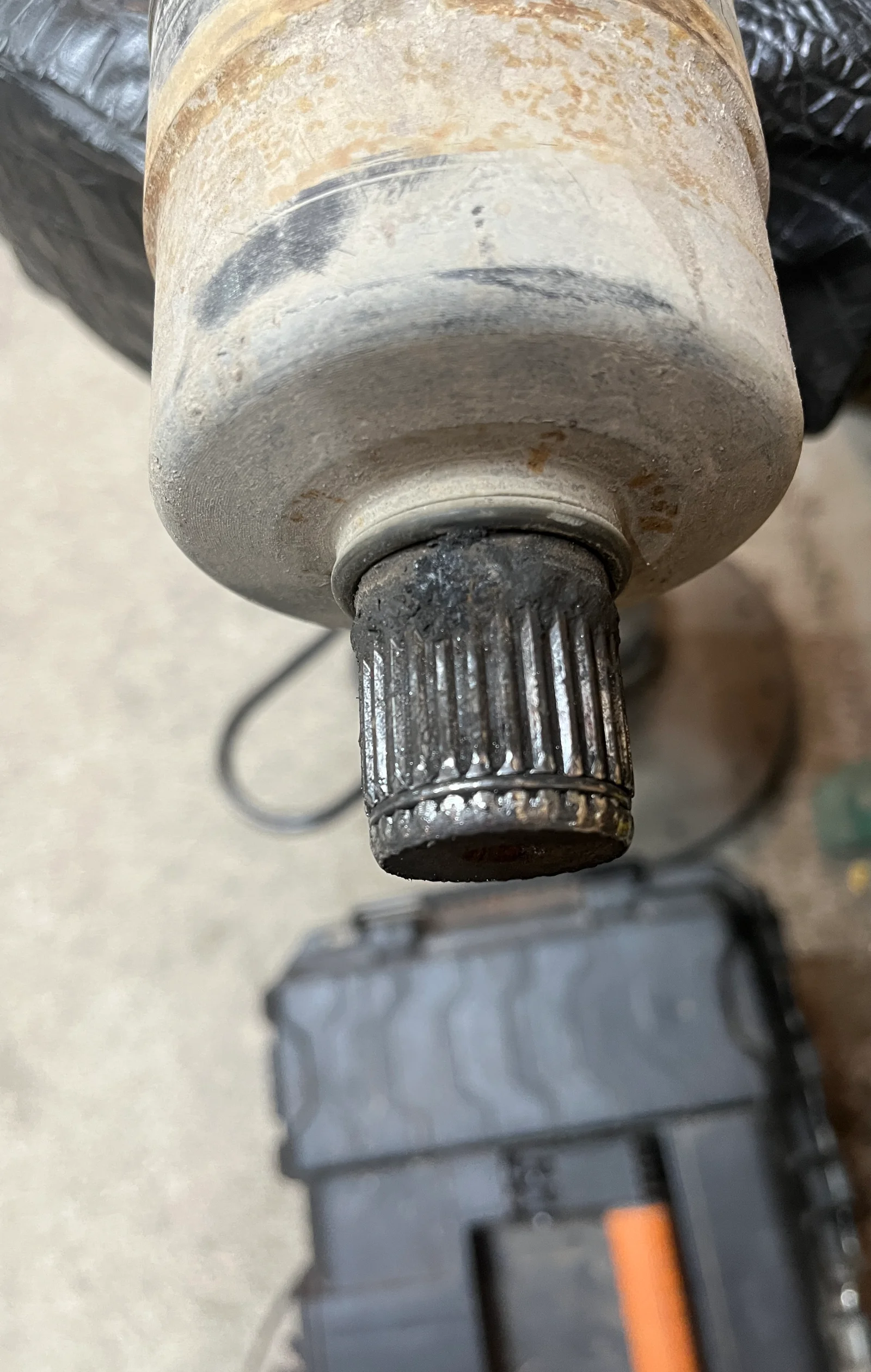

Went for a ride last weekend, seemed everything was okay on the ride. But was unloading it today to work on it. Switched it into turf mode, and it didn’t move off the trailer. Got out to look at everything, seen that the axle popped out of the diff. Popped it back in and drove it off the trailer and parked it. Question for you all, has this happened to anyone on the trail. And did it do any damage.

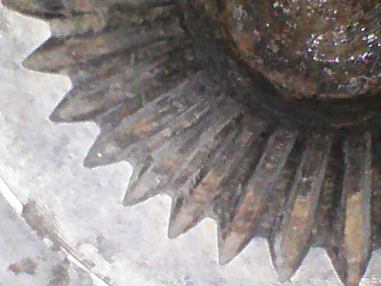

My rear driver side popped out last week with no abusive driving, messed up the driveshaft splines but did no damage to interior splines of differential, only noticed when I tried to move it in turf mode, but still BS after only 1020 miles. Replaced with Rhino 2.0 from SuperATV, luckily it slid right in.

That’s what mine looked like as well. Nice having the extended warranty. Dealer replaced mine when I took it into have a service done. Just hade the front diff rebuilt, and after the rebuild the front passenger side pooped out, after only 20 miles so going back to dealership to make sure nothing got damaged
