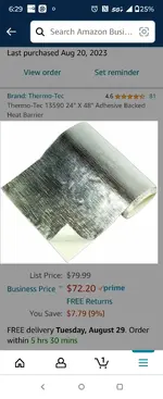

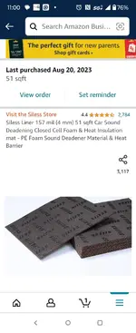

UPDATE on our XP5 heat and sound issues: I insulated the firewall with Thermo-Tec 13590 on the outside towards the engine bay. I removed the seat back from the rear seat and the thin pad that Polaris put there and installed Siless 4mm liner. Then reinstalled the Polaris liner. We took it for another test drive at 102 degrees. AC is still the same. I am going to check the freon tomorrow if my gauges will fit (I assume it's regular automotive fittings) and I have the correct type of freon. The heat from the back wall is better. Now it only shows 100 degrees so those two layers that I added dropped it 25 degrees. I might add another layer of Siless on those areas that are really hot. As far as noise goes it's definitely better. At up to 40 mph (6k rpm) it's tolerable. Get it to 7k rpm and it's annoying loud. The sound is definitely coming from the engine not the intakes. GF sit in the back and the sound was from directly behind her.
I felt of the tunnel and it's warm so when I remove it to check the hoop over the driveshaft I am going to wrap the coolant lines and line the tunnel like I did my Turbo R.
If you are on the fence about spending the time to do this I say it's worth it. Probably still not as quiet as the General was but better.
