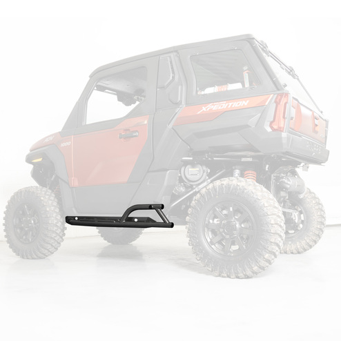

These are the Polaris HD Extreme Kick-Out Rock Sliders #2884497-458
Yeah I wasn’t thinking about that. I’m sure if you gave them a call they might make them available. I’m surprised they don’t already. I really do like them. They have a spot for non slip standing on them and also a step for getting in. Plate steel along the edge under the tube. Very rugged and so much better than the Polaris kickers. I’ve owned both.

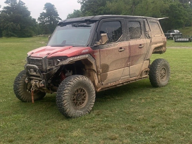

Any slider you can put on is one of the best upgrades you can do. I put mine on before the first ride. If had not done it. I would have Fd my doors and lower plastic.
100% agree. I did mine before pulling it off of the trailer for the first time. And about the 3rd ride in, it did it job.

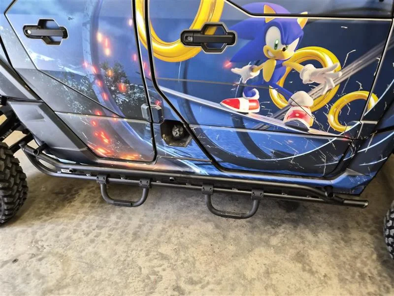

I used the RBO sliders because I wanted to have the SATV steps and they were the only ones I could figure out how to modify. Turned out pretty nice though....I used a radiator hose on the inside of the SATV step mounts( I think they are for 1.75 and the RBO is 1.5) but that works out great because on the trail i can just rotate them up out of the way. The RBO sliders worked out great the only minor issue i had was with the compression bolts. They weren't threaded cleanly from RBO and i had to run a tap through them....not a big deal but took an extra few minutes
