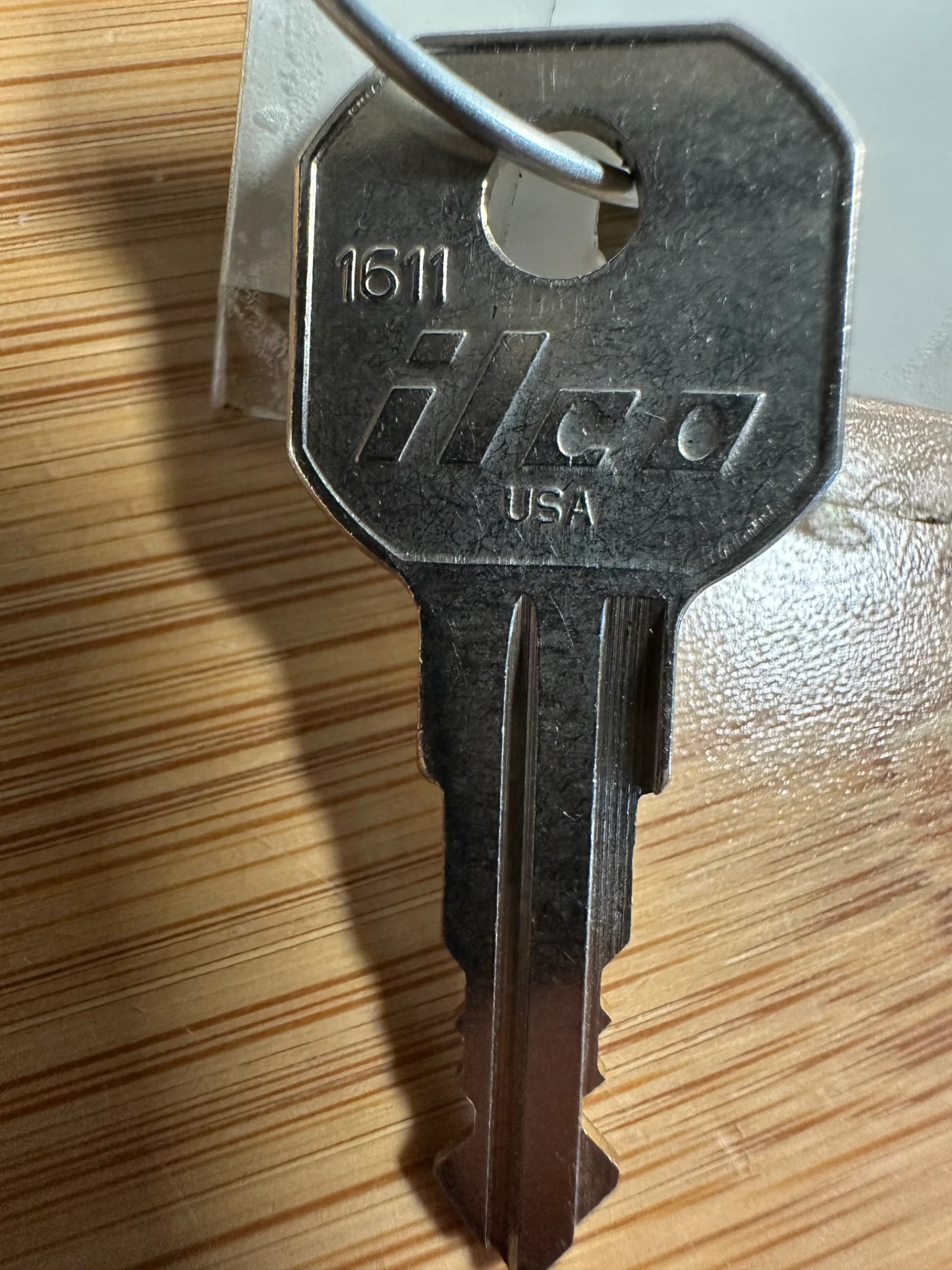

Key blank is a ILCO 1611 , my local hardware store had them in stock. Also check with your local RV shops for key blanks R008 as many RV's use a Southco brand lock , same brand Polaris uses for the Xpedition. locks
Not so, I have a local key shop & he has tried ordering several key blanks over more then a month & no luck. I was able to find a replacement ignition key on etsy but that vendor also said no on the door or rear window key
ilco USA blank key 1611 is the only blank that work for the X door locks
