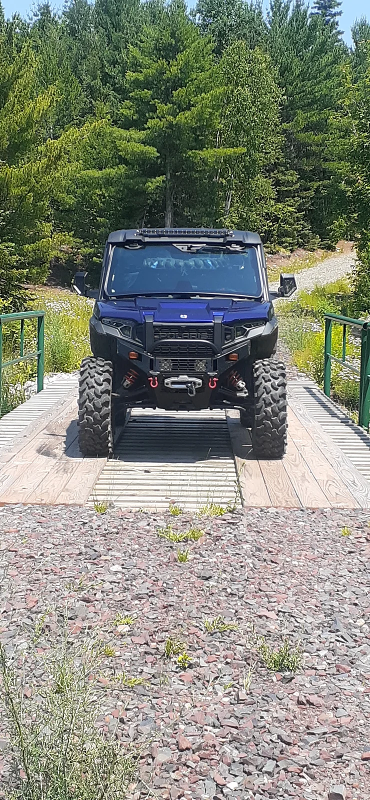

This is mine with the stock 4500# winch.
you don’t need to remove the winch at all to install the HD bumper. Just move a couple wire clips. The HD bumper comes with 2 different cover plates to cover whichever winch spot doesn’t get used.
If you do go with the 6000# high mount winch you have to replace the winch wiring and controller, which all come with the 6000# winch. The 6000# winch also comes with a wireless remote and controller. If you want to stay with the 4500# winch but want the wireless remote you can buy the controller and remote separately from Polaris for around $135 US

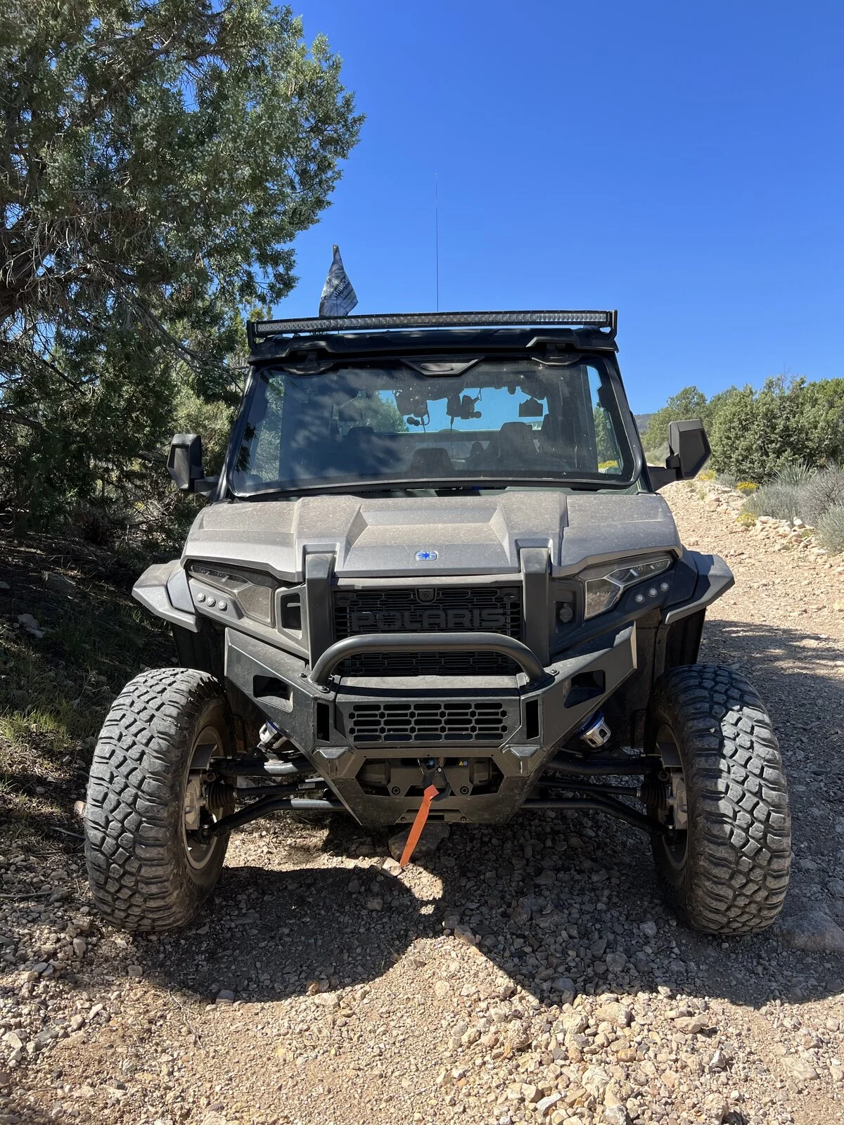

100%, I did wish they had a plate to clean up the holes around the opening. I guess the bumper is meant to run the winch at the higher location and be exposed but it works fine in the stock location. Either way, no issues here.

So what are the rectangle holes on each side for? I didn’t notice them at first. Any useful purpose?
