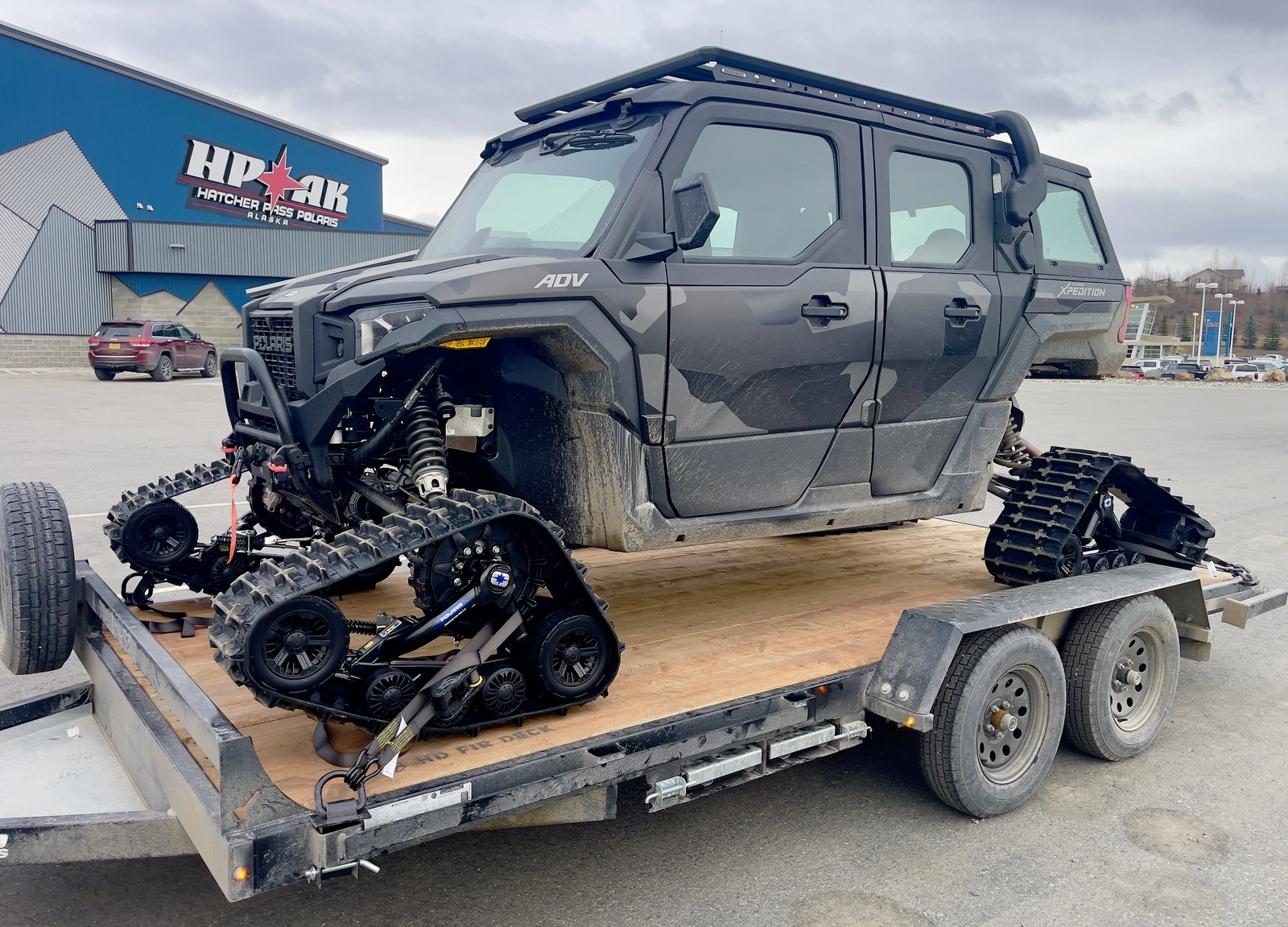

What's the story with the switch? I had my machine throw an error, but it stopped and I haven't seen it in more than 8 hrs of operation.
Also...
I couldn't leave mine along either...<grin> You can't see the antennas, but I added a Midland GMRS radio and a Starlink Mini onto the rack. RAM cupholder mounts for my iPhone and Garmin gps/sat comm and a gun rack. Done for now.

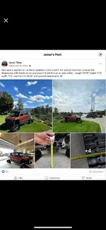

Do you have the dimensions (width/length) with the tracks installed?
