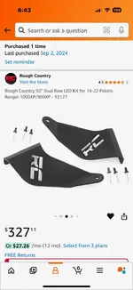

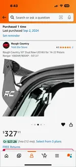

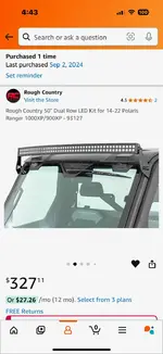

So I installed this light bar on thanksgiving vacation. Not a bad install. I added some sound deadening to the ceiling while I had the roof cover off. You have to cut the connectors that feed up through the roll cage because they are just too big to fit through the holes. I added the rough country wireless remote because the switch that rough country sends is kind of janky. So I have the remote velcroed to my dash. with a hit of a button I can turn off and on. It was about a 4 hour install.

I had to cut the connectors off the Polaris Rigid light bar harness to fit up the A-pillar, no way they were going to fit.
Did you go with the black or spectrum series light bar?
Black series. part number 93127 on amazon. It came with the right brackets. Don't use the pop rivets they send with it to mount the brackets on the frame. One fell off while riding. I put tek 5 screws in it and it is sturdy.
I drilled my brackets out to 1/4” and put in heavy duty rivets for mine. Stock set can’t Hold the weight for long.
