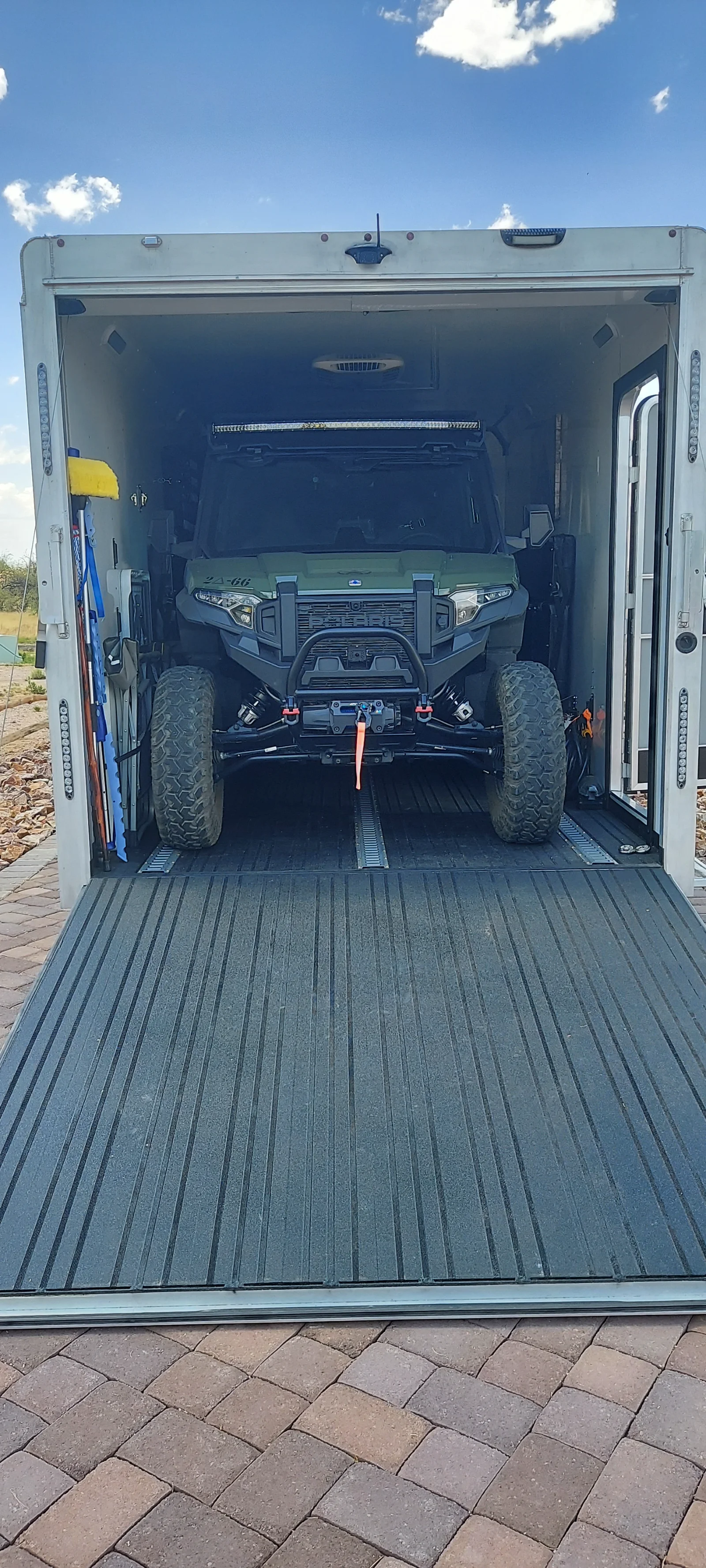

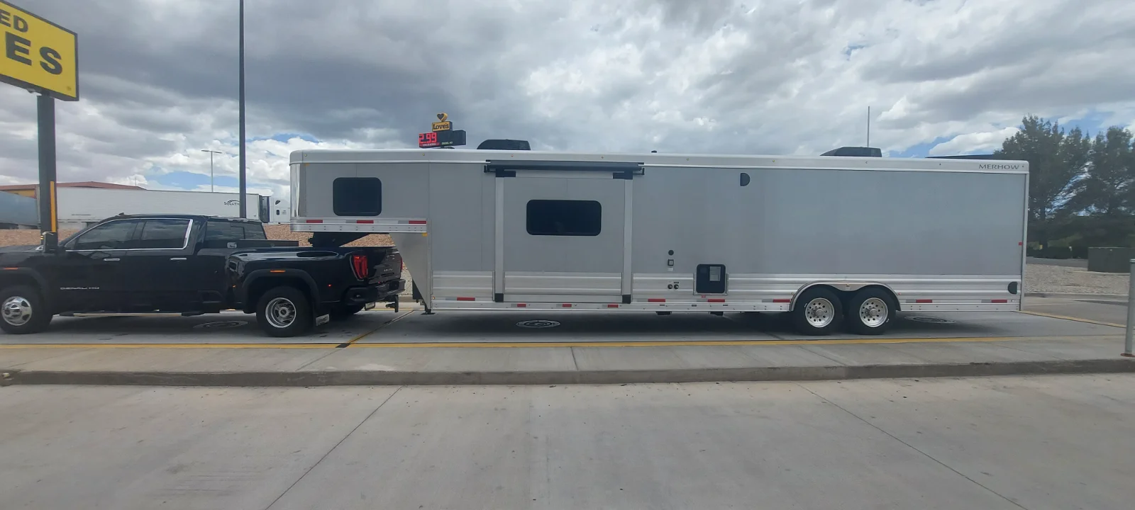

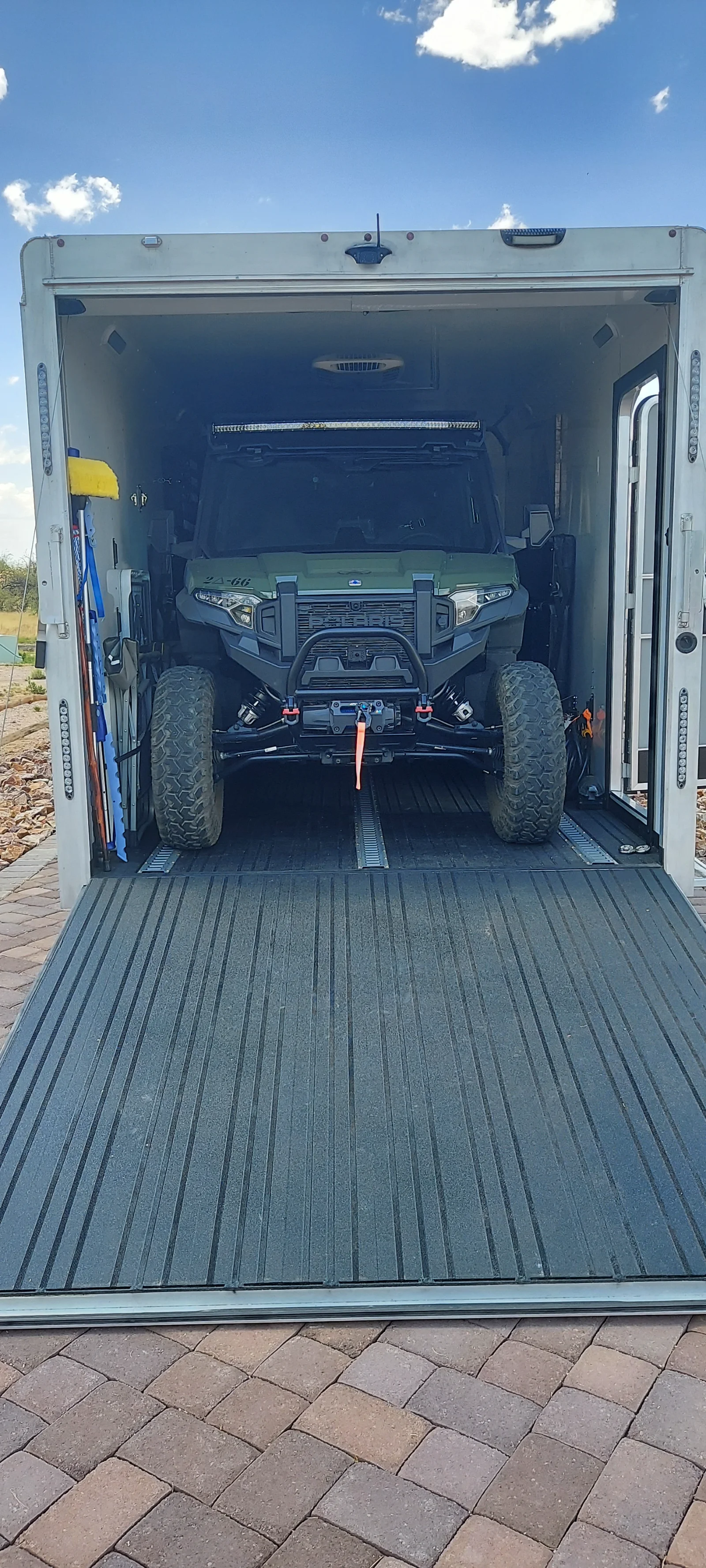

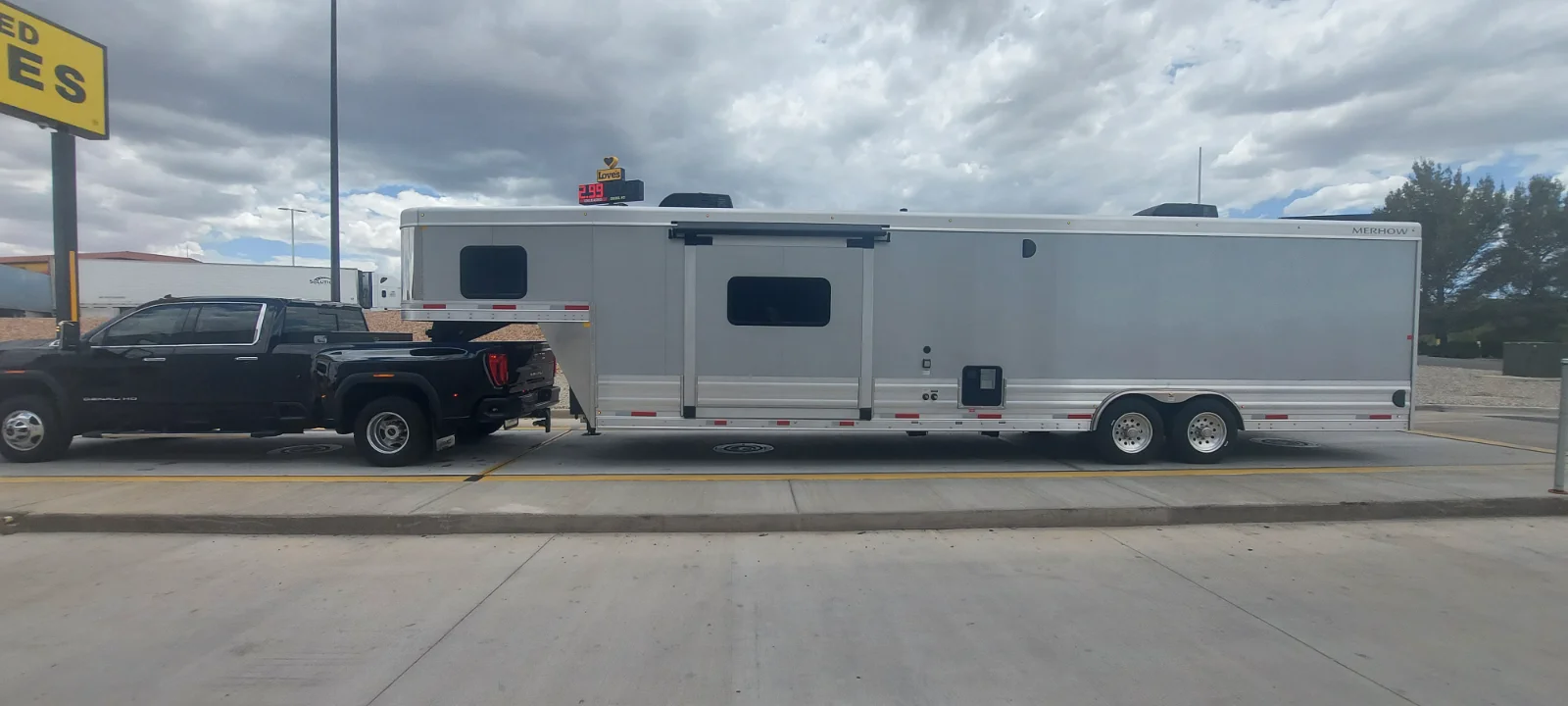

Or! You can dump the whole idea of the conventional everyday RV toy hauler and buy something that is built like a brick shit house.
Merhow, a company that has been a leader in horse trailers for almost 75 yrs builds toyhaulers with custom living quarters that isn't thin particle board with glued wood look a like paper. The entire living quarters is soild wood. Additionally, the roof is one seamless piece of aluminum. I built mine with a 16 foot garage. I have no issues getting my XP5 in or out with 32 inch tires.
A horse couldn't kick through these walls!
A horse couldn't kick through these walls! View attachment 5995View attachment 5996View attachment 5997View attachment 5998View attachment 5999View attachment 6007
That's a lot of trailer!
