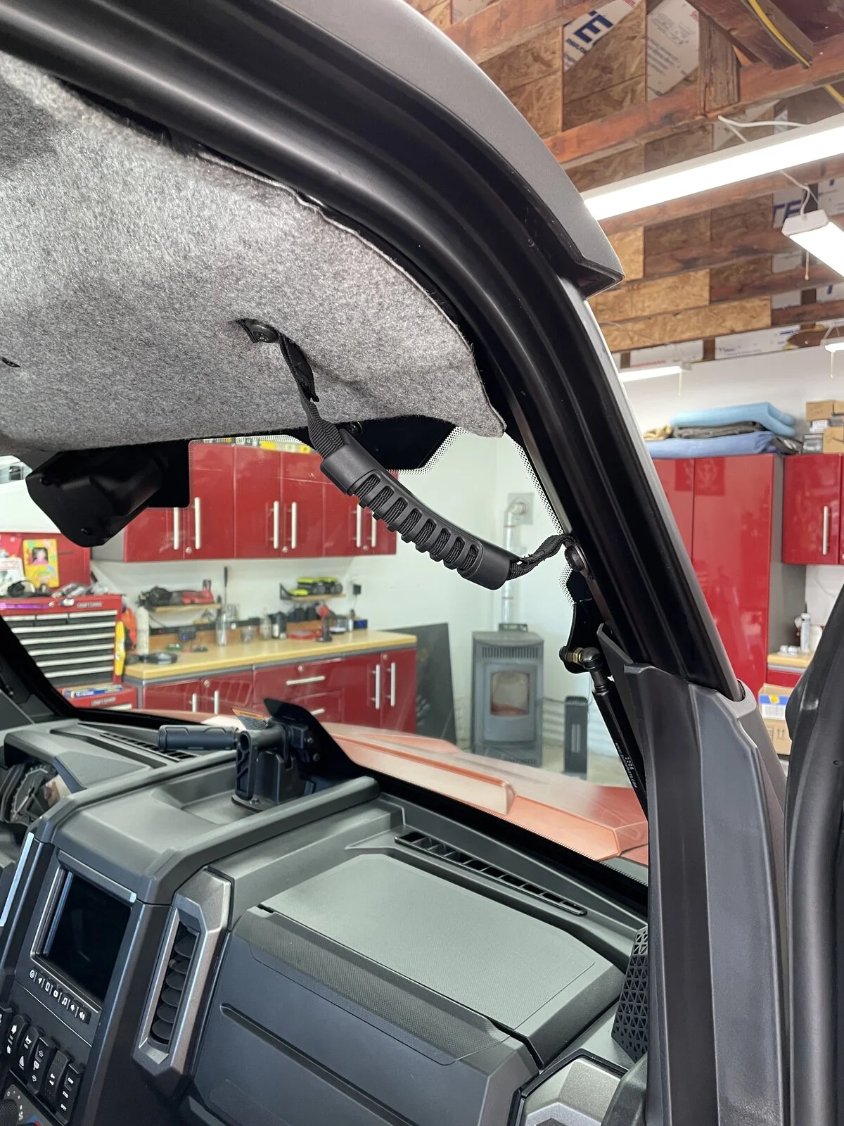

Hello, I picked up a pack of 2 kayak grab handles and put them in quickly. So 9 bucks and a couple screws. Didn't even have to tap the window frame existing hoke! Hope this helps. My wife loves em to help get in..

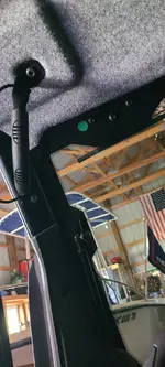

I made my own from round tubing and angle. Attached it to the roll bar with 1/4-20 nut certs and 1/4-20 x 1/2" bolts.
