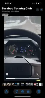

I also took videos of my xp going into limp mode. I noticed a green light flashing. Can anyone tell me what that light is? I have an aftermarket signal kit installed but I know that during my acceleration tests the blinker signal was not on.
Photo showing green light

Mine would go into limp mode the same way. I found that I could feather the throttle and make it go away. Eventually found that I had a leaking crank seal blowing oil all over the primary and belt. Didn’t know that was the cause until I got it fixed and it never came back.
