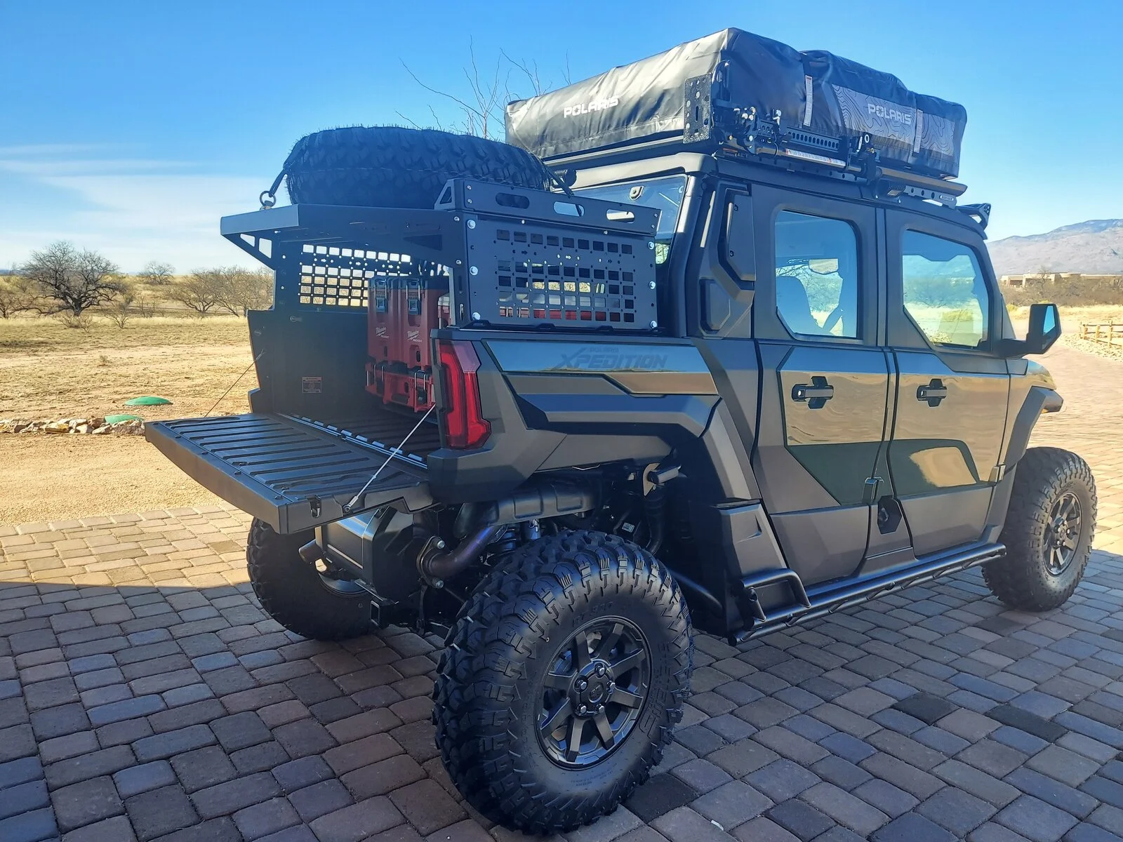

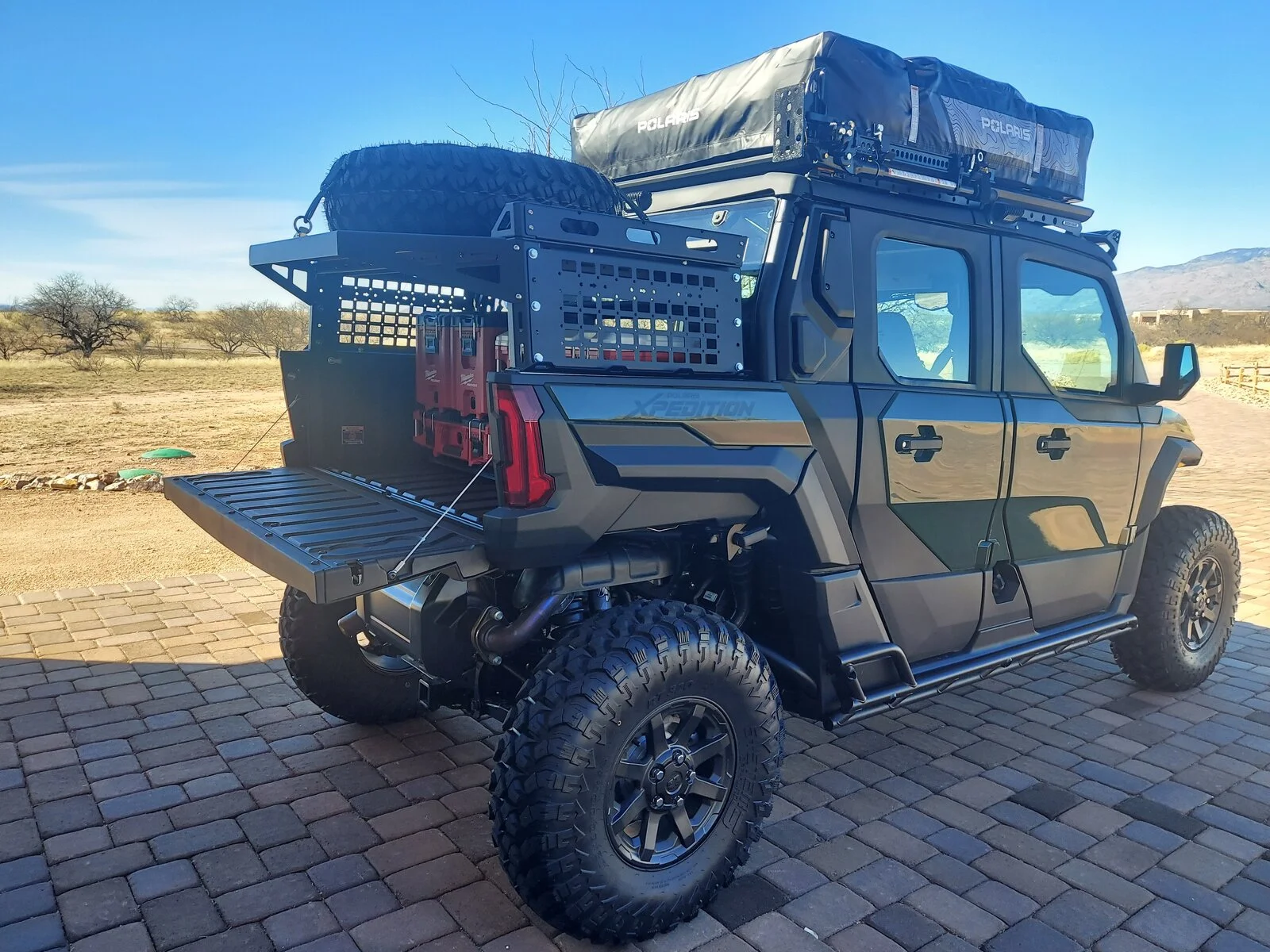

You are getting awful top heavy between the rack, tent and spare tire. Are you still the standard width? When Polaris came out with these machines and took all of the social influencers out in the desert, somebody carrying a tent on top turned theirs over.
I turned my General over once and don't want to do that to my Xpedition. I installed 5+2 rims to make me 68" wide for more stability. I also carry Packouts. 2 in the back as well as two coolers. The heavy tools and equipment are in two more packouts mounted to the floorboard between the seats to keep the weight down low.
Instead of carrying a spare and being even more top heavy I carry lots of plugs, a Glue Tread repair kit, a couple Sidewall slugs and an air compressor as well as a piece of rubber to make a boot if necessary. Gonna carry an inner tube once I find the right one as well. Having beadlocks, I could take my impact and stick a tube inside fairly quickly.
I turned my General over once and don't want to do that to my Xpedition. I installed 5+2 rims to make me 68" wide for more stability. I also carry Packouts. 2 in the back as well as two coolers. The heavy tools and equipment are in two more packouts mounted to the floorboard between the seats to keep the weight down low.!
Hello Johndeerefarmer
Thank you for your input! The rack, from "SDR Mortorsports" is a surprisingly light, powder coated aircraft aluminum. So the only real weight is the spare (I'm guessing 35-40 Lbs.) and the Hi Lift Jack which is less than 30 Lbs. Based on your input, I have raised a concerning eyebrow to my plans of adding jerry cans for water and fuel on each side of the spare. (This will need additional research on my part).
To answer your question, I did install the larger 32" tires and 1 inch spacers, giving me a 68" width. Love your idea of the plugs and glue tread repair kit.
I have watched several "Influencers" on YouTube (like "LOJO") that were actually invited by Polaris to participate in the launching of the new Xpedition. He is an angler, hunter and camper who indicated in his video that he doesn't consider himself an "ATV Guy", but said it was a "once in a lifetime - unbelievable trip". Now, I was unaware that somebody may have turned theirs over. Which leads to the question of that particular influencer's experience with a side x side. My wife and I have owned several UTVs and a RZR 800 that we used to explored local mines and camped out in for years here in Arizona. Looking back, with the rack and equipment I carried then, it was probably not a wise idea. However, as I'm sure you know, a little common sense and trail riding experience go along way when it comes to safety. At our age, we are not out for speed of aggressive rock climbing.
Should you come across any additional information on top loading or events of roll overs involving the Xpedition, please shoot it may way, I would be very interested. And thanks for sharing, its always nice to receive others thoughts and perspectives.
Be safe!
Be safe!
I carry extra fuel in two Rotpaxs in the back of the bed. I don't have mounts. They are just tied to the tie down points.
Here is the girl that tipped it. She had no previous SXS experience. Having said that if you look at the pix she appears to be on level ground?: First Look: Polaris Xpedition ADV
I had a General before the Xpedition. It was only a 2 door and 65" wide. It was very tippy with nothing on the roof. Several times in Colorado going up and down some of the switchbacks that were banked on one side it would try to tip. So this time we got the 4 door for the longer wheelbase and made it 68" wide. We haven't been on any of those trails yet so I can't tell you how it compares. We got the roof rack and will use it to carry a kayak and camping supplies but will not leave any weight up there permanent.
