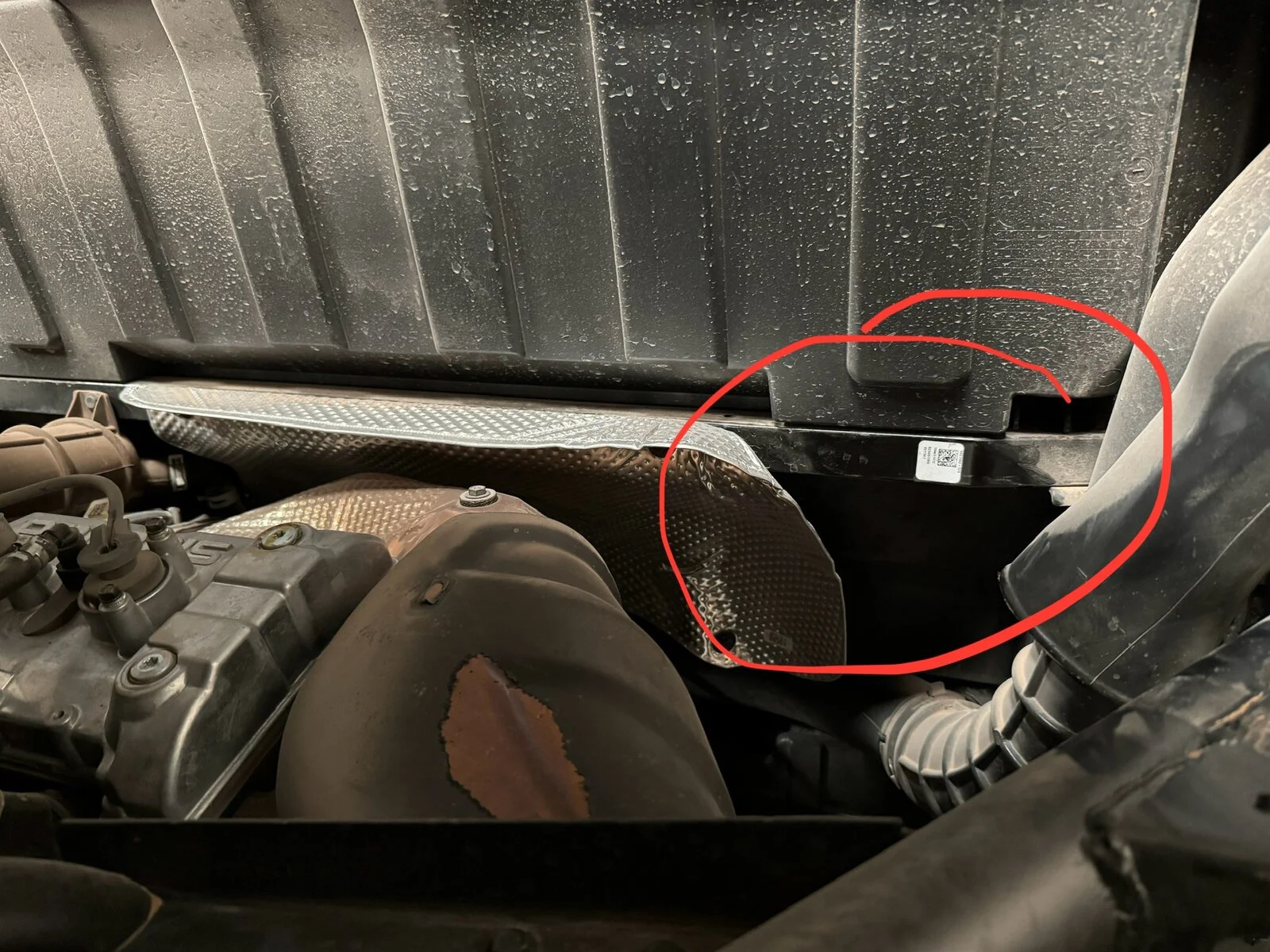

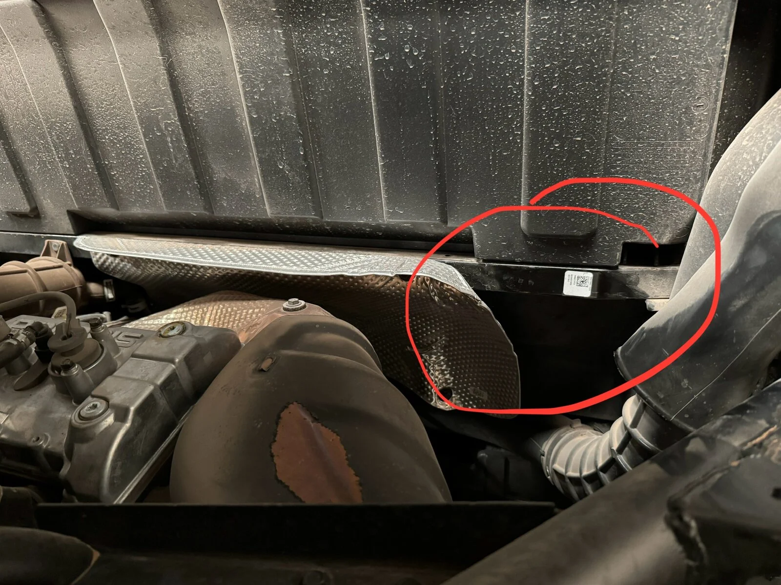

Probably on the metal crossbar under the back wall of the cab on the passenger side. Looks like it should be accessible even on the Northstars and away from the exhaust. A couple nutserts into the tube so I don’t have to drill through into the cab to bolt it on should work.
Probably on the metal crossbar under the back wall of the cab on the passenger side. Looks like it should be accessible even on the Northstars and away from the exhaust. A couple nutserts into the tube so I don’t have to drill through into the cab to bolt it on should work. View attachment 820
