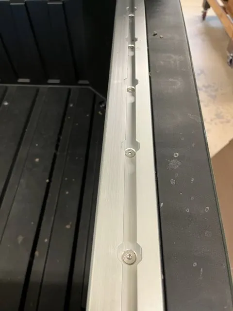

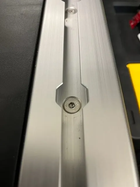

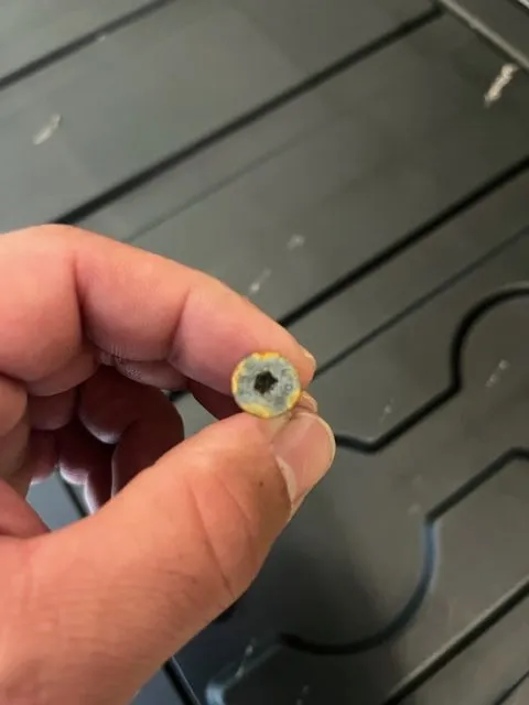

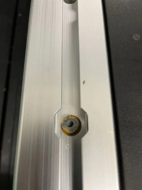

It's the little things that drives me nuts. For the price I'd expect a little better. These would've looked horrible over time so had to replace with SS.
Pun intended! Thanks for sharing - I agree, this should be a recall issue and they should send stainless steel to every owner and switch the factory line now!It's the little things that drives me nuts. For the price I'd expect a little better. These would've looked horrible over time so had to replace with SS.

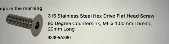

FYI - They used red thread lock. Most broke easily two were a challenge.well i placed my order with mcmaster and I too will be removing the factory screws
