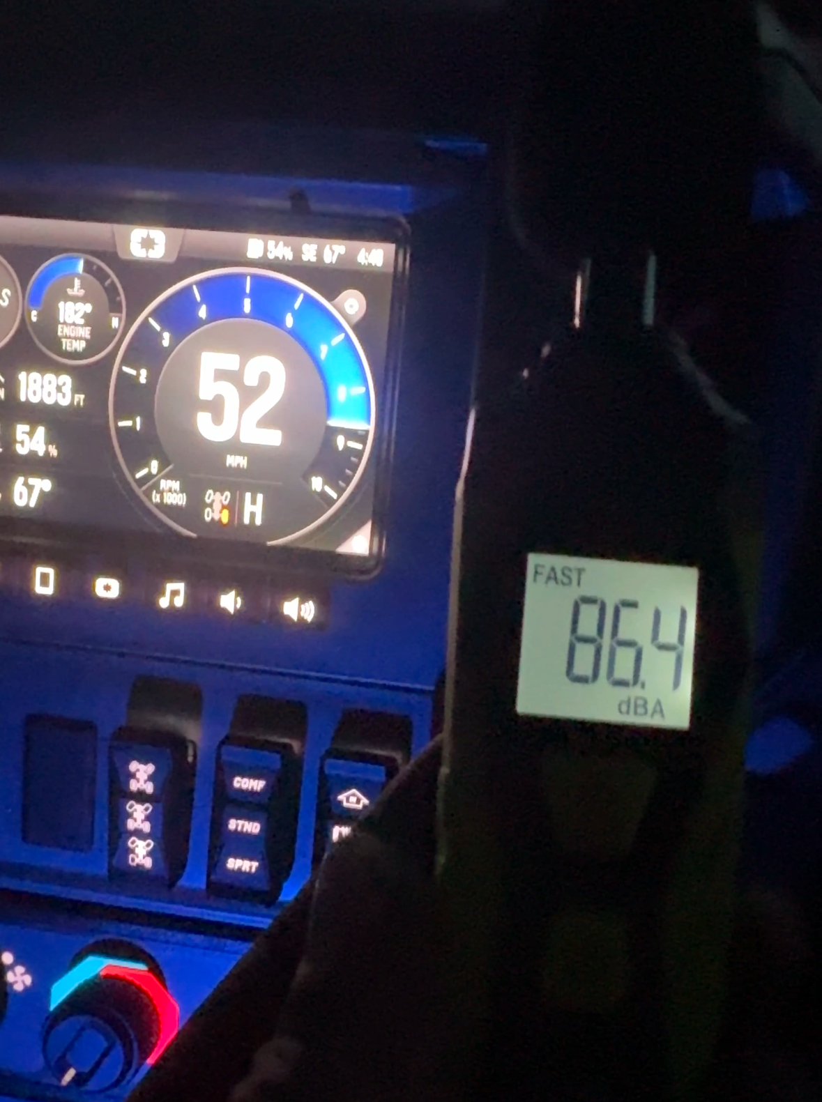

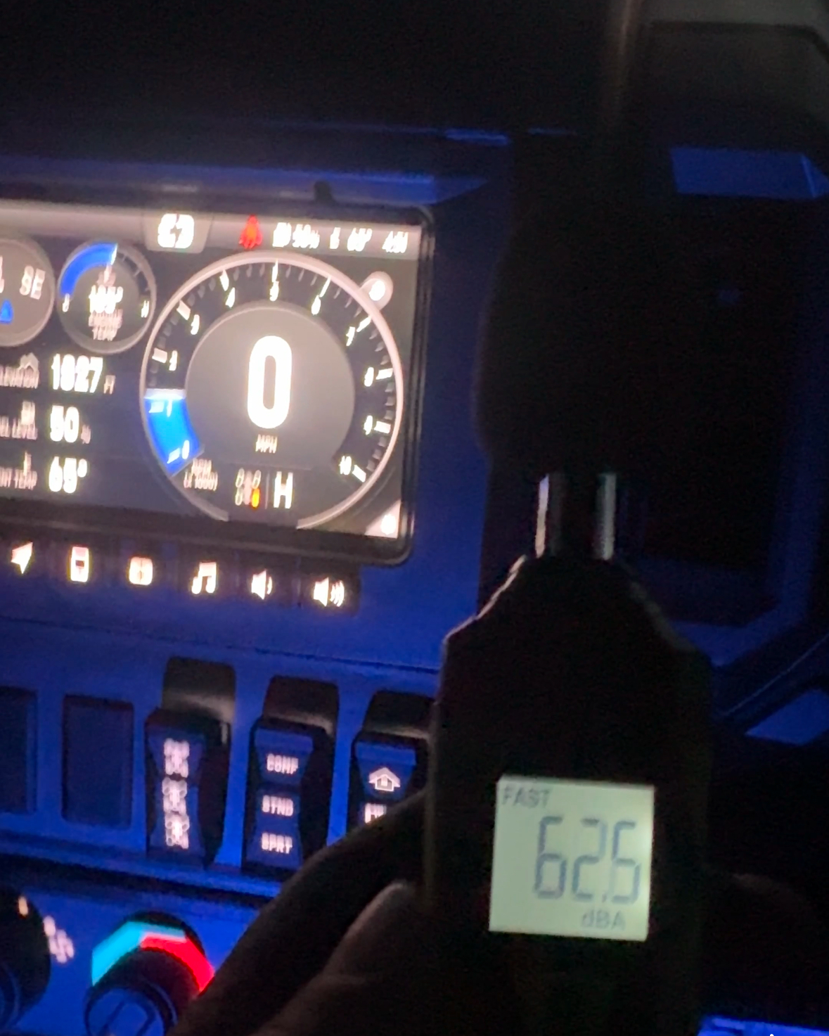

For all of you out there complaining about the Polaris comfort clutch, the inside cab noise, and lack of power, there is an awesome upgrade. Just reach out to JT Barlow on this website for more details. I had my Xpedition up there (Mesquite Nv.) for 1 week, and the work they did on my rig was an amazing difference. They have an upgrade called the "High Desert Package" which includes clutch, and tune from AA Assassins, sound deadening, poly fill all of the voids under the skid plate and added heat shield to affected areas. The sound deadening and poly fill alone dropped the sound level by 8-9 dBs, which is huge and is definitely noticeable. They also take the shocks off and add a schrader valve to all 4 shocks so you can check nitrogen pressure, and they set the correct ride height. Basically, what this upgrade does is wakes up the power of this motor and at the same time quiets it down quite a bit. I couldn't be any happier with the total results of this upgrade. If anyone is interested in the work High Desert Unlimited does, reach out to JT Barlow on this website for more details and pics of the work they did on my 2025 Xpedition ADV 5 Northstar.
