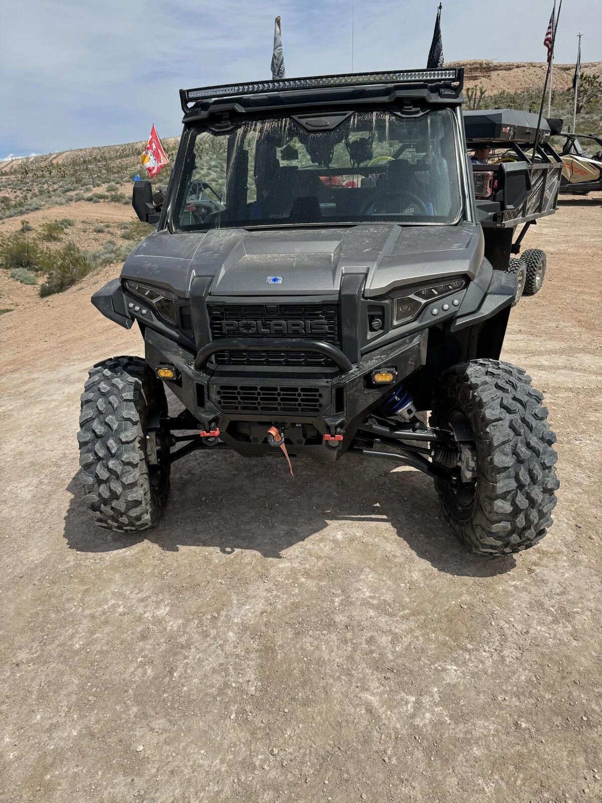

Lasfit 12” light bar , auxbeam 4” amber powered by an auxbean 6 gang switch panel. Not a big fan of tube clamps for the amber lights but they work until I weld tabs on…

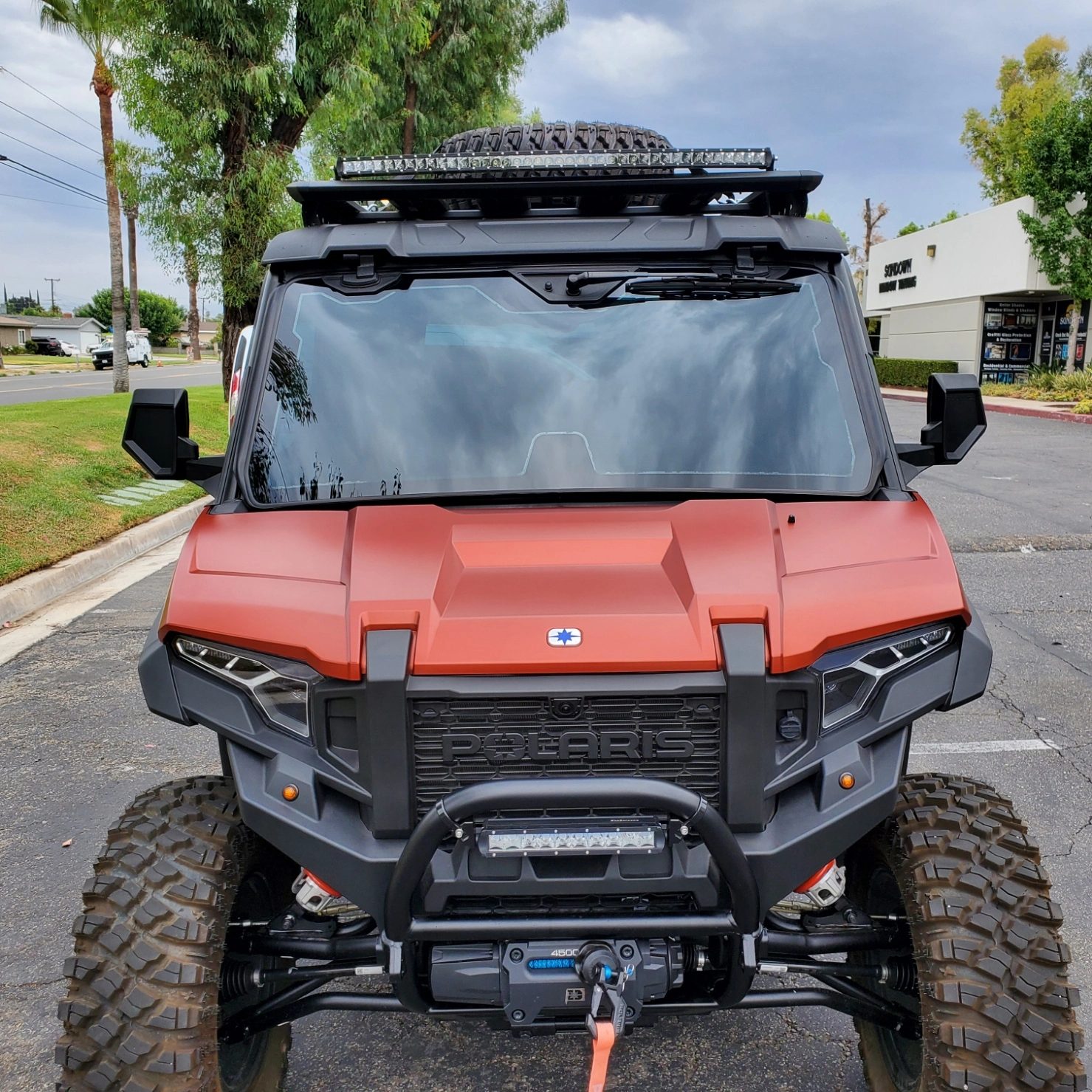

For the front bumper I put on an 11.5 inch single row attached to the top of the front bumper for stability. I also added 2 dome lights inside, one over the back seat and one over the cargo area that are LED and work great. There are existing mounts under the headliner for the additional dome lights.
The 41 inch top bar and the bumper are more than adequate for night riding here in the desert. I have spent a lot of money and overkill on my jeeps that was just not needed.

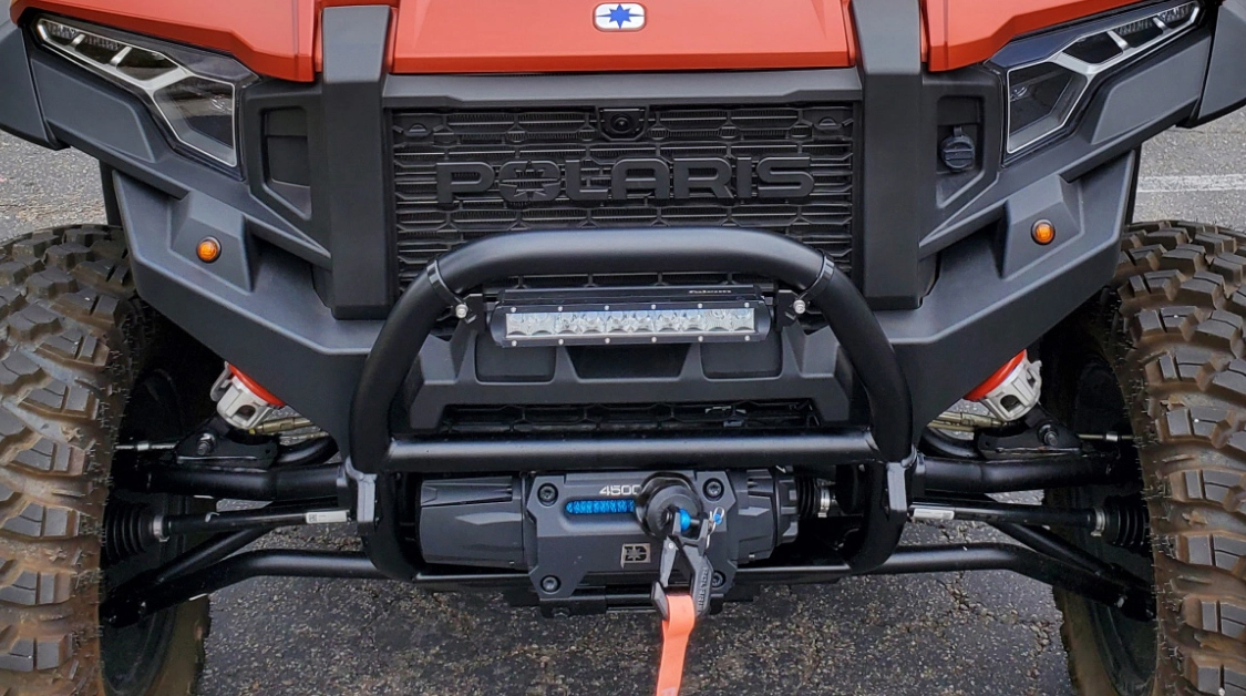

So what are you using to attach the light to the bar? Did you use the factory wire provided? If so was the wire inside long enough to put the switch at the center switch area?
I used a ring attachment I got through the dealer (picture below) that clamps on the bar with studs to attach the light bar.
I used a Polaris wiring harness from the bus to the switch.

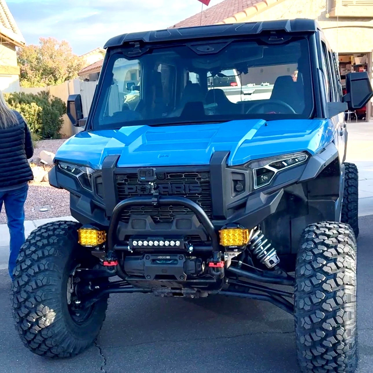

I did a similar installation but my single row light bar is operated by a remote switch so I can turn on both inside and outside of the cabin. After talking to my friend who drives off road racers he said to get the yellow lens lights which work best in the AZ dust, which I also added and they are fantastic.
