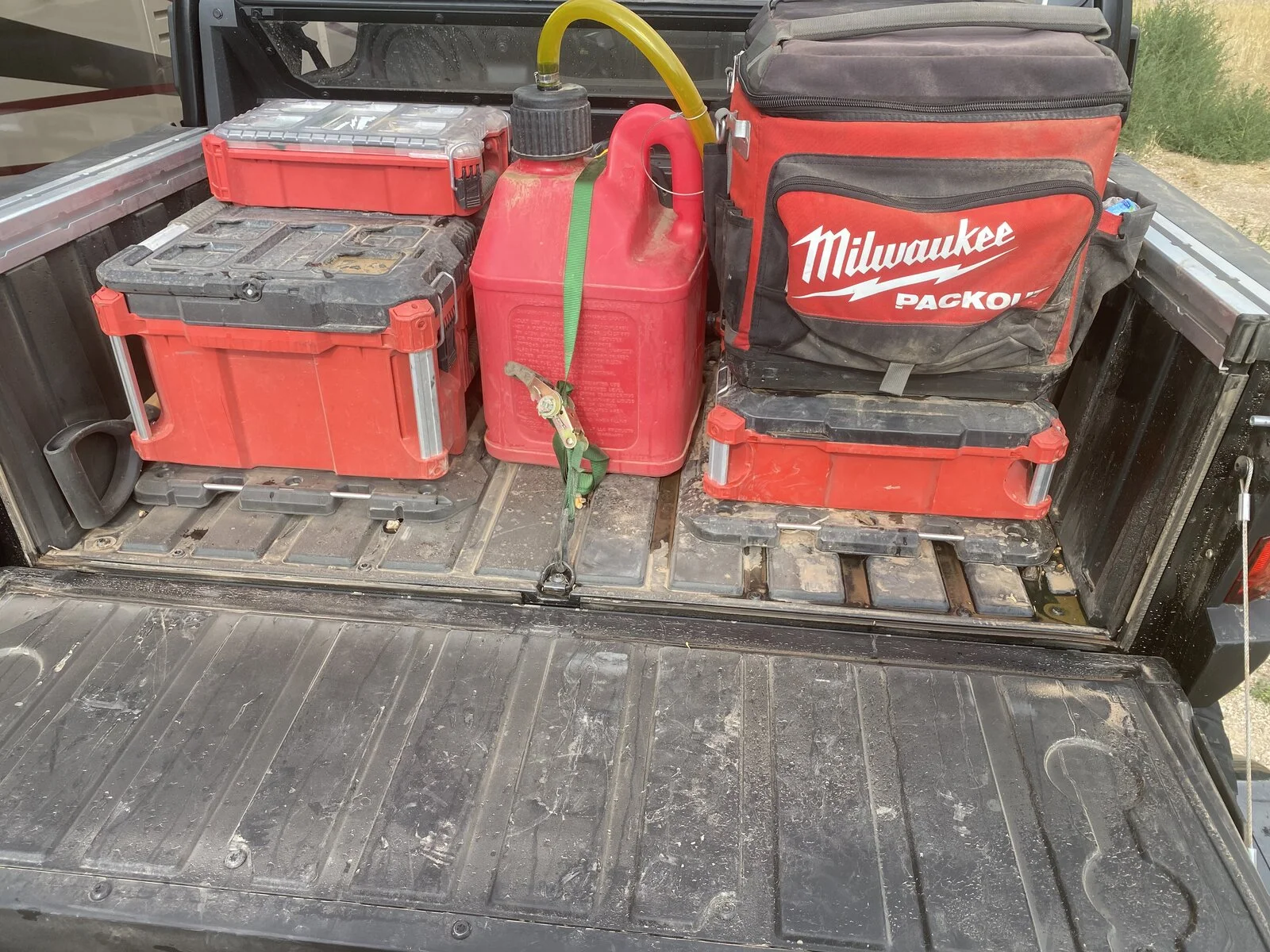

I mounted my Packout plates up against the sides. It left enough space between for two 6 gallon gas cans if I want. I usually only carry one though. Also, I moved 2 of the tie-down loops from the corner bolts to the center ones for the gas can ratchet strap.
Looks like. Good idea on moving the ring. I should do that as well to hold my DeWalt 8" pruning chainsaw in place.
